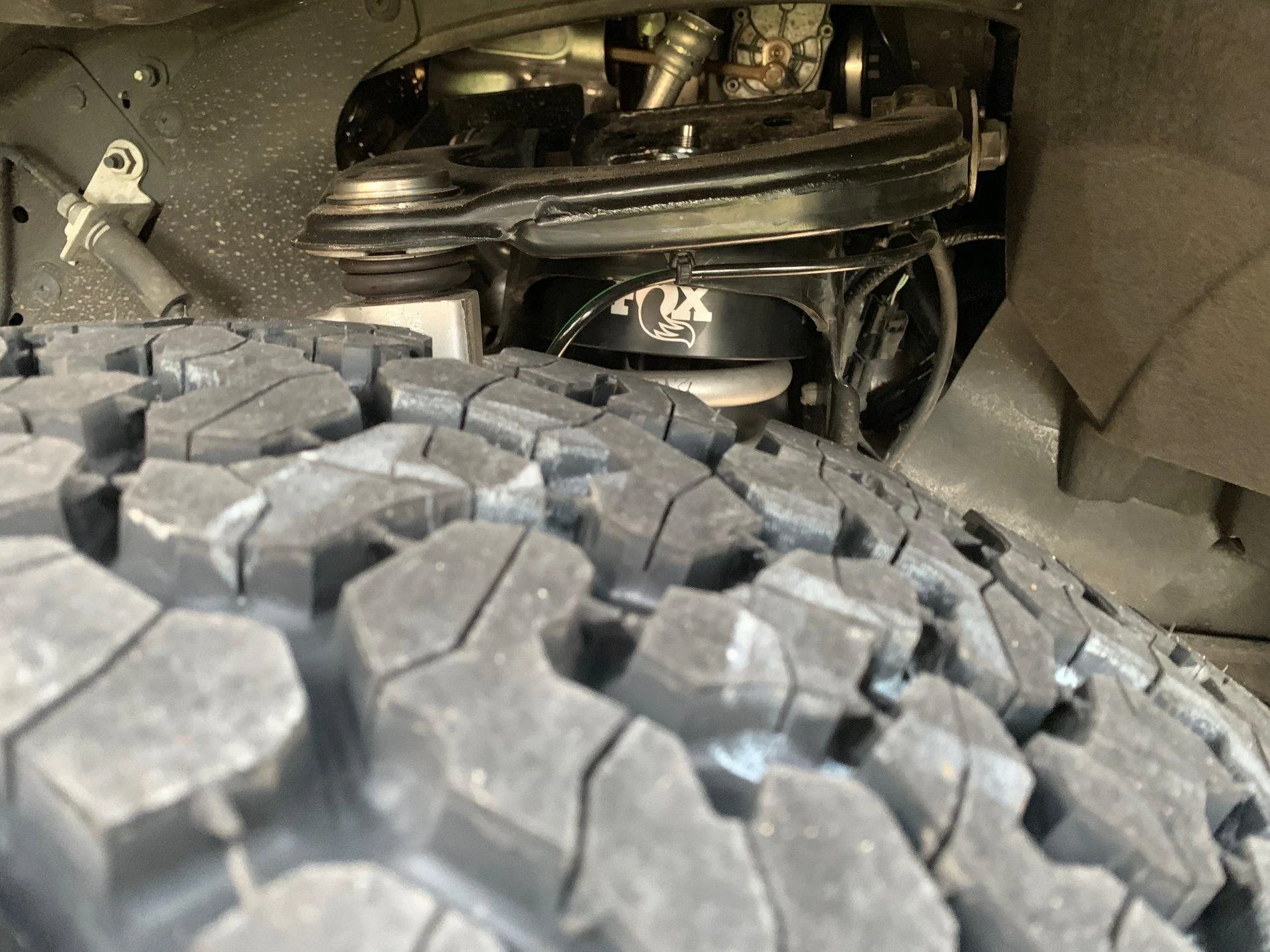

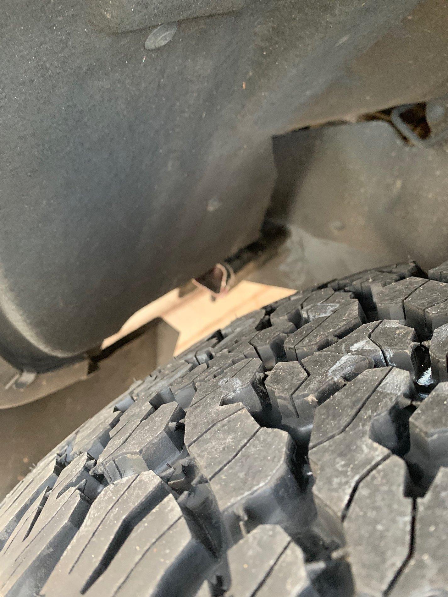

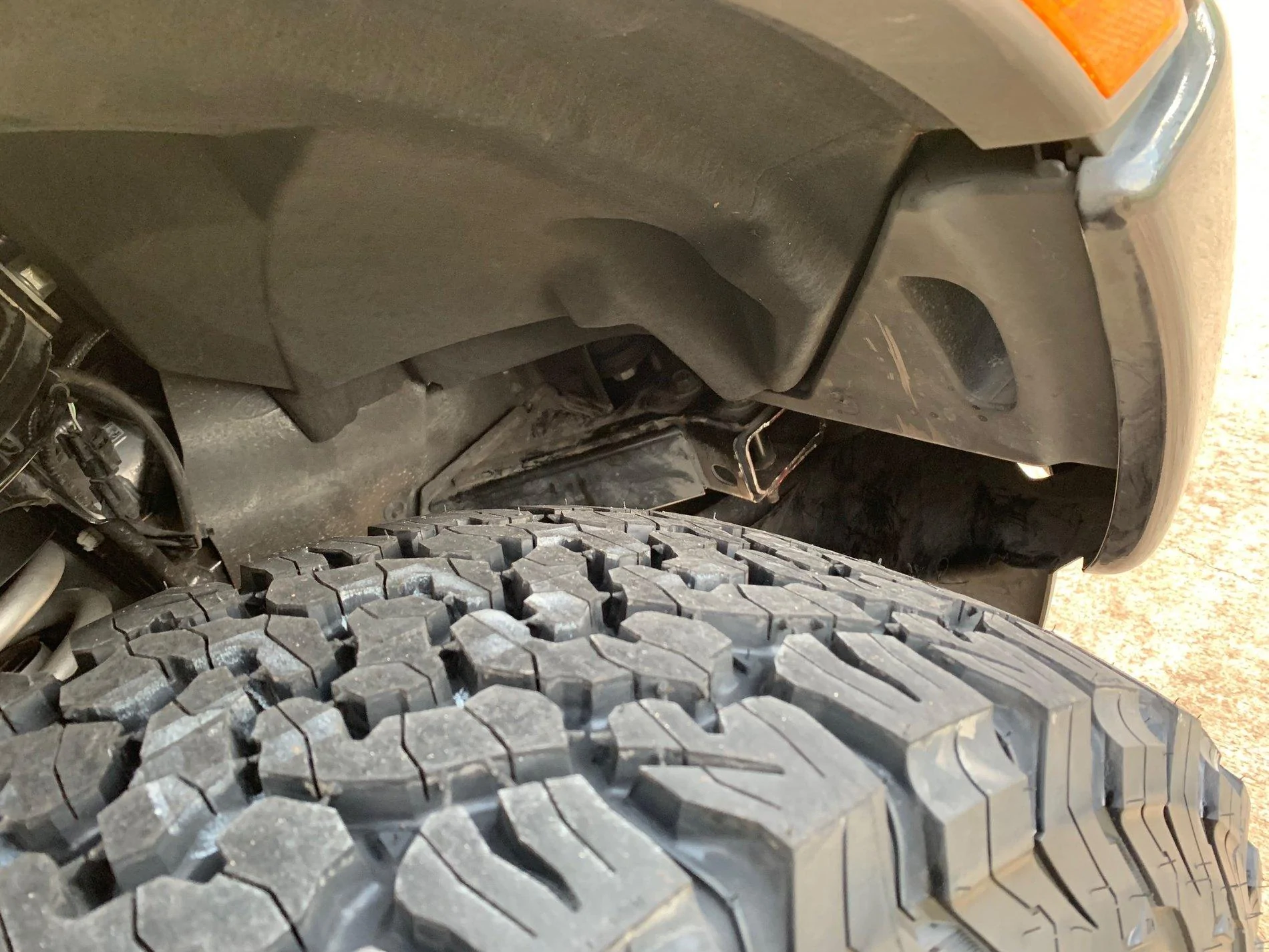

Just got done installing Fox 2.0 Kit, Front coilover and rear shocks. I am happy how it came out, It took me about 16 hours 2 days in total to complete, also had a lift to work from. Popped out the cv joint three times. Will be ordering new cv joint and axle nut and all the nylocks just to have a peace of mind if I have to change them out again. Tires are KO2 with Icon Rims. Comes out to about 32.7 for those wondering @ 285/70 17. No way tires would turn without the crash bar hitting so I had to cut them in place, that was fun and took a long time. I do have the Fabtech Crash Bars in my garage, just haven't installed them yet. I went through 16 Sawzall blades lol and one cut off wheel. Finally ended up using the diablo blades and those work pretty good an feel solid. The alignment feels straight even without an alignment, I'll have it in the shop once I get some time for the alignment. I really like the stance and how it came out.

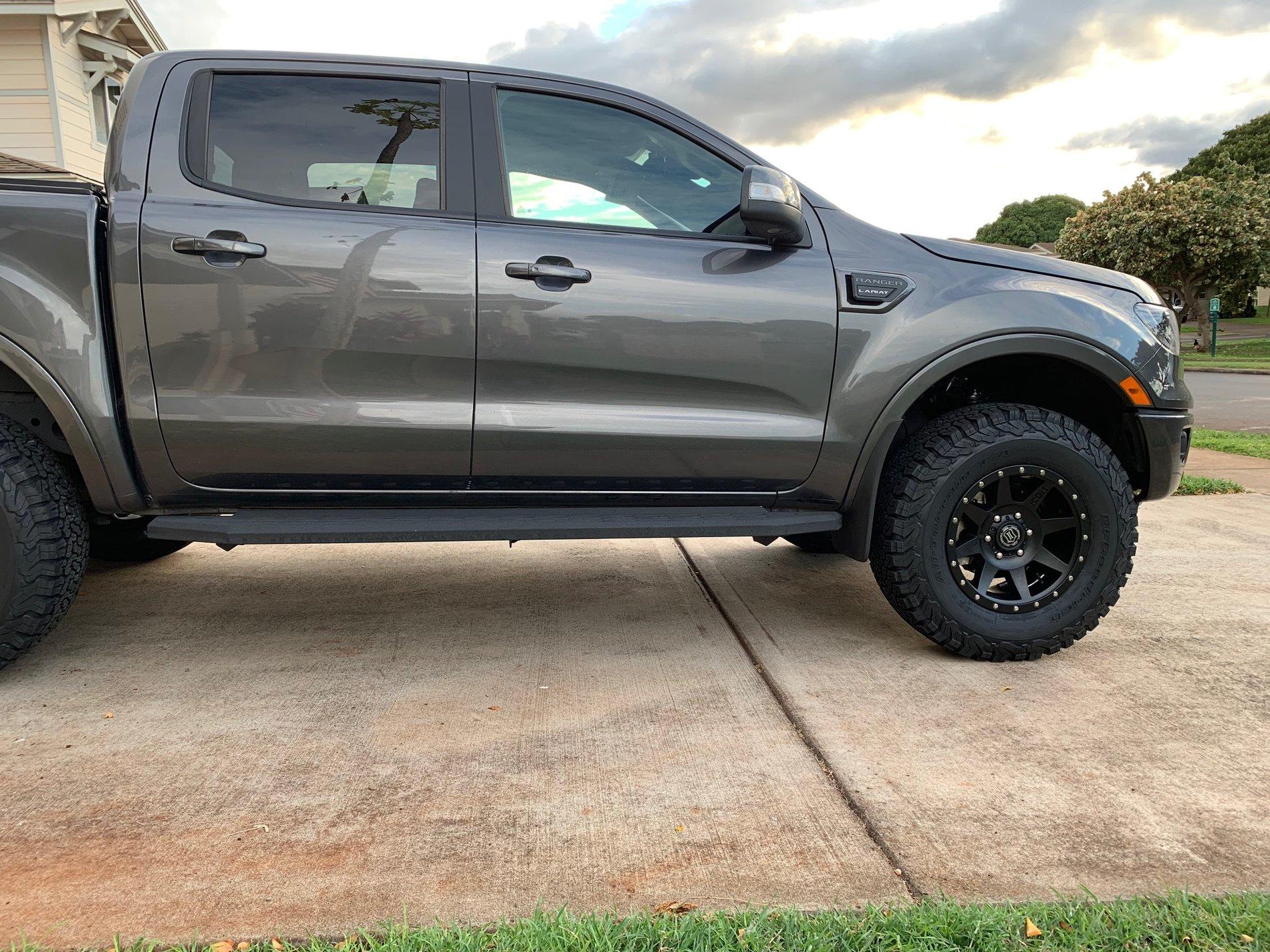

That looks good! What are the specs on the wheels?

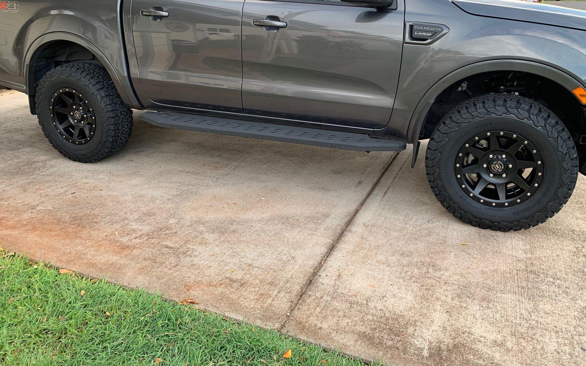

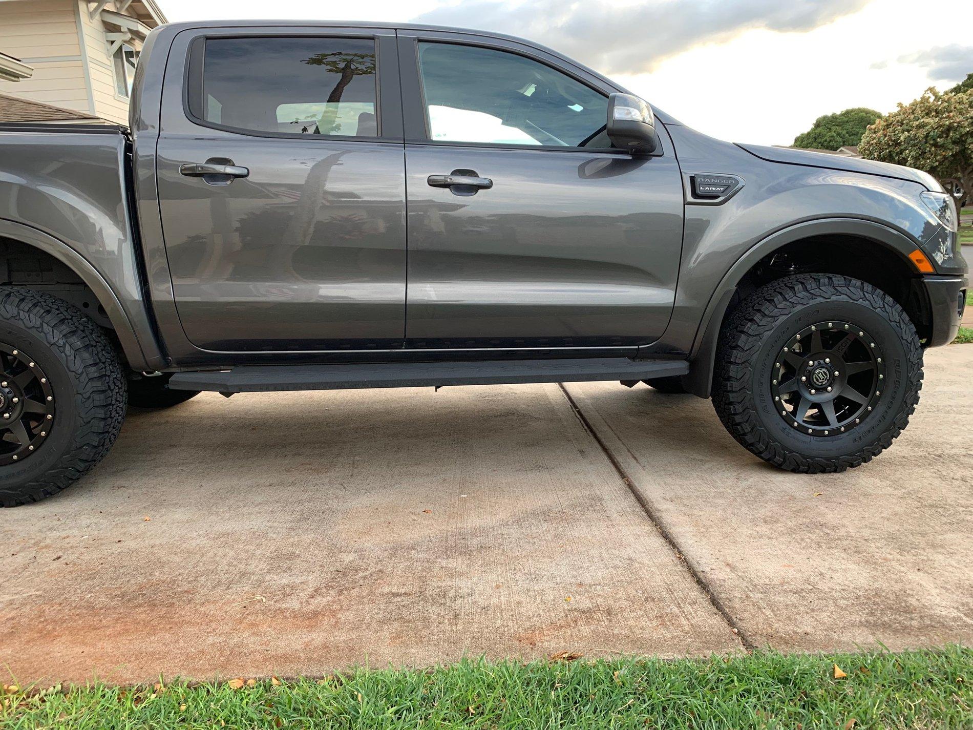

Thanks @FULLSCALE , they’re size 17x8.5” with a bolt pattern of 6x139.7 mm and 5.75" backspace, the offset is 25mm and hub bore is 108.1mm. Even with the crash bars deleted they’re probably a half inch to inch away from the liner at full turn.

Thanks! I like how they are just barely out past the fenders and bedsides.

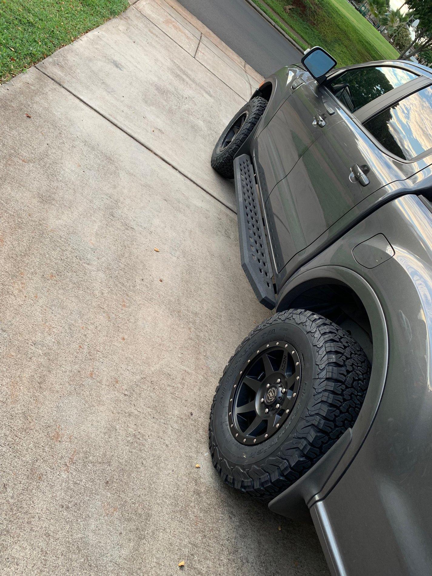

I’ll get a pic with a straightedge so you can see just how much they stick out, not much at all imo.
