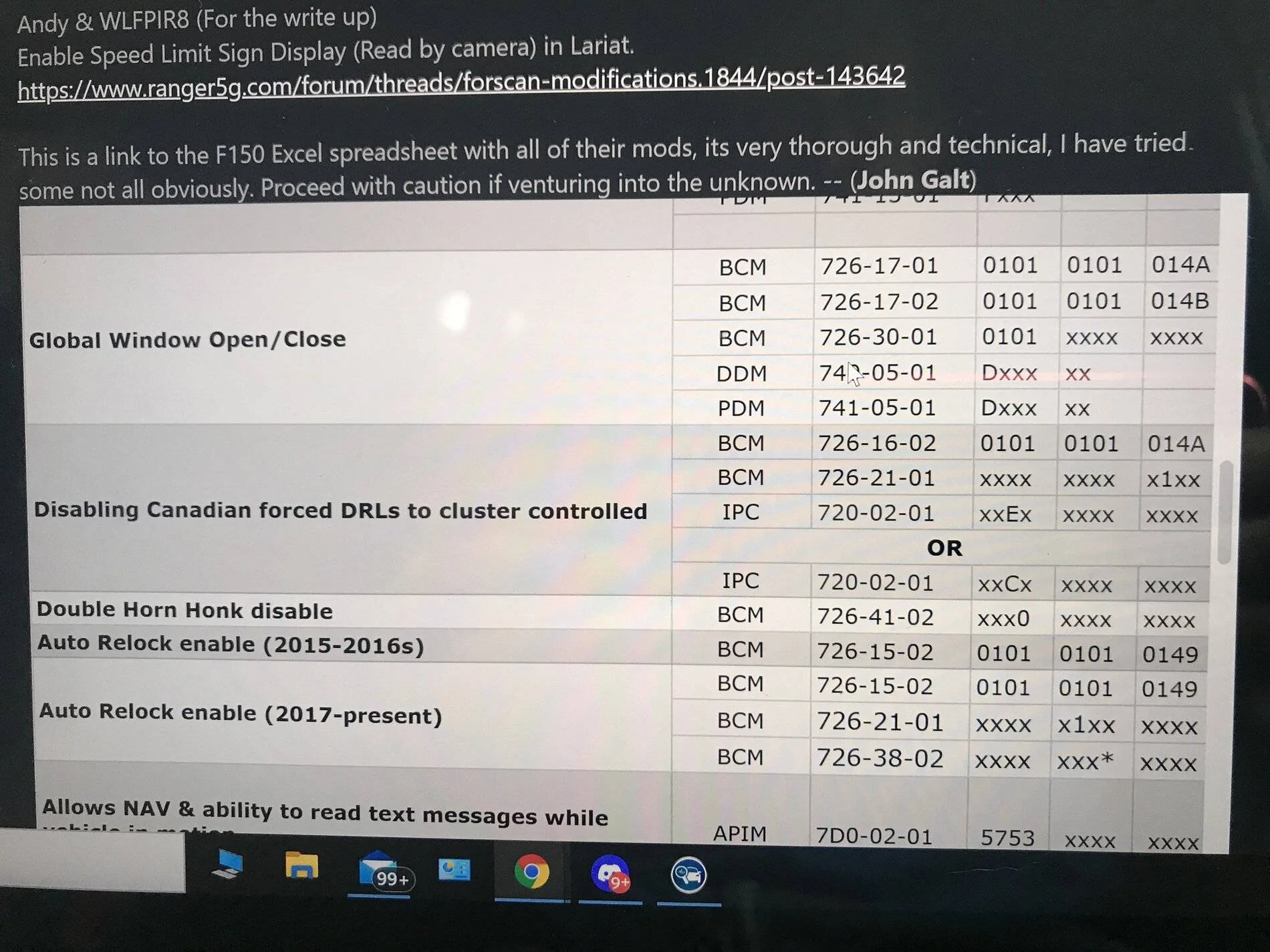

Andy & WLFPIR8 (For the write up)
Enable Speed Limit Sign Display (Read by camera) in Lariat.
https://www.ranger5g.com/forum/threads/forscan-modifications.1844/post-143642
This is a link to the F150 Excel spreadsheet with all of their mods, its very thorough and technical, I have tried some not all obviously. Proceed with caution if venturing into the unknown. -- (John Galt)

How does one change things in ForScan? I'm confused as to what I need to change exactly. How do I know what change? I see a code but not sure if that's what I'm supposed to enter or if I just modify one thing within that.
Things I want to change on the ranger:
--> Any and all dings related to car door, seatbelt, lights being switched on, ingnition on, keys in etc.
--> I want to change the splash screen, preferably to say "raptor"
--> adjust to my new tire size of 285/70/17 (BFG KO2) so my truck will read correct MPGs and Mileage.
--> Anything else fun and cool that you guys can think of!
Start here. Watch the video it will help you get started. Post #1 in this thread has a pretty good list of changes that can be made.
https://www.ranger5g.com/forum/threads/forscan-crowdsourced-wiki.2008/page-9#post-107109

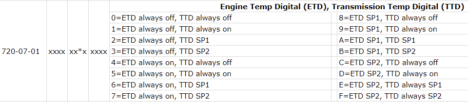

Has anyone attempted to enabled the digital engine temp and trans temp displays on an XLT cluster using the settings listed for the F-150?
The trans temp is confirmed to not work, pretty sure the engine temp was confirmed also non functional.
