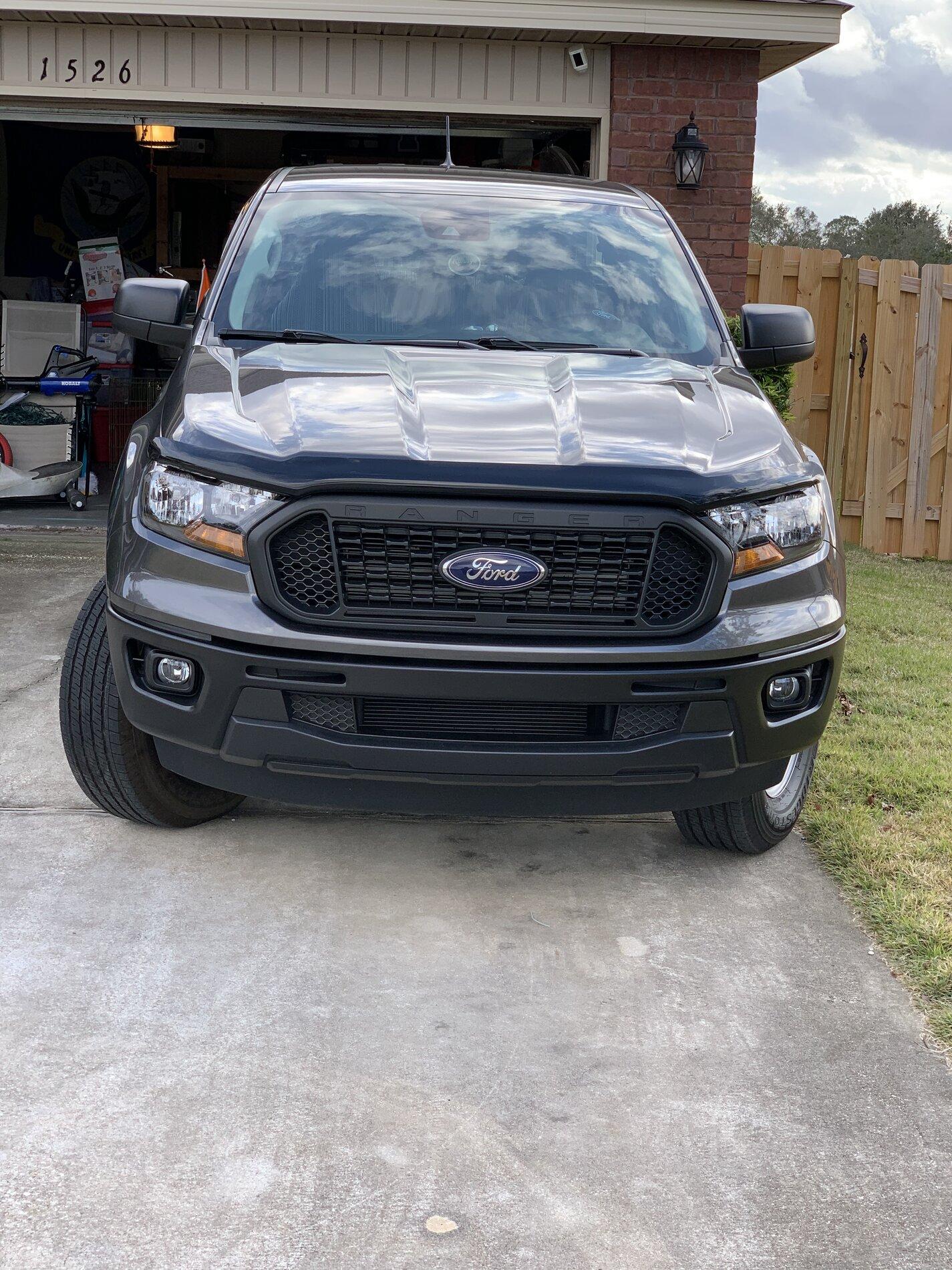

Well this was the first time I have ever put fog lights in. I have the lights installed took most of the day lol but I didn’t have to cut the crash bar and the second one went in a lot easier. So what do you think???

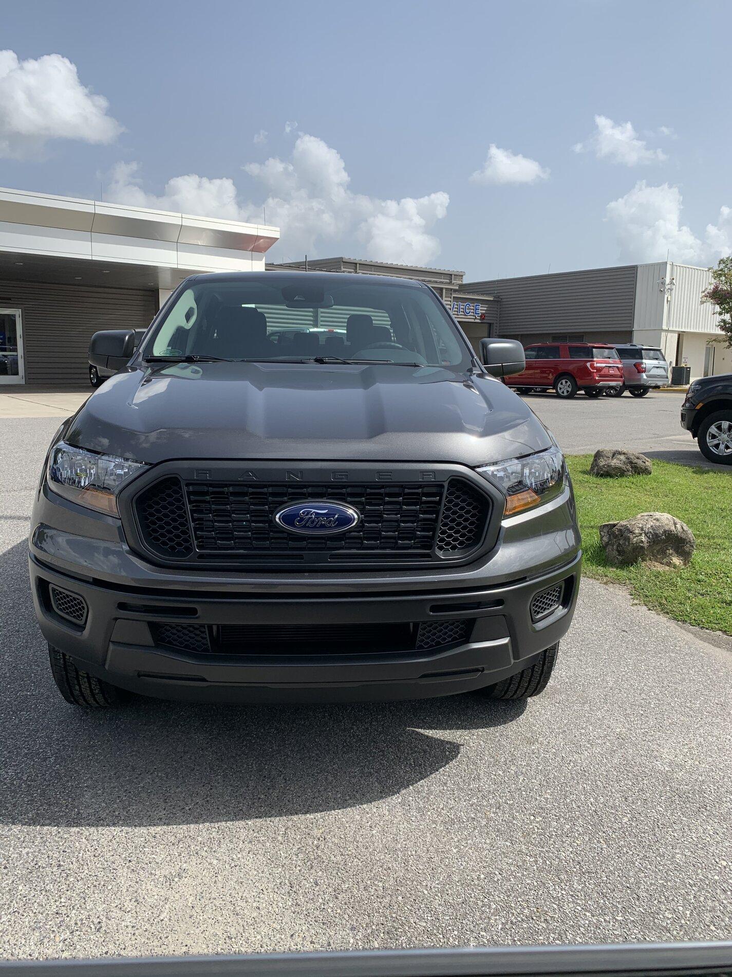

No I haven’t wired it yet it literally took me most of the day to take those blanks out and add the fog lights. I have a friend who is going to help me with the wiring. Plus I have a light bar coming also. I might as well wire them up at the same time. This what it looked like with the blanks installed.

No I haven’t wired it yet it literally took me most of the day to take those blanks out and add the fog lights. I have a friend who is going to help me with the wiring. Plus I have a light bar coming also. I might as well wire them up at the same time. This what it looked like with the blanks installed. I read in a post where the wiring was there but when I installed the lights I didn’t see any existing wiring for that. That would be nice

Looks much better with the fog lights!
Are those the factory fog light pods?
