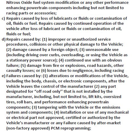

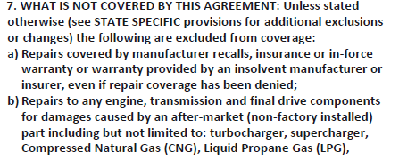

That's from the ESP contract. Note paragraph e). So very grey area.
