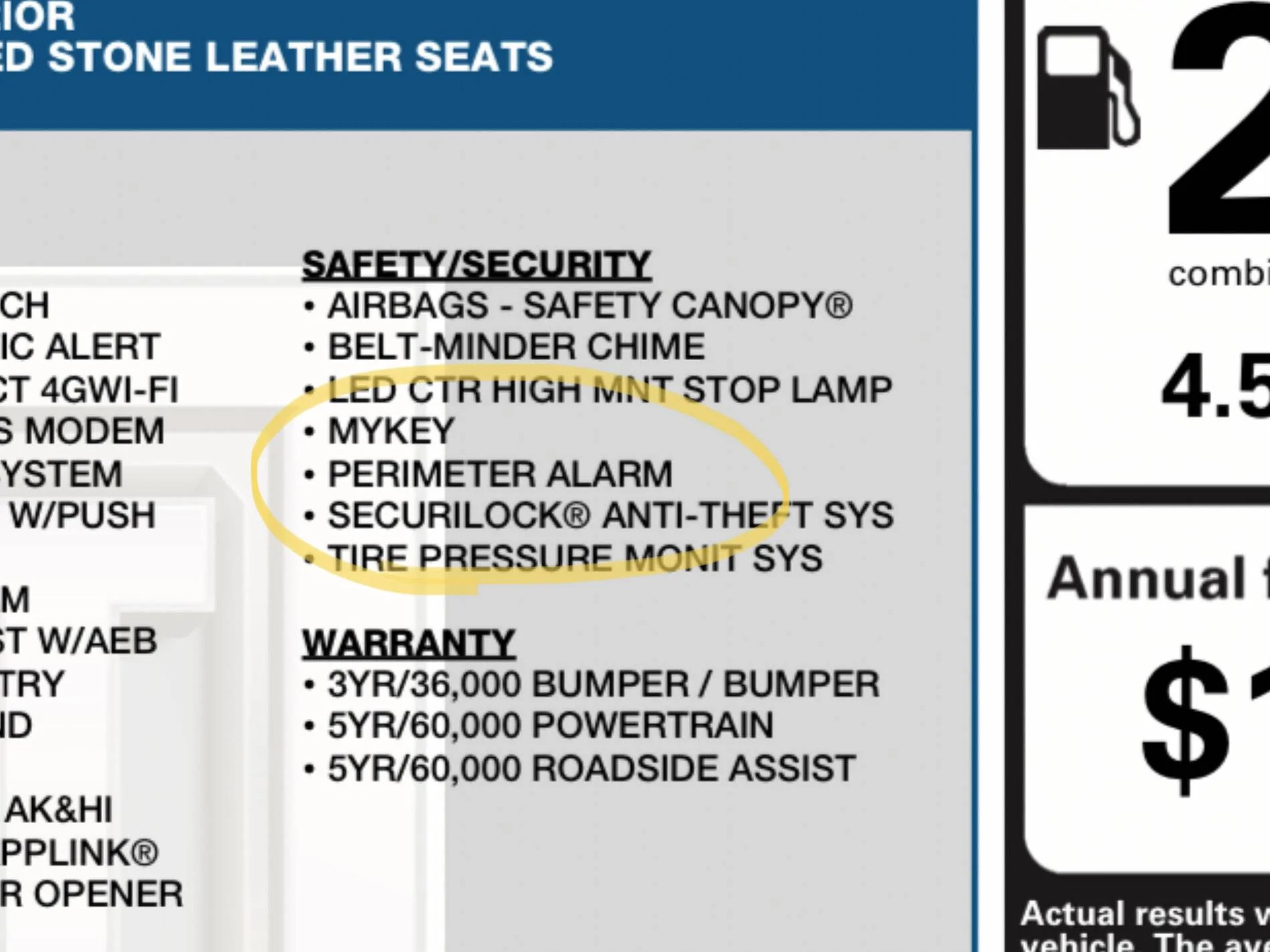

I never checked if I have it since I wasn’t sure how to check hahaha.
I check if mine came with Alarm which is said on the original window sticker, my wife stayed inside while I locked the car. After 10 sec she open the door and alarm went ON. It didn't work for me when I did same test cause I had the key fob.
Oh, is that alarm the same as the perimeter alarm? I heard the perimeter alarm can be changed in sensitivity IIRC. I definitely have that alarm for when the vehicle is trying to be opened from the inside after locking. A few times I locked the gf in the vehicle prematurely and it rang right after hehe ? maybe when I get my hitch armor back I will give the hitch armor a good kick after locking and see if the perimeter works not just from inside. Appreciate the insight Bladimir!
I'm not sure if this is the same as perimeter PLUS cause but will check.
