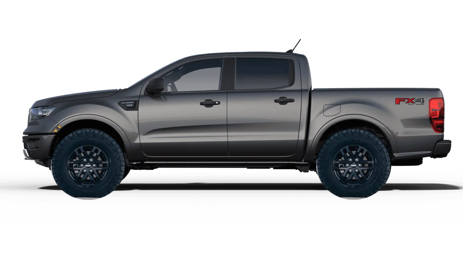

My dealer is still waiting on pricing and info on these rims, but we do know part numbers.
M-1007K-RGR1785OR
I did a very fast cut and paste to see what they would look like on my build. I think with the lift and fender flares, they will work for what I was going for.

I seen somewhere they will go for $1k a set.
