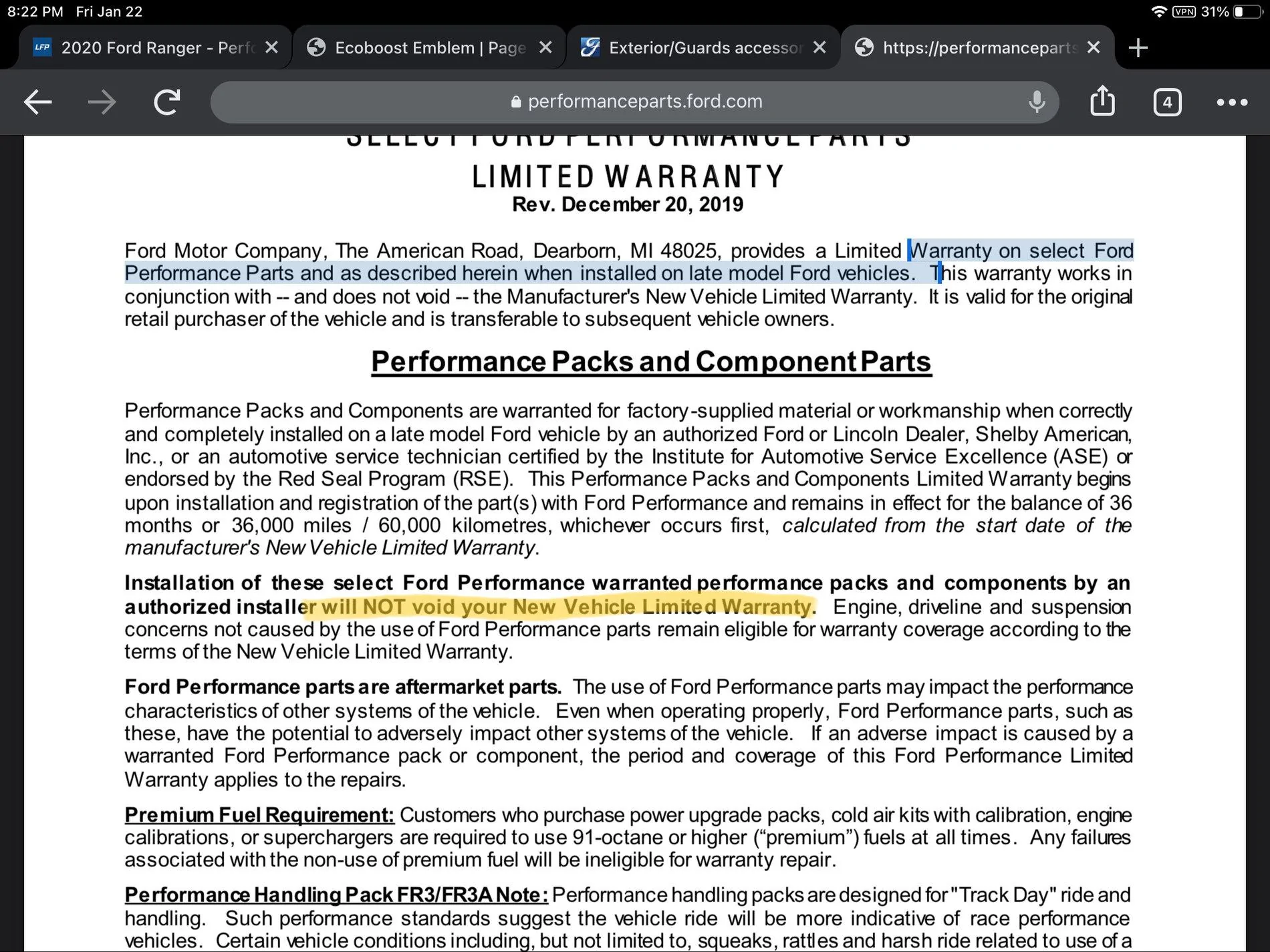

Reading through the warranty docs on the FPP website, the gist seems to be that the FPP warranty covers any damage to the vehicle that is found to be caused by the FPP parts or software added to the truck. The FPP 3yr/36k warranty starts from the date of sale of the vehicle, not the date of install of the parts/software. The original OEM 3yr/36k bumper-to-bumper and 5yr/60k powertrain warranties are left intact.

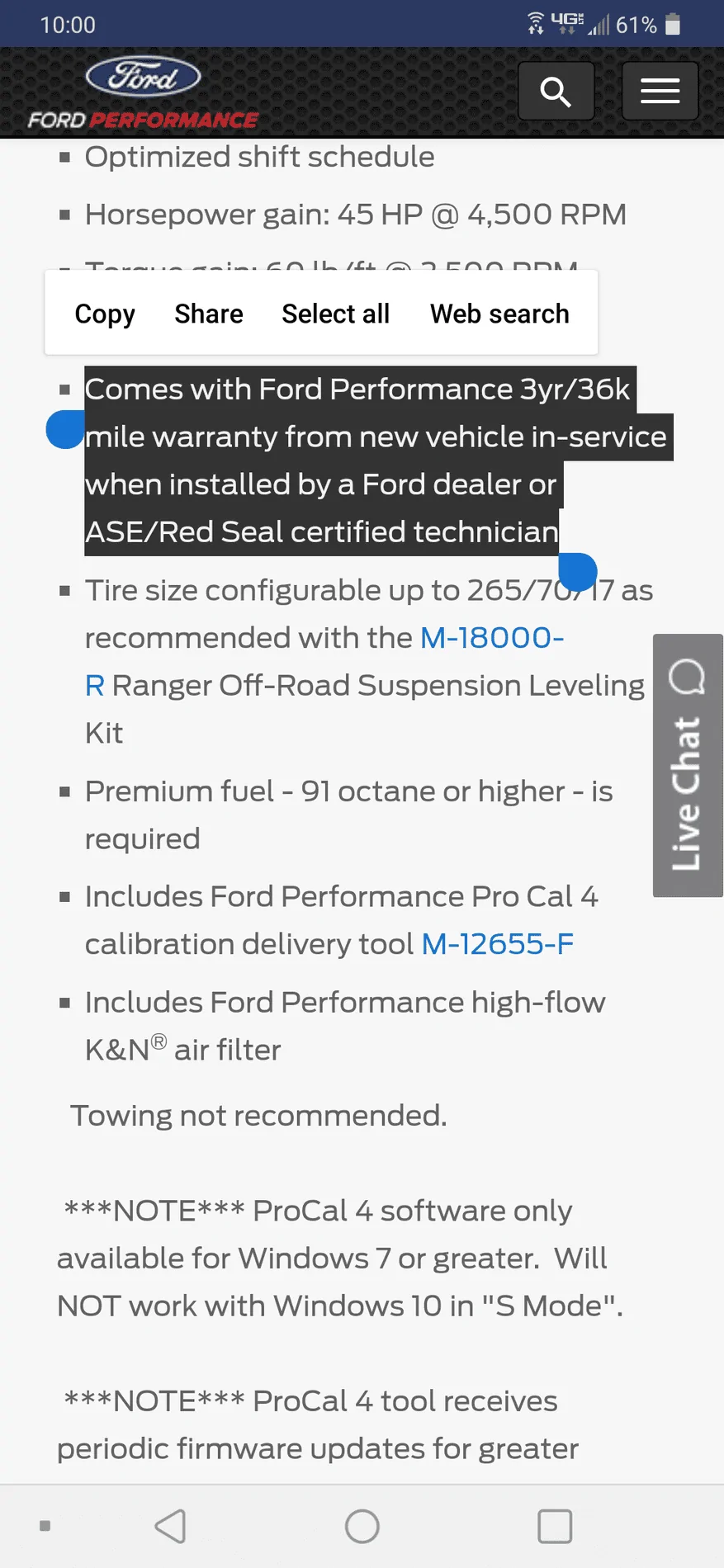

This just isn’t true and please nobody listen to this misinformation. Before purchasing I checked several times with Levittown Ford, Ford Corporate, Ford Performance, as well as two of my local dealers and the 5/60k powertrain is still intact with the tune, as well as any extended warranty (as in my case). Please do more research, Frenchy, because you are spreading false information on more than one thread.
Imagine all the Rangers out there with extended warranties. You think Ford wants to reimburse all of those in exchange for a $600-800 tune? Imagine the headache and back and forth the dealers who sold extended warranties AND the tune to the same owner if something went wrong after 3/36k.
https://performanceparts.ford.com/download/PDFS/fpp-warranty.pdf
this is the website I found the warranty on. Didn’t mean to start a controversy but as you can see, it’s not always clear. When I check the pdf at Ford perfomance, it implies that your factory bumper to bumper and power train warranty stays intact.

The 5/60k warranty is still valid even in Frenchy's truck with a Livernois tune. It is up to the dealer (if something goes wrong) to say it isn't valid BECAUSE of said tune. I went with the Ford tune because if something did go wrong I believed it would be harder for Ford to point their finger at their own tune rather than a 3rd parties.
The 3/36k warranty for the ASE installed Ford tune is if something awry goes wrong with the Procal or tune itself once in the truck's memory, the warrantee can take it back to the ASE shop or any Ford dealer and get the tune reinstalled or the Procal replaced in that timeframe. After that 3/36k you are on your own tune-wise, not drivetrain-wise.
Say OP bought the calibration and installed himself/herself. Later on, hypothetically, the tune fudges up in the computer and is constantly recalculating shift points rather than adhering to a set. OP cannot take the tune back to where he/she bought to get it fixed under warranty. He/she would have to pay to have the tune reinstalled. If this second fix was either at an ASE shop or Ford dealer then OP can take it back under warranty if it fudges up again.

So here is a nice little thing to back up my so-called missed information that I'm spreading. Strait off the Ford Performance Website that confirms that the Powertrain warranty goes from 5 year 60,000 miles down to 3 years 36,000 miles. Is it backed by Ford? Yes and no. It is really backed by Ford Performance but you still keep a warranty of sorts wich is still better than nothing.
Nowhere on the website, or in the warranty, or in what you just posted does it state the powertrain warranty gets “downgraded” or replaced. You are not understanding what the warranty is, and then fabricating information to fit your fabricated conclusion. The 3/36k warranty is on the tune, device, and install. Did you even attempt to read the warranty or look at the above post where it explicitly states that the 5/60k powertrain warranty is still intact? You are not being helpful to OP.
