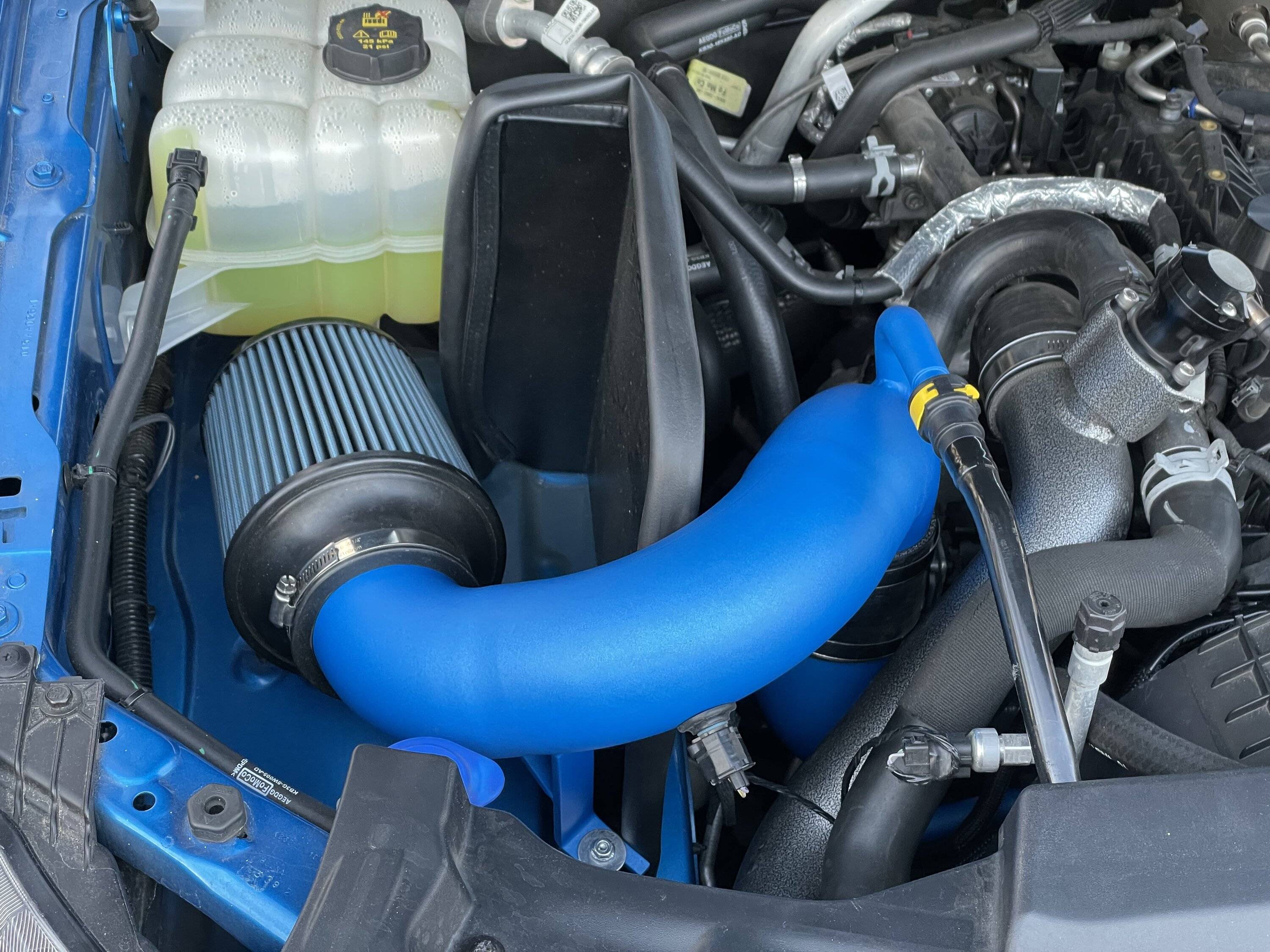

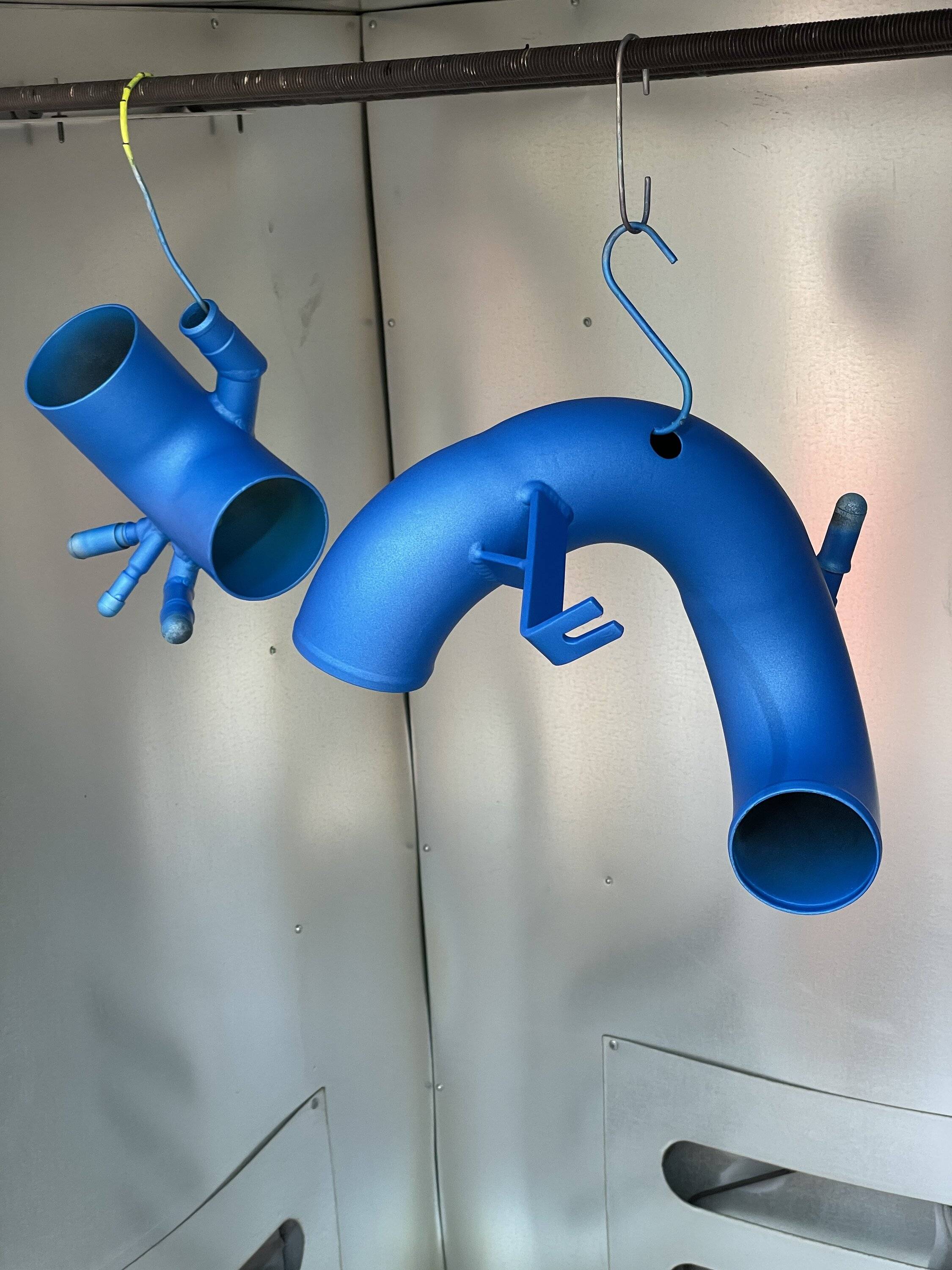

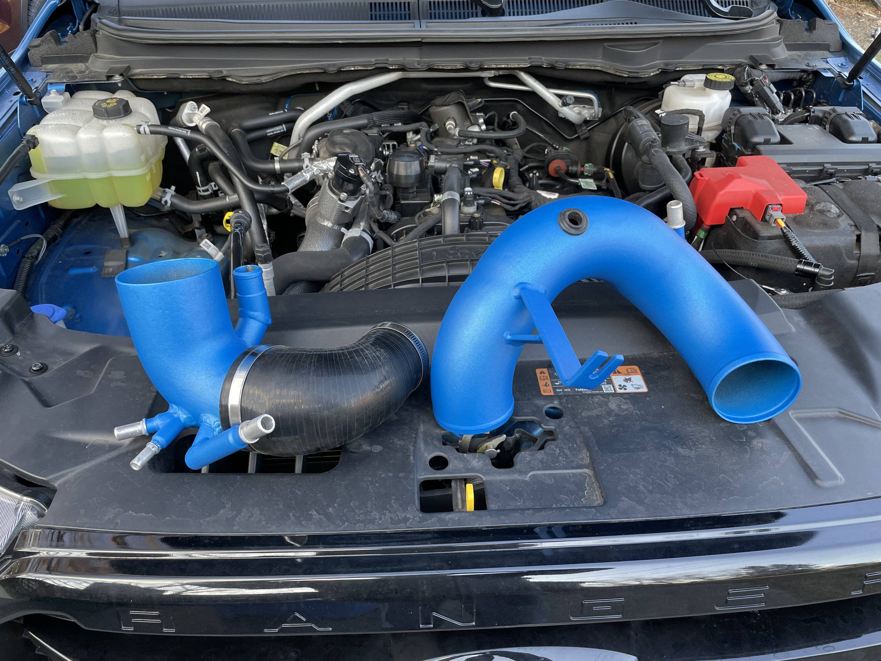

Finally got around to getting the crappy finish stripped off my Injen intake. Had both pipes powder coated Illusion lite blue and top coated with Phantom clear. I’m pretty happy with it for now.

Nice. I wish my truck was blue. I'm curious though, it looks' like that will be picking up hot air from the engine bay, is it missing a seal around the coolant bottle?

It’s not missing anything. That’s how it came. This type of intake sacrifices some low speed heat in the name of cool turbo noises and a lot more available airflow. I have datalogged this and so far it’s only hotter when moving slowly or sitting still. Driving at speed and flooring it tends to bring intercooler temperatures down to nearly ambient and intake temperature not much warmer than that.

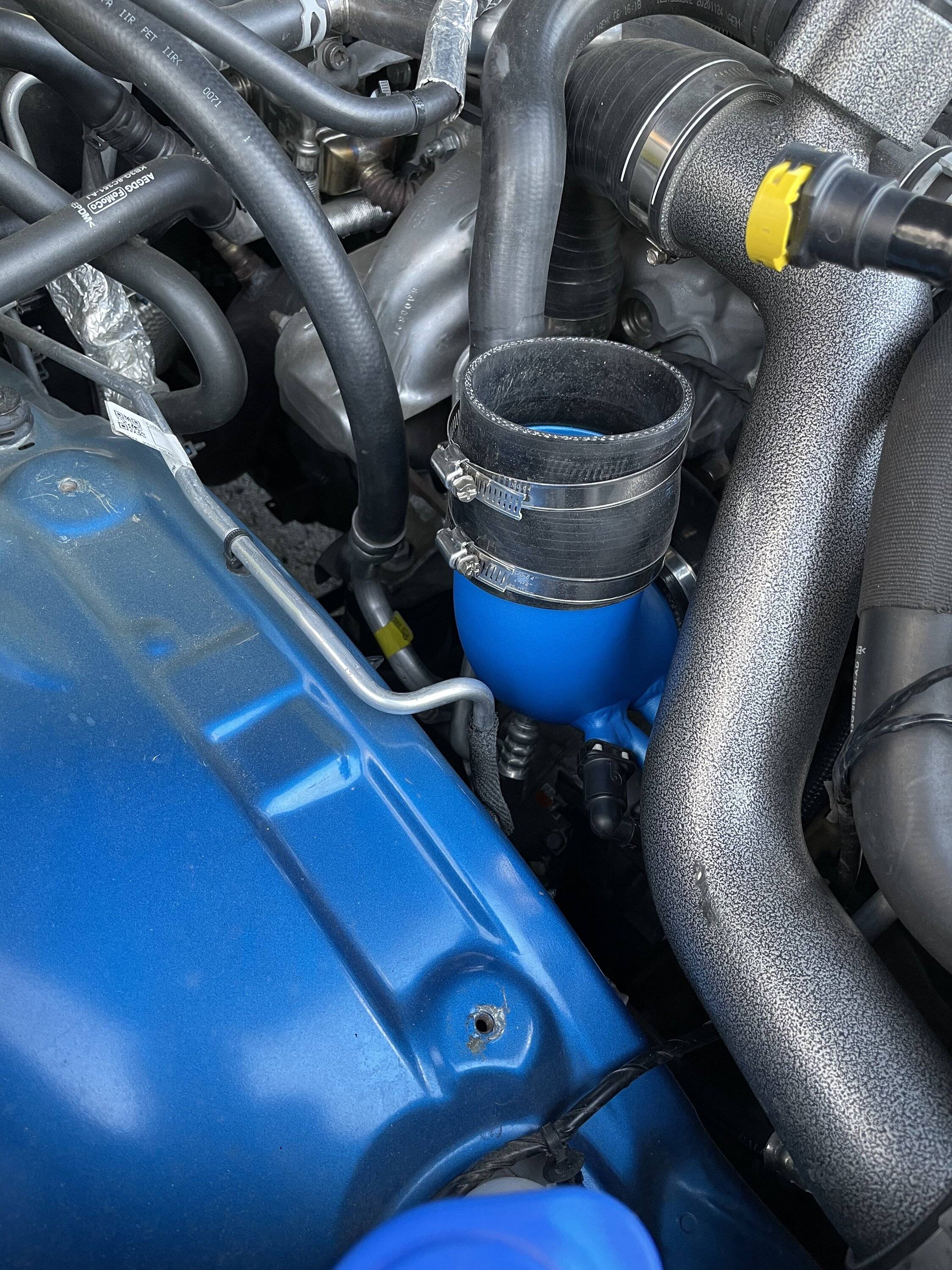

Man, what's with all the scratches and paint chipping around the mounting holes for the oem intake box?
One too many bud lights and an oversized screw driver?

My truck gets used for product testing and tune development. It’s been apart or reconfigured many times over.

Back to your turbo intake: is the appendage on the factory piece some type of noise abatement?
