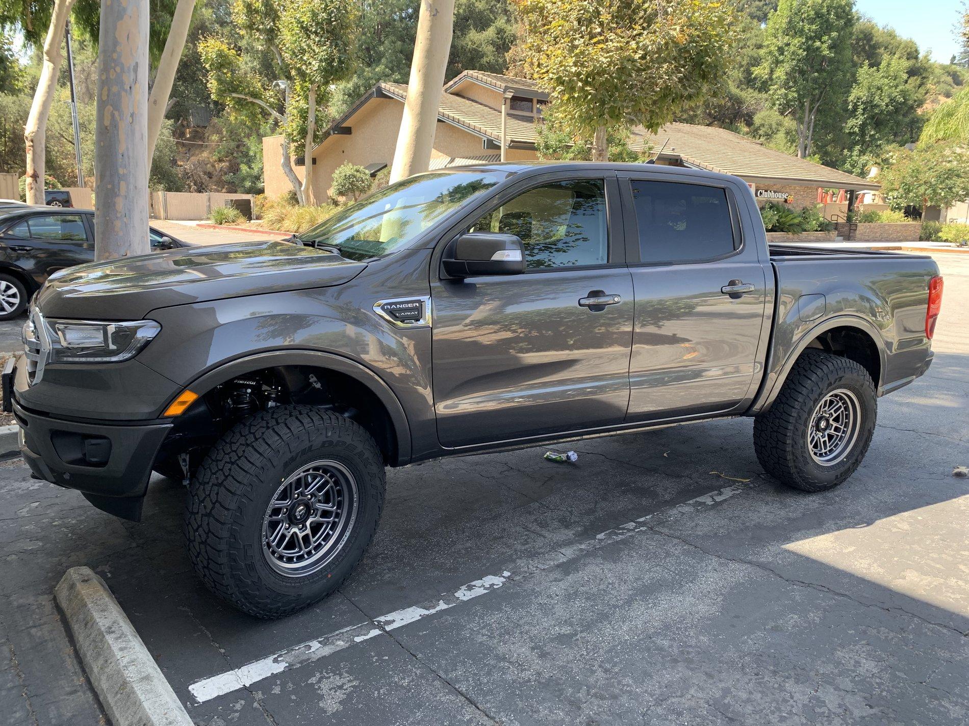

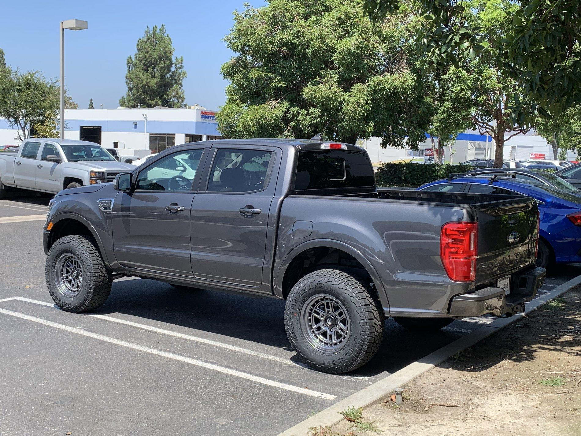

Installed the fabtech 3.5” kit and crash bars, left the rear block out
Fuel Nitro 17x9, +1
Falken Wildpeak AT3 285/70/17
FFF SPECIAL! Feels like a truck meow

Did you change shocks at all? How is the ride compared to stock? Lastly, does the truck sit level with the front lifted 3.5" and the rear left alone? It kinda looks like the front is up a bit higher than the rear now.

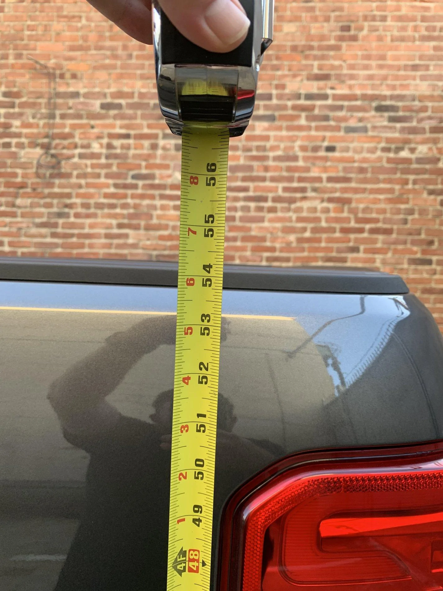

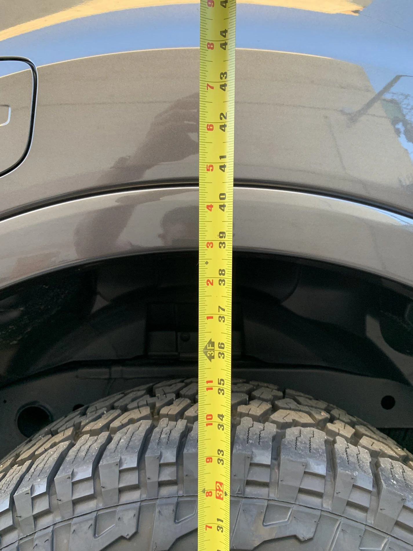

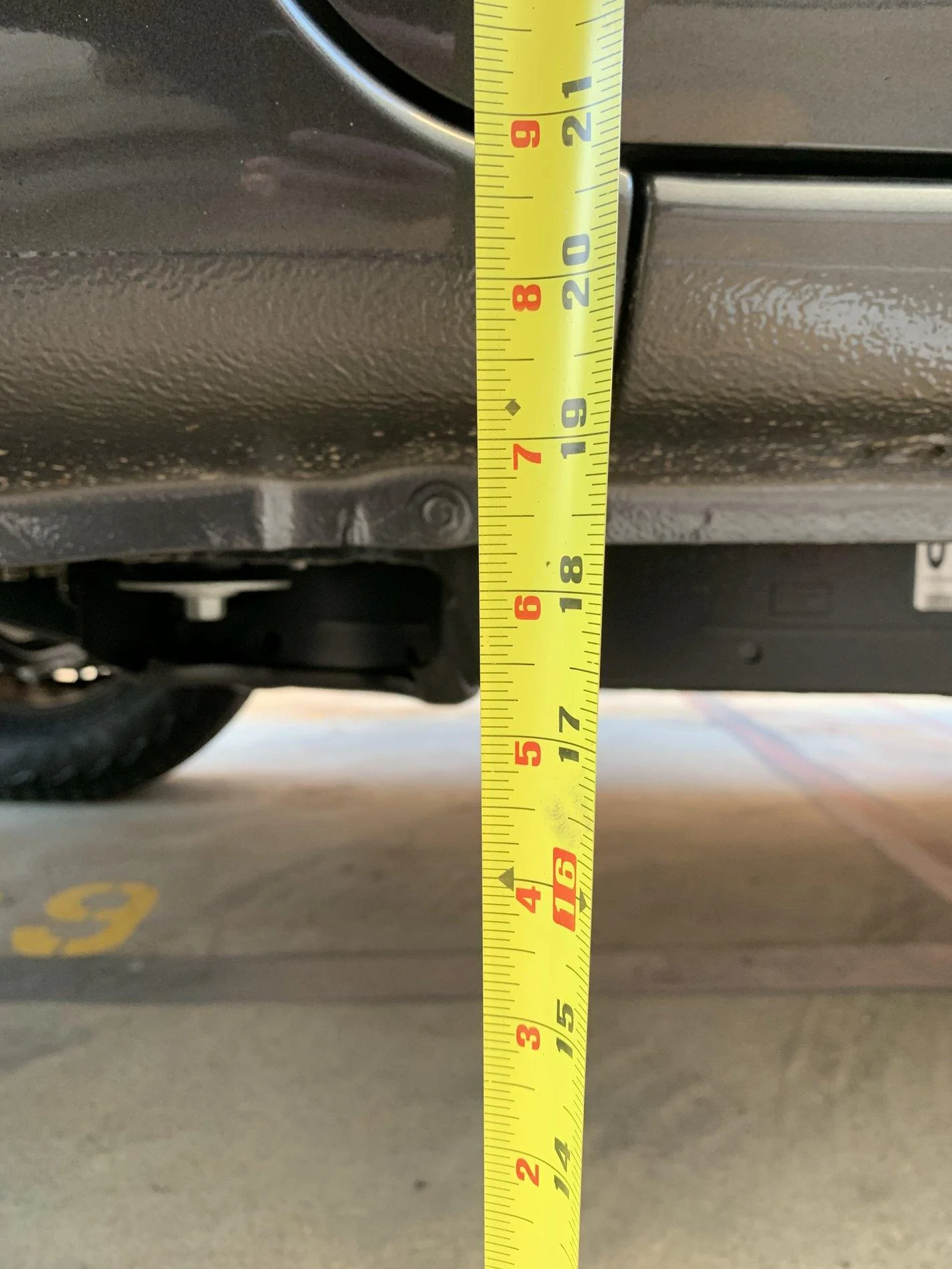

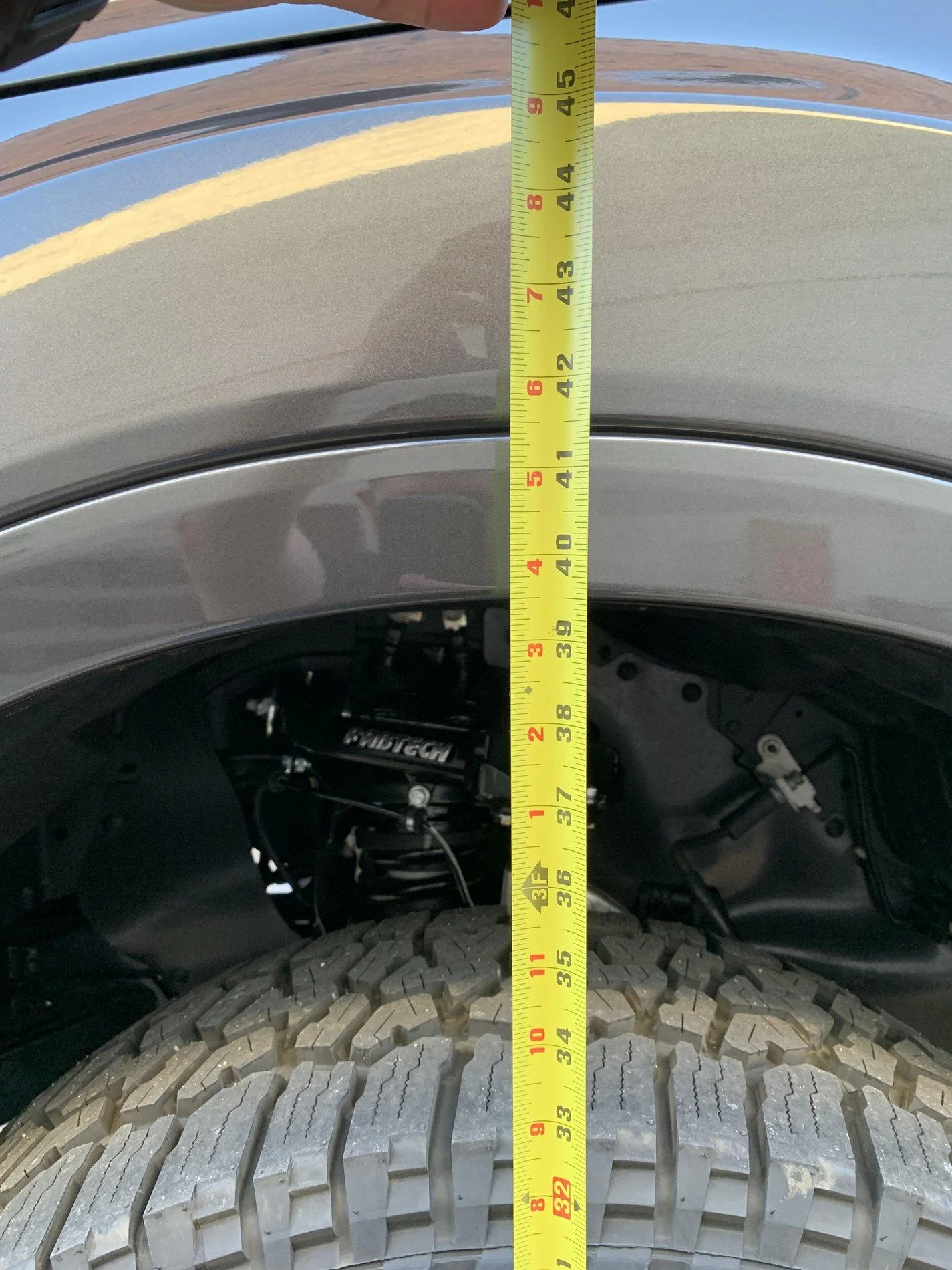

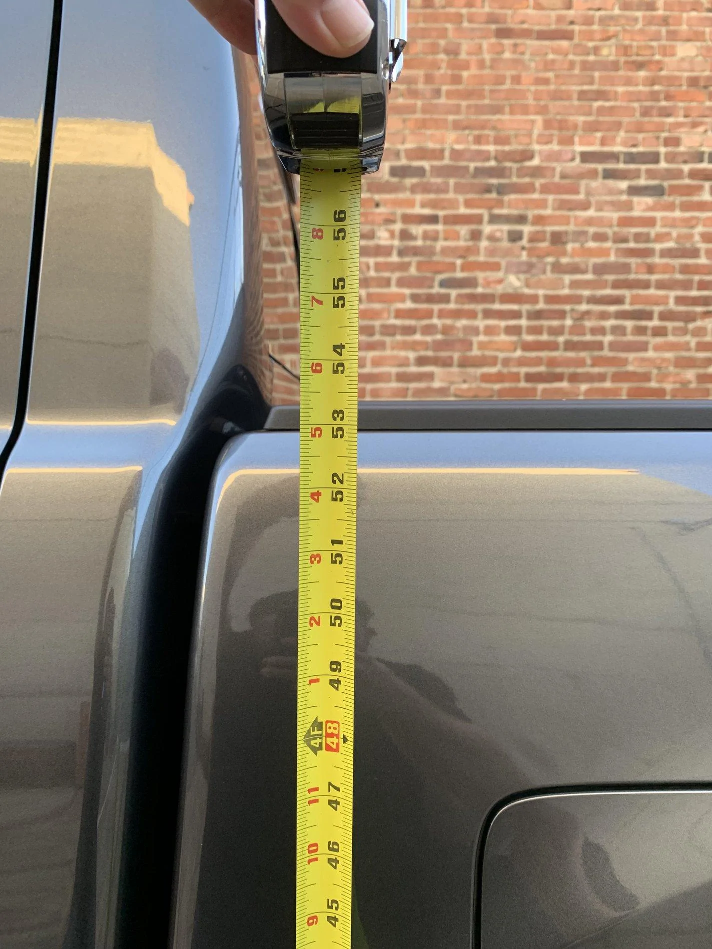

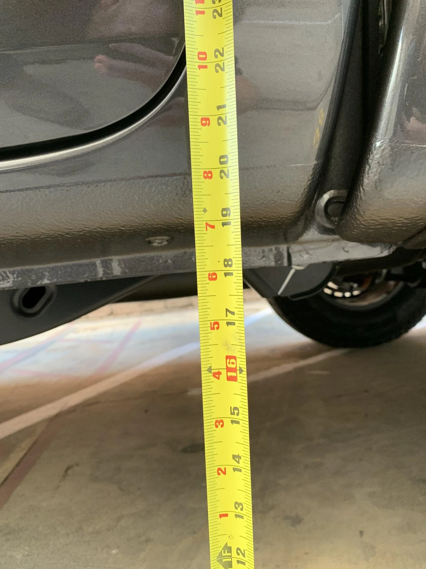

I just got the cheapie fabtechs for the rear, softened it up a bit but still feels stout. The gap between the top of the tires and fenders is larger in the front but I like the way it sits. Pictures below comparing the following:
1. Front ground to fender vs back
2. Front of bed from ground vs back
3. Front of cab from ground vs back
