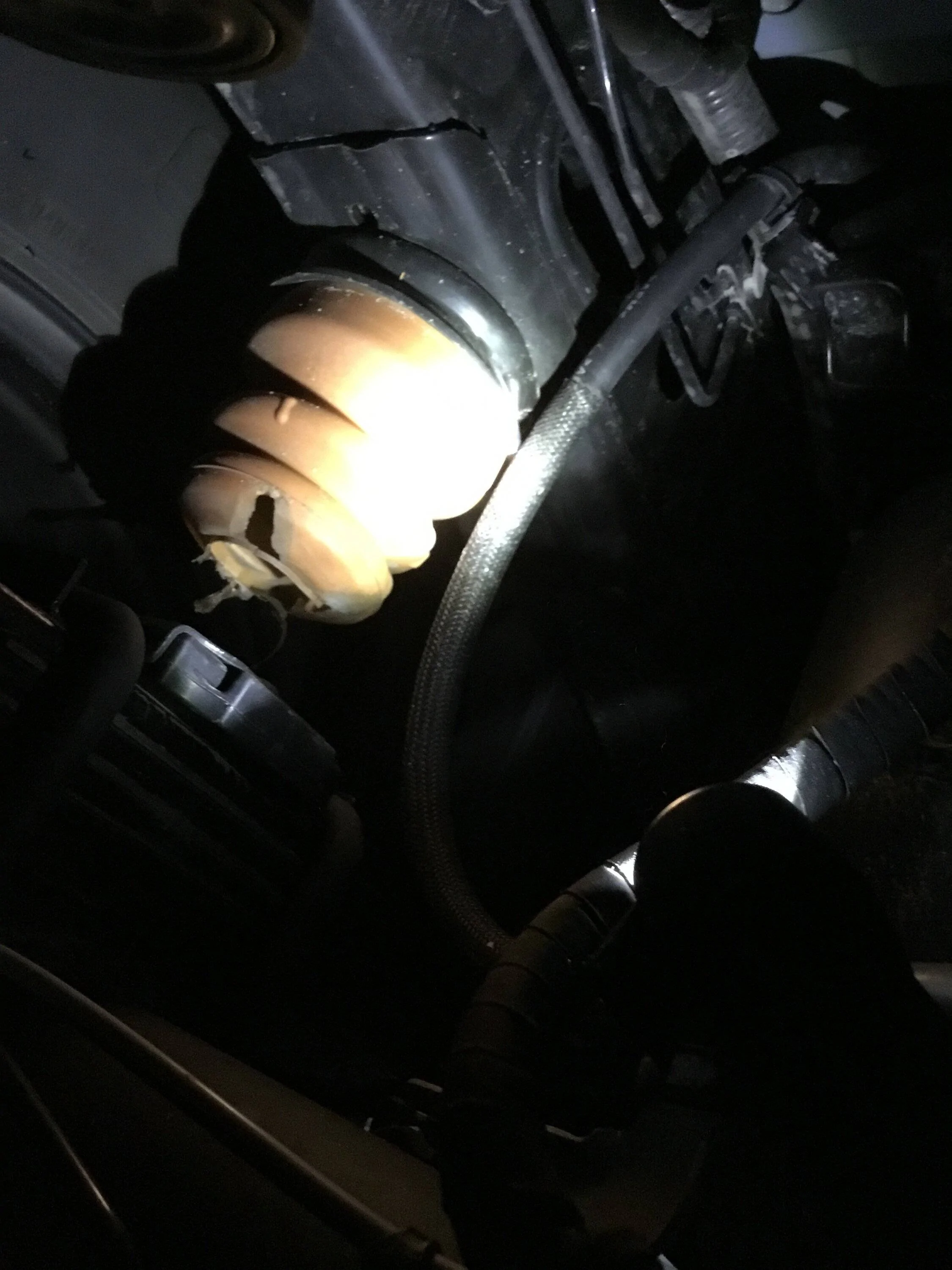

I’m a plastics and rubber engineer and Just noticed both orange bumpers over rear springs are incompletely filled parts (bottom 1/3 is thin and missing in spots). I can understand how they accidentally got included with good parts at the molder (although it’s not a good sign) since during startup the tool and molding machine has to warm up and settle in. molded parts typically automatically ejected and collected In a box or container. But how can an assembly worker install something like this??? Both sides are bogus.
just contacted dealer to get them replaced, should not be an issue as they are obviously defective from factory. Never seen anything like this on my 2012 Tacoma or 2016 T4R. Ford needs to improve quality control. Pinch welds look like heck, too. Love the Ranger but wish Ford manufactured as well as Toyota. They charge enough for the product!
Actually, getting defective parts included in the bin with parts that meet spec is the problem. By the time the assembler on the assembly line gets the parts, it needs to be assumed all the parts in the bin meet spec.

There is nothing wrong with your bump stops, they are just hunks of foam and long as they are present they are fine.
“Pinch weld” areas always look the same, kinda crappy. Yotas included. Same spot weld robots used by all the factories.
Try to just enjoy owning the most reliable mid-size on the market and don’t over analyze it too much.

You sure? Like others have said, your bump stops are completely normal. All of ours are like that, they are not supposed to be solid rubber. I would do some research before the dealer laughs at you, and probably before going on an internet tirade.

Hey just as a heads up, that’s pretty normal looking, Toyotas don’t use an “active bump stop” they use a pretty standard stop which is rectangular in shape, ford uses “active” the bottom is meant to flex up before hitting the hard part of the bump cone which has very little give. A lot of people to upgrade to get short or more rigid ones from eibach, timbur, or icon.

I just went out and looked and can confirm the consensus that it is normal.
I will say mine looks a lot nicer than the OP's, the cut-out actually looks moulded with rounded edges, etc., not like someone took a box cutter to it, but the OP's is definitely not defective.
