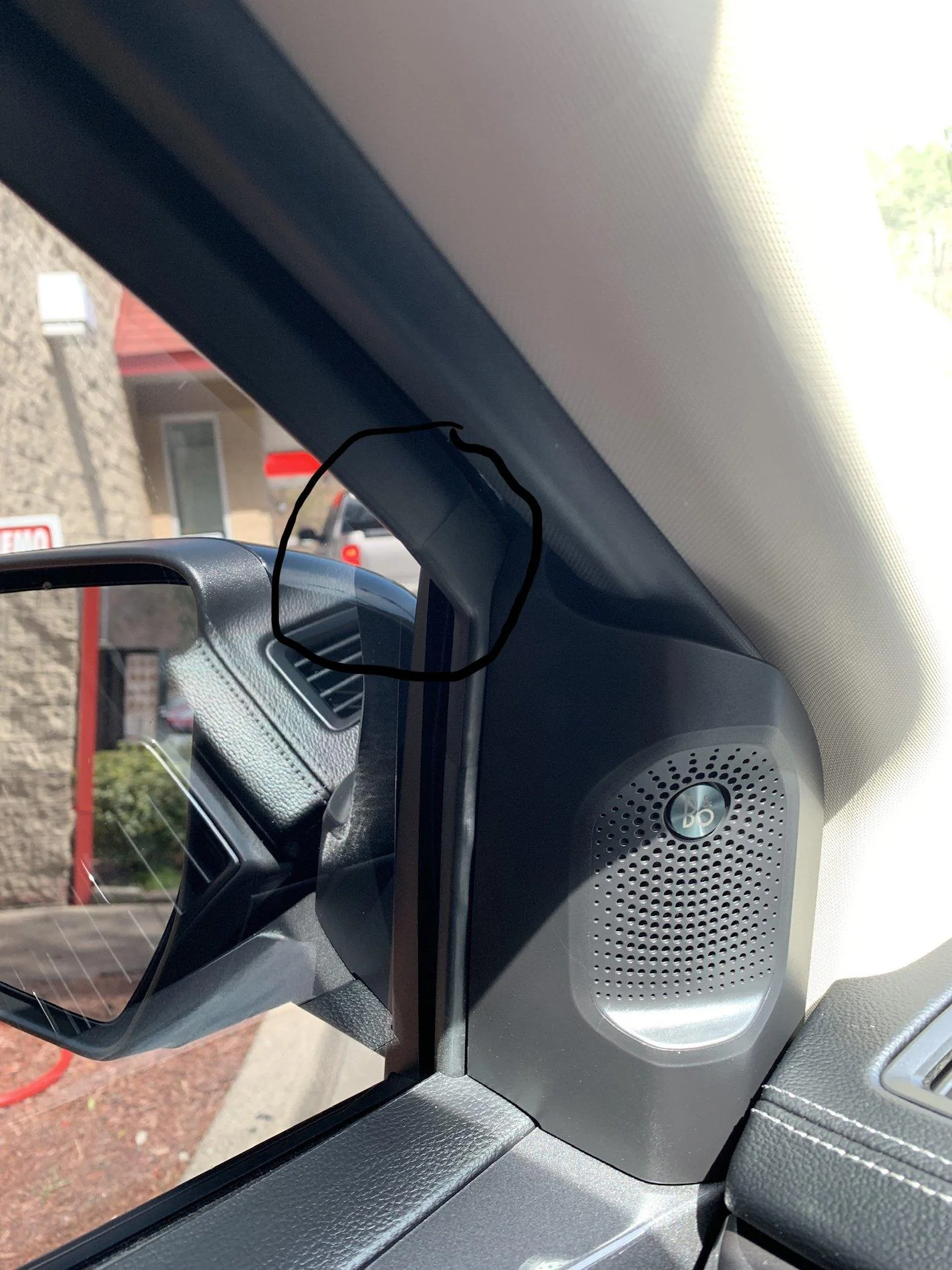

Just a update I have found the problem and it’s going to the dealer Wednesday .. it’s in the rubber seal that’s around the drivers window track next to the mirror .. I’ll take a picture and upload it and circle the area .. it’s somewhat lose fitting but you can press on it and make the sound go away

Glad you got it resolved! Can you upload the pic with the area circled? I'd like to take a look on mine as well. Thanks!

I could take my fingers and press and pinch on the circled area and make a huge reduction in wind noise .. my wife from the passenger seat could even tell

Thanks for the pic!
