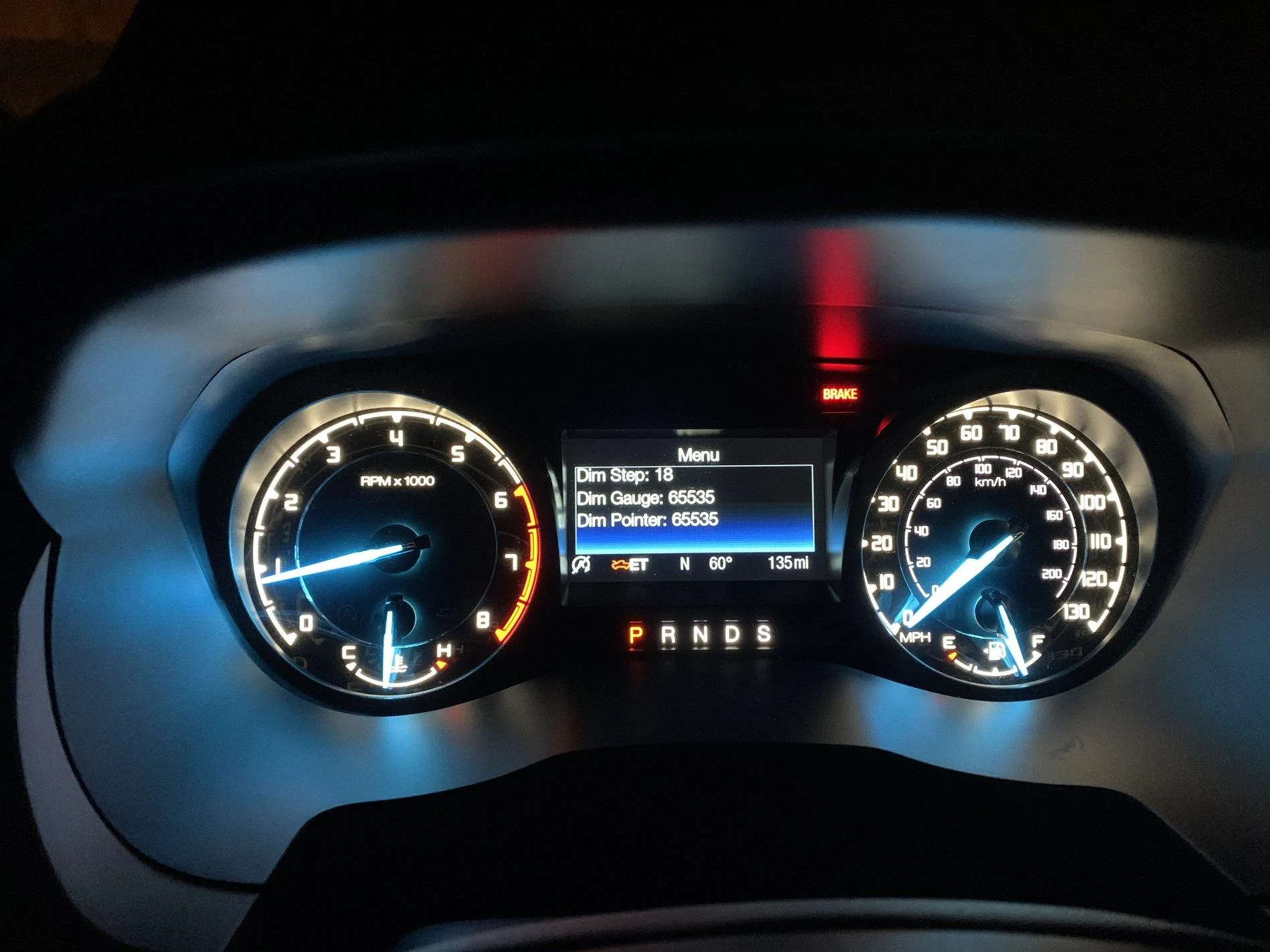

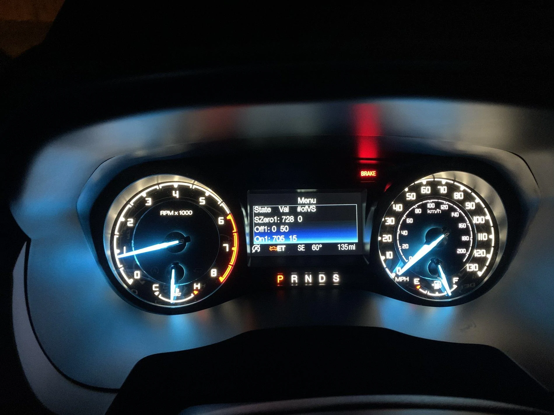

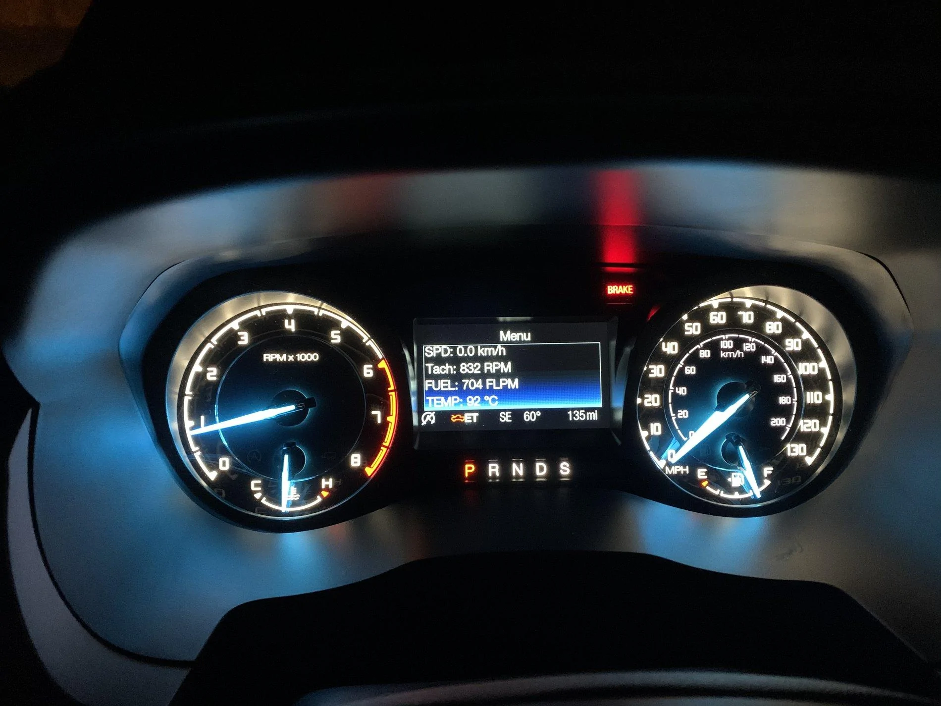

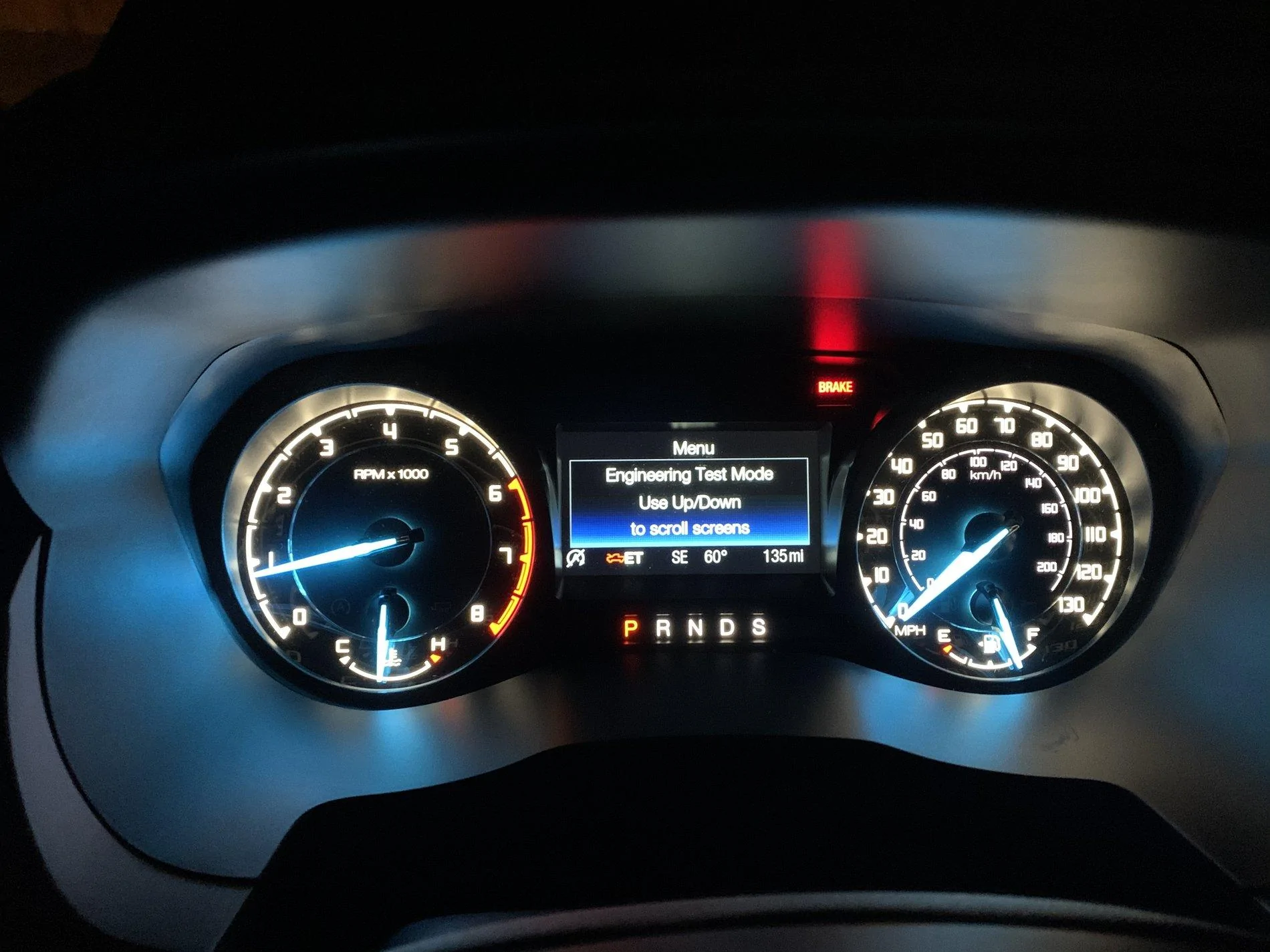

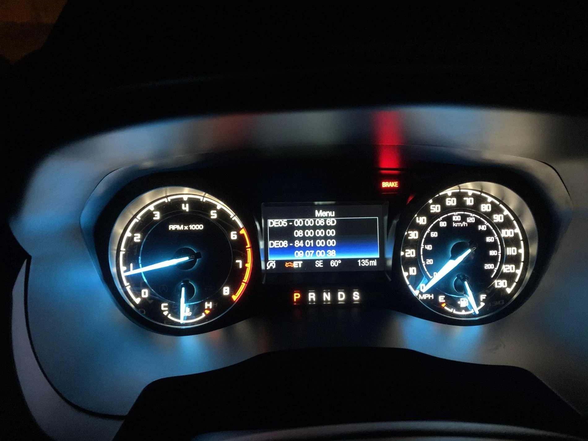

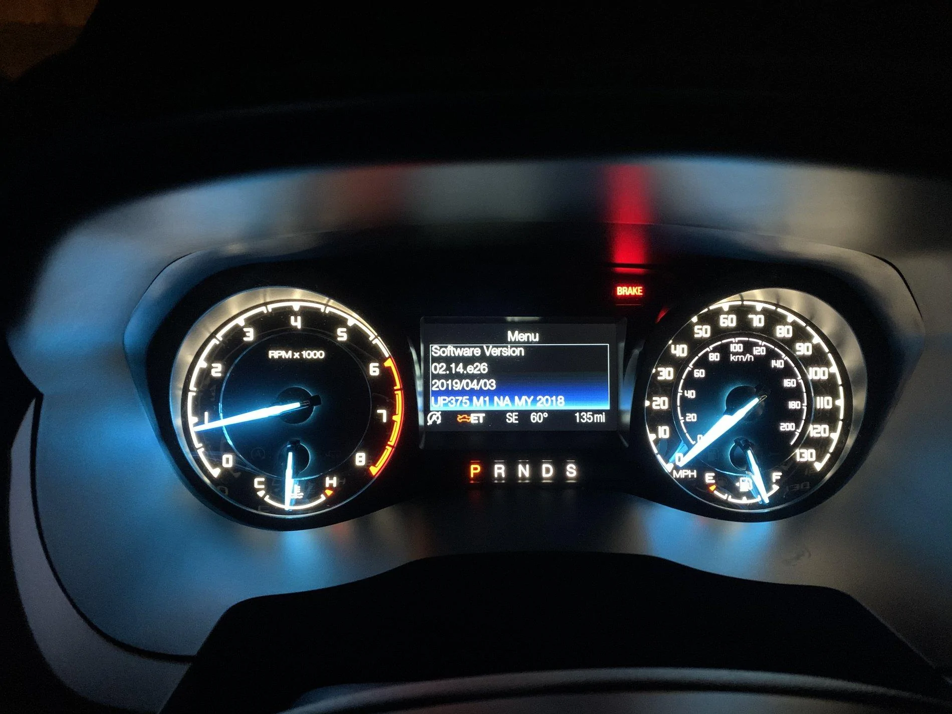

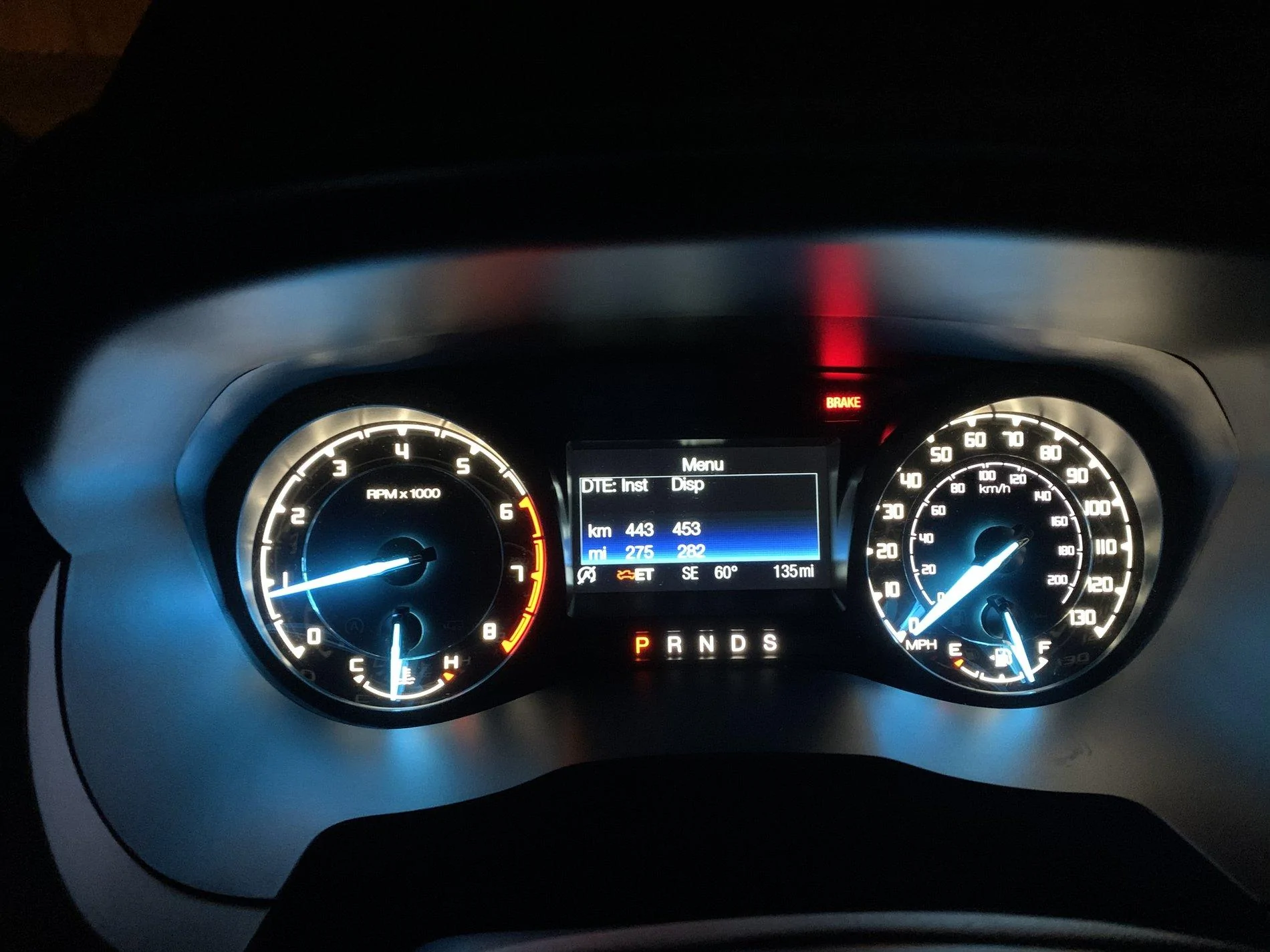

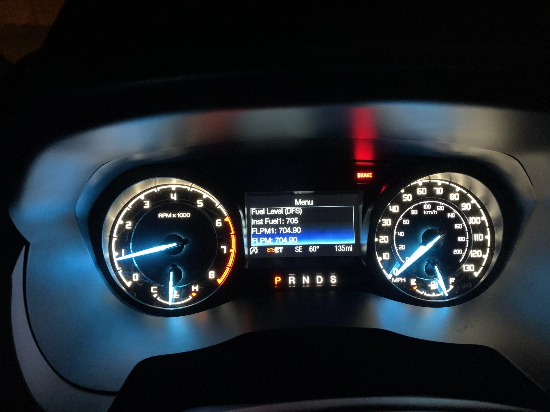

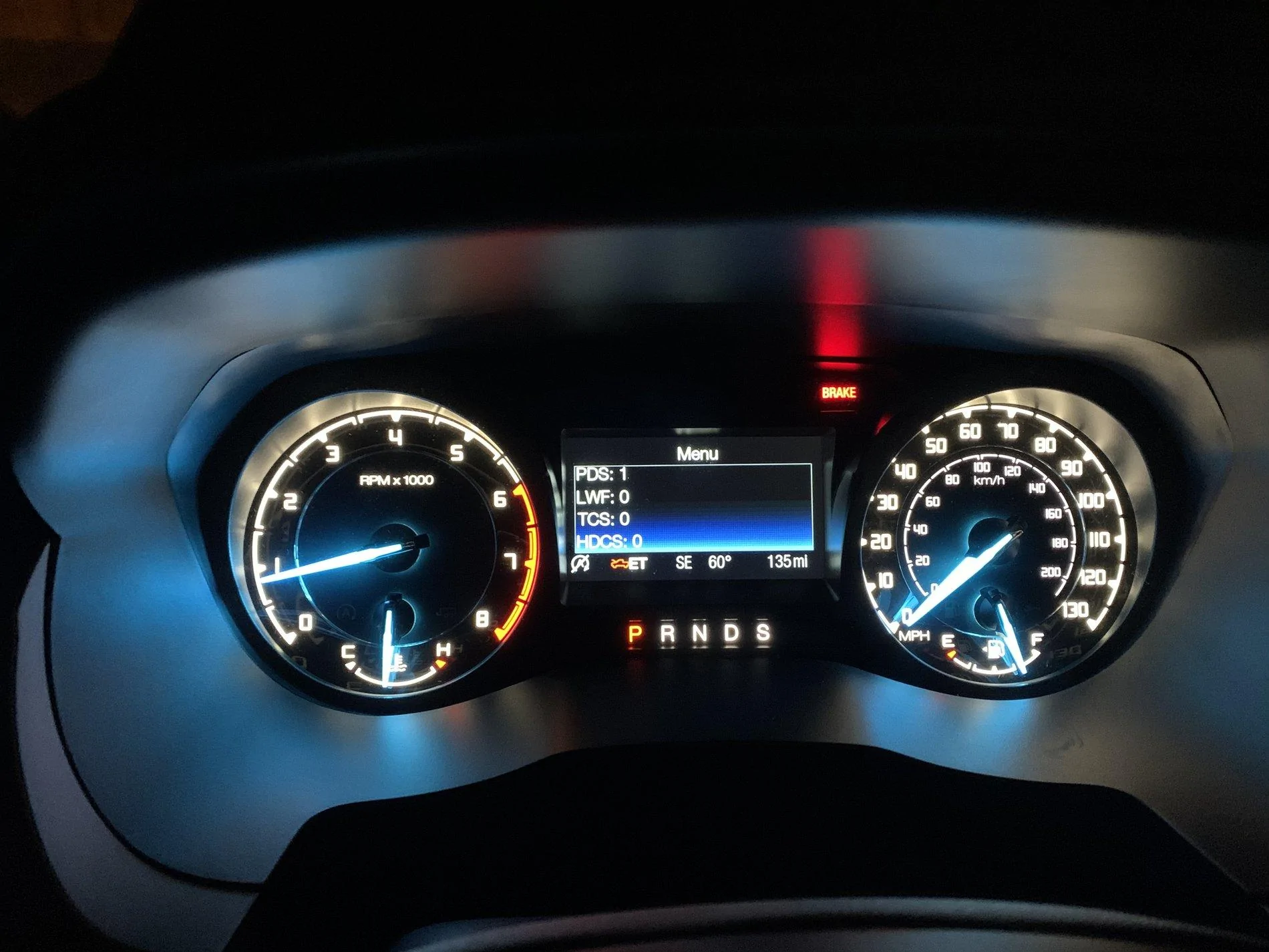

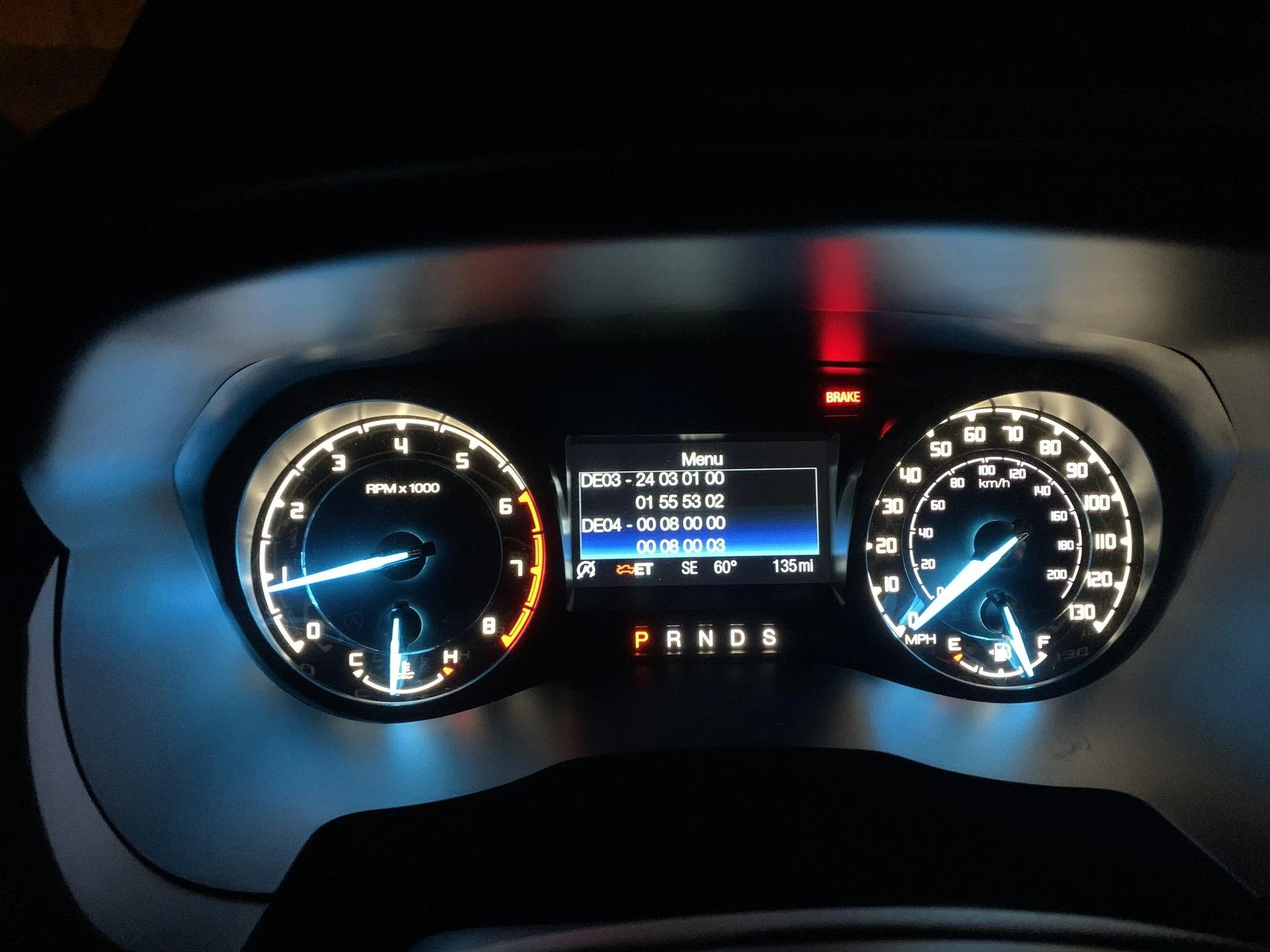

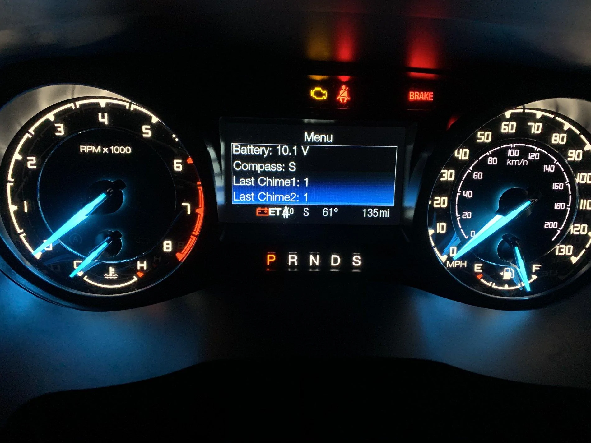

To enter engineering test mode:
  1. Unlock truck, get in close door
  2. Press and hold OK on the left steering wheel button 10-15 seconds
  3. While holding OK insert key into ignition and turn to RUN
  4. You’ll see ET appear in your display — release ok button

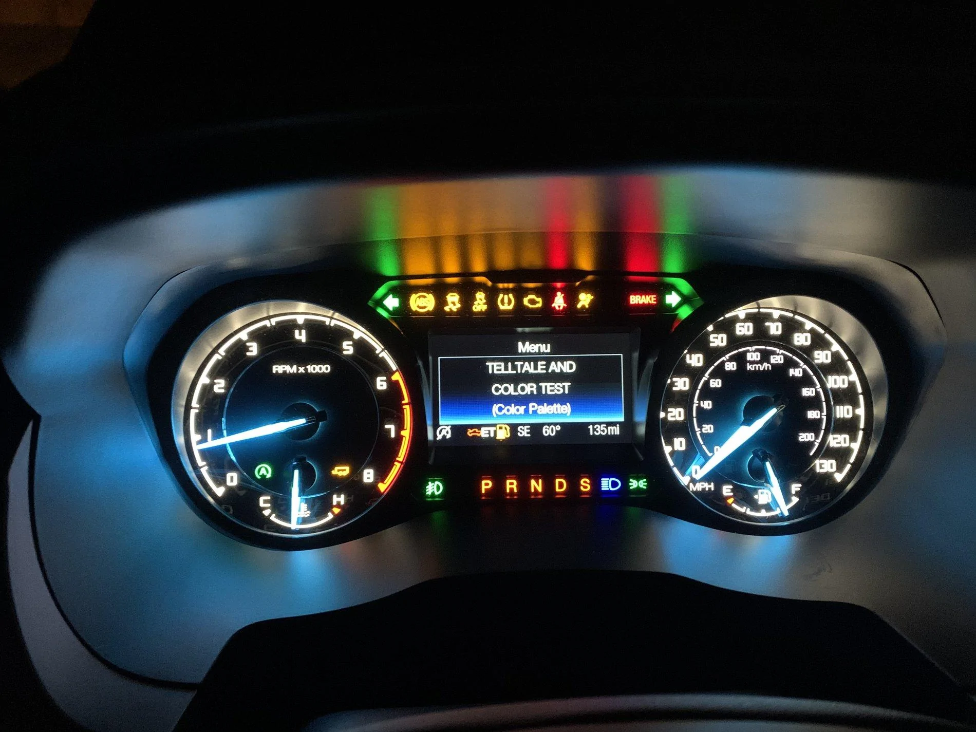

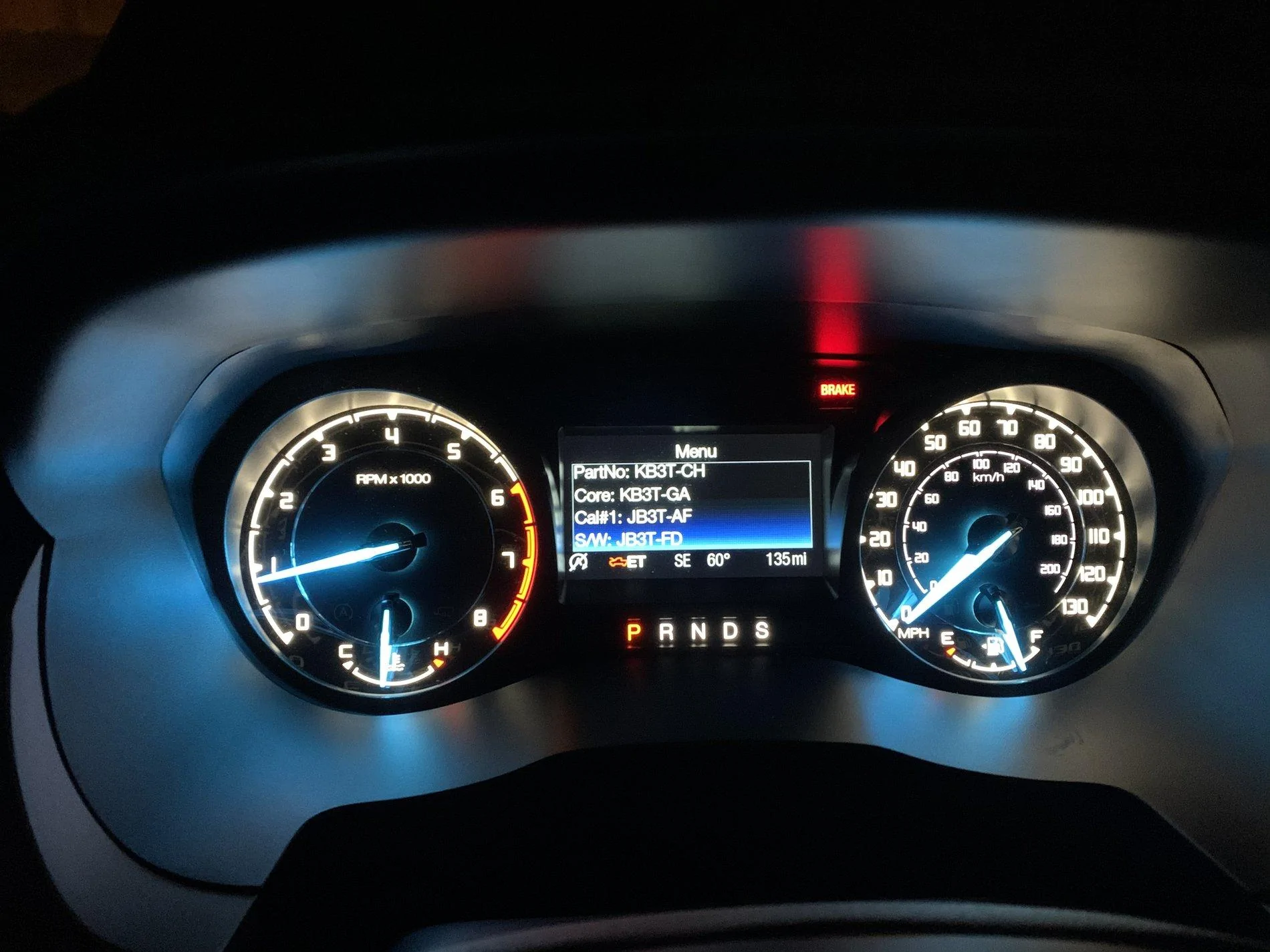

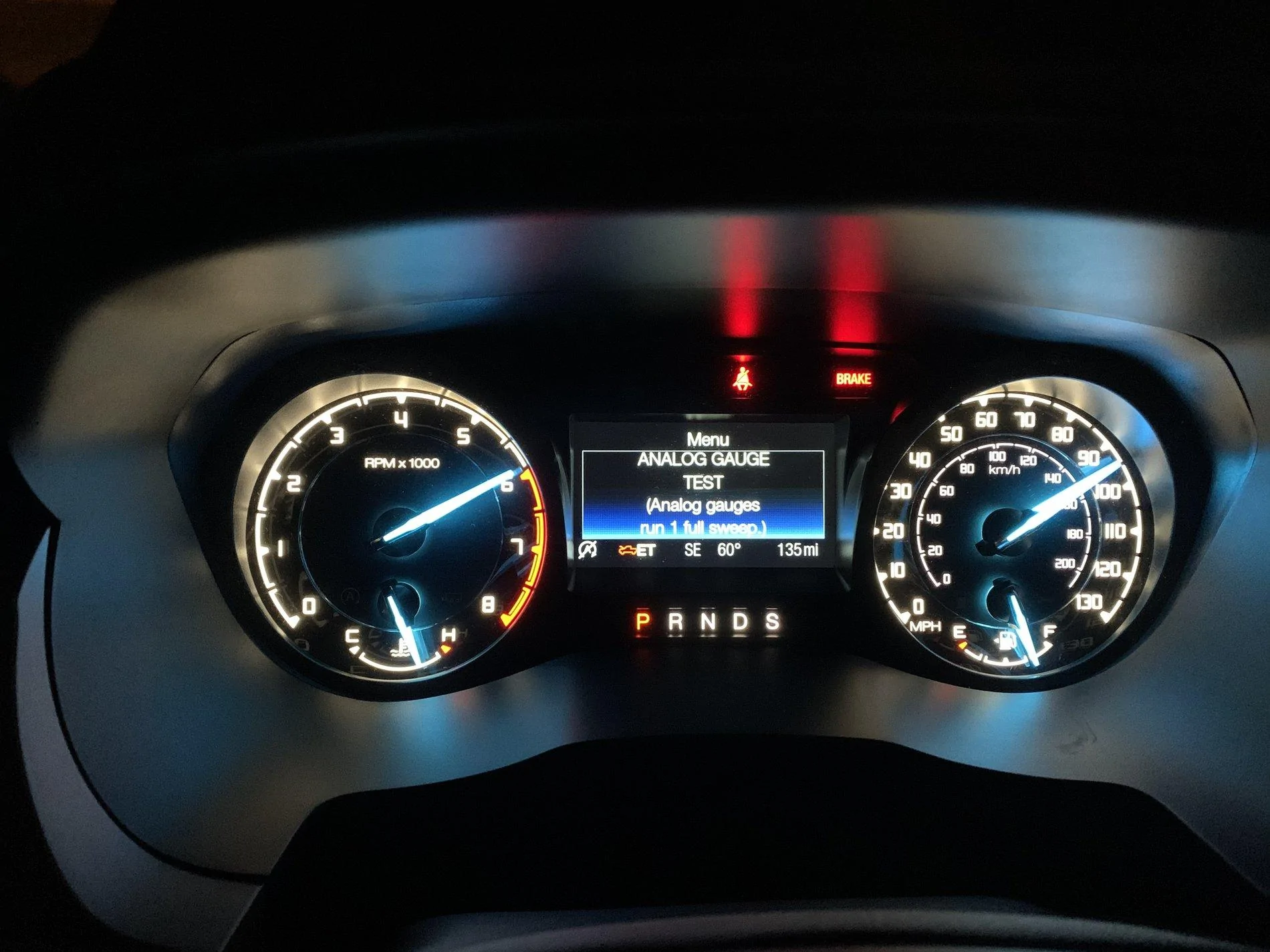

  5. Use the up and down arrows to scroll through

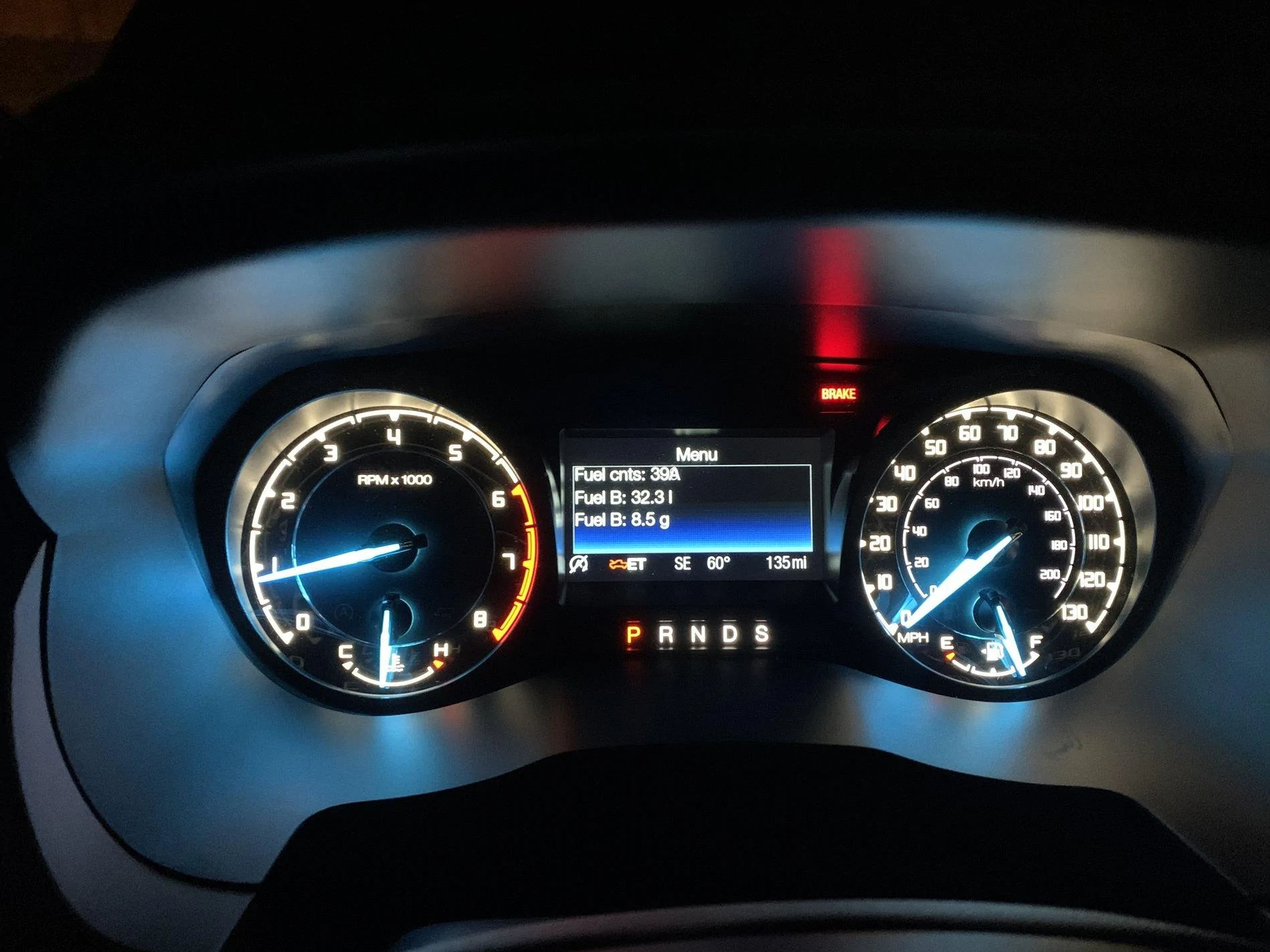

Things you can check
  • Battery charge
  • Gauge sweep
  • Fuel in tank
  • Live rpm data if you started the truck
  • Live fuel consumption if you started
  • Various codes
  • Other engineer stuff
I’m not really aware of any vehicle settings you can change in here but this will help with things like troubleshooting and the like. For example my truck wouldn’t start stating battery issue and I found my battery was way under voltage.

saved my bacon tonight when I came out and truck wouldn’t start. I couldn’t find a darn thing on google or here and I shot from the hip hoping it was the same as my 16 focus was to get into it. I was able to instantly tell my battery was at 10.x volts so I knew I needed a jump. Hoping it was a hiccup but I’m gonna drive by the dealer tomorrow to have them check out my battery.

I will admit I love watching the gauges sweep, wish they’d sweep on startup (the kid in me ha)

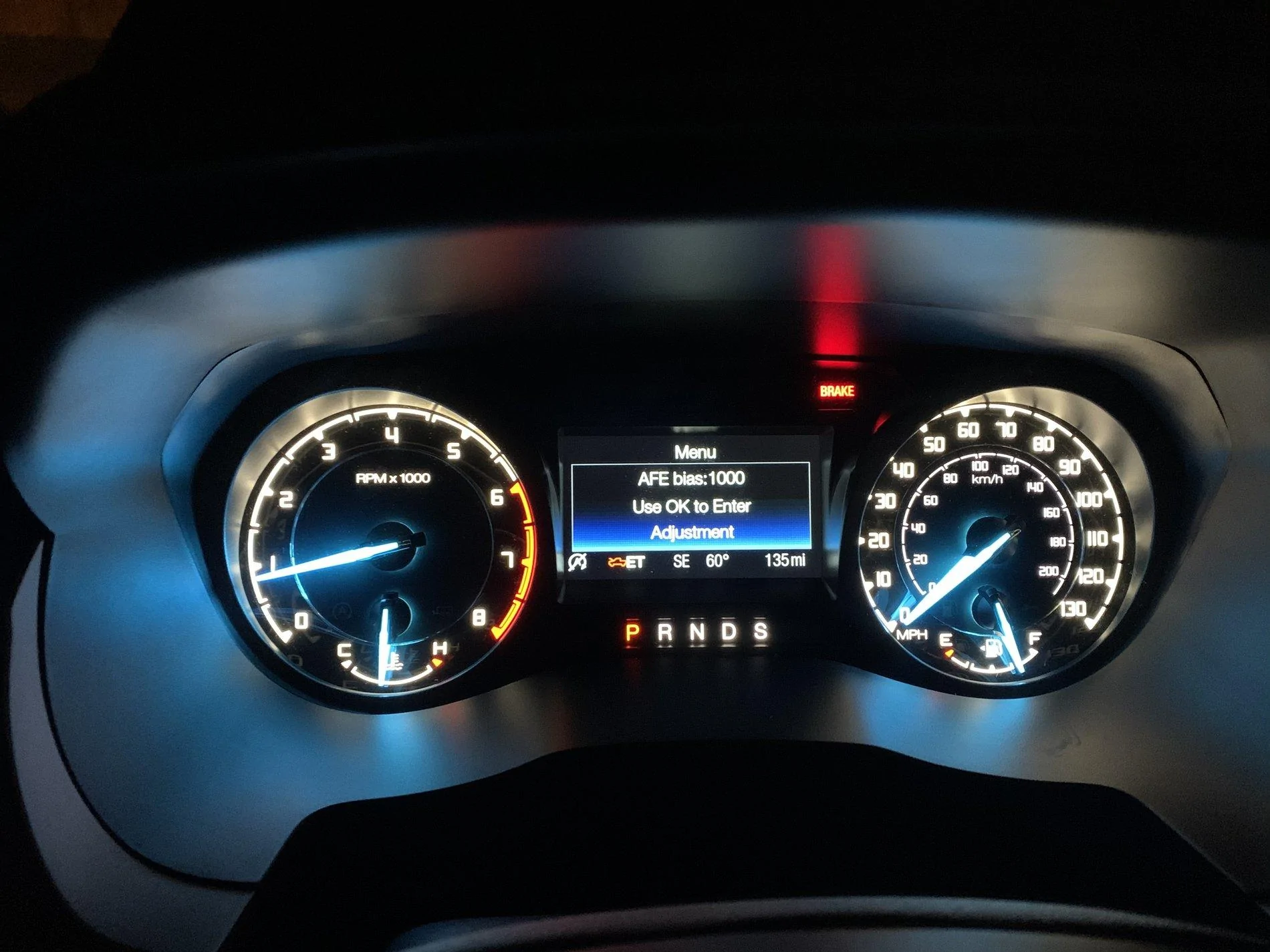

The most useful screen is AFE Bias. That 1000 number can be adjusted up or down to correct errors in the economy display.

Electrical Engineer

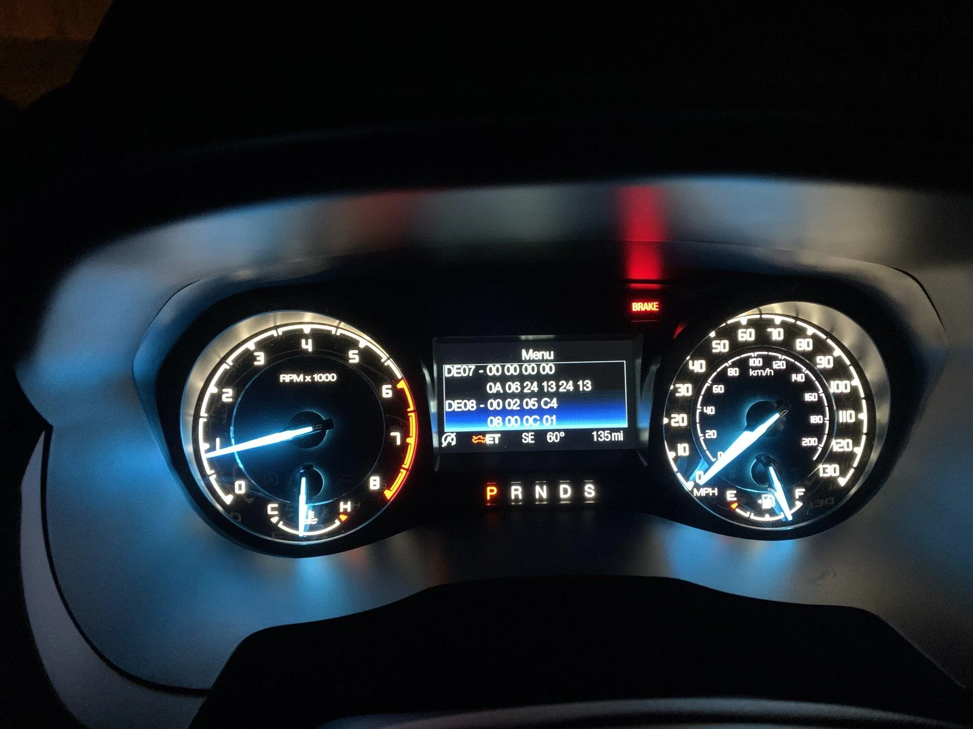

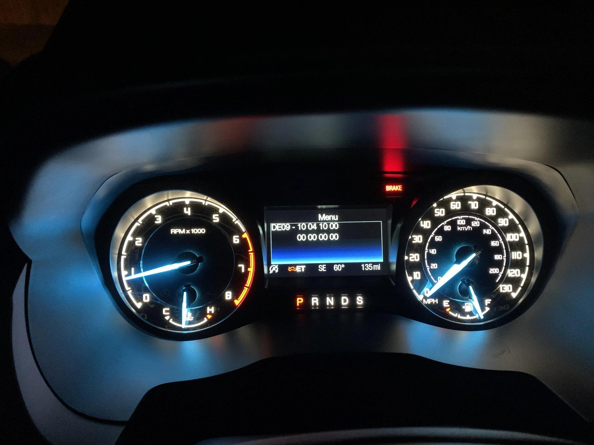

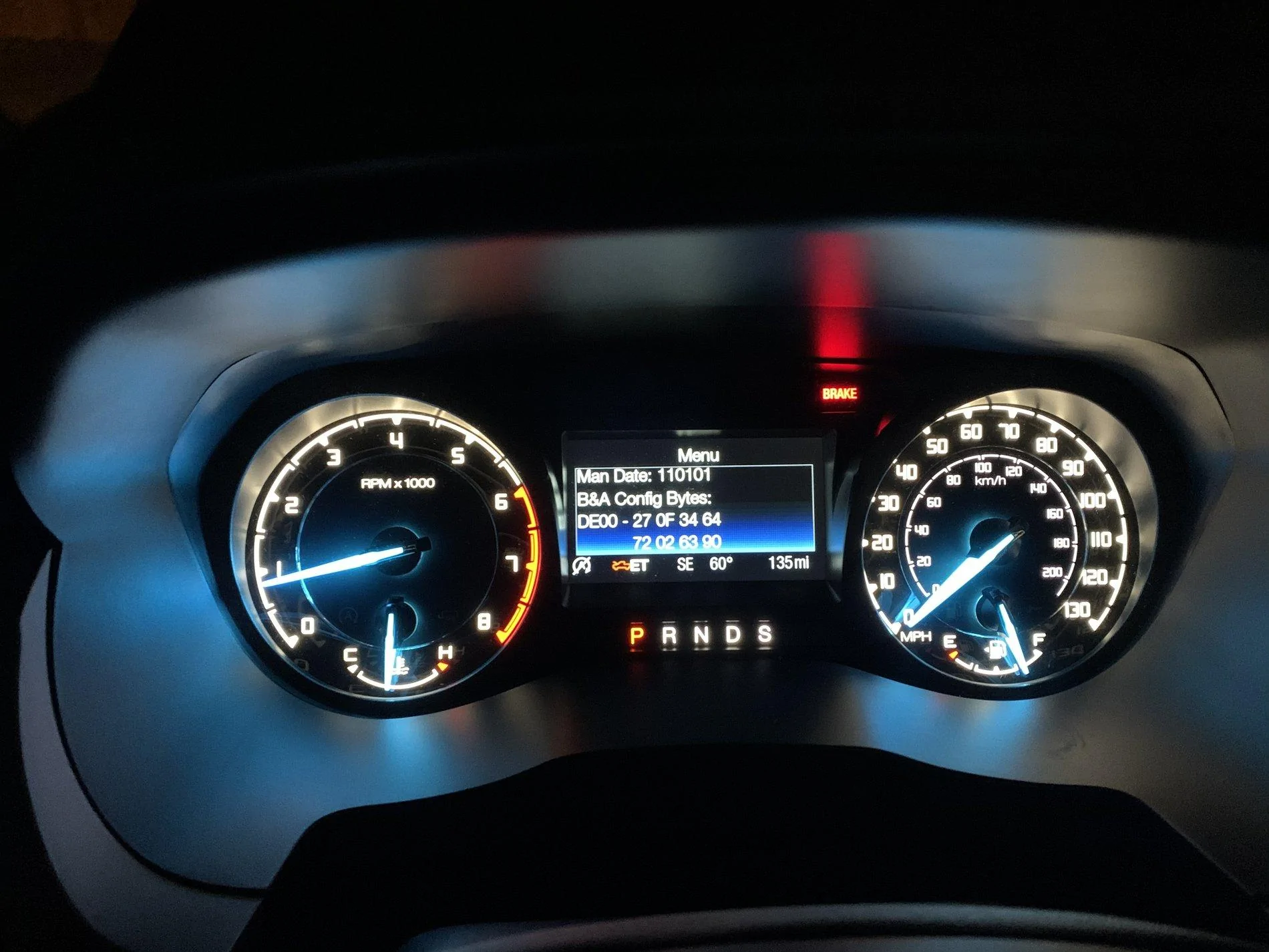

does anyone know if the register addresses DE00 - DE09 correspond to the feature addresses in the ForSCAN thread?
