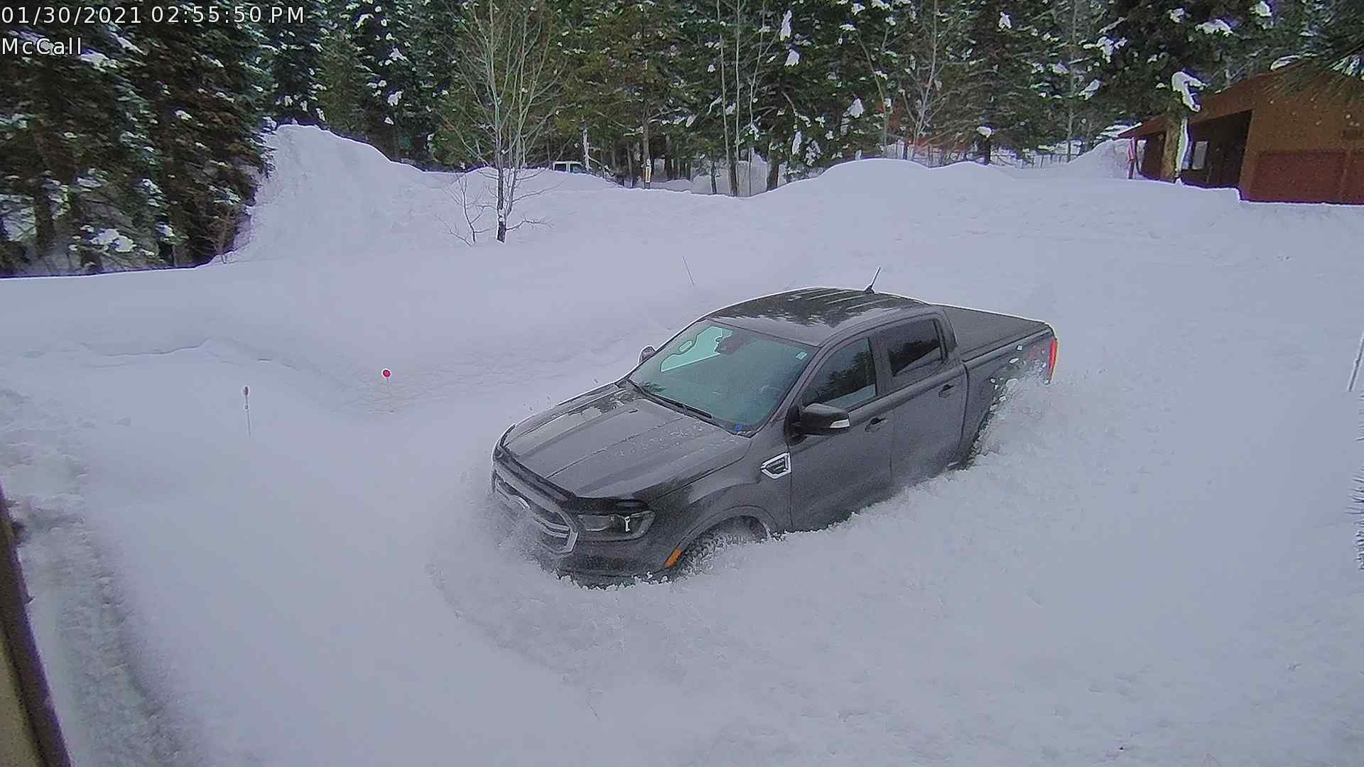

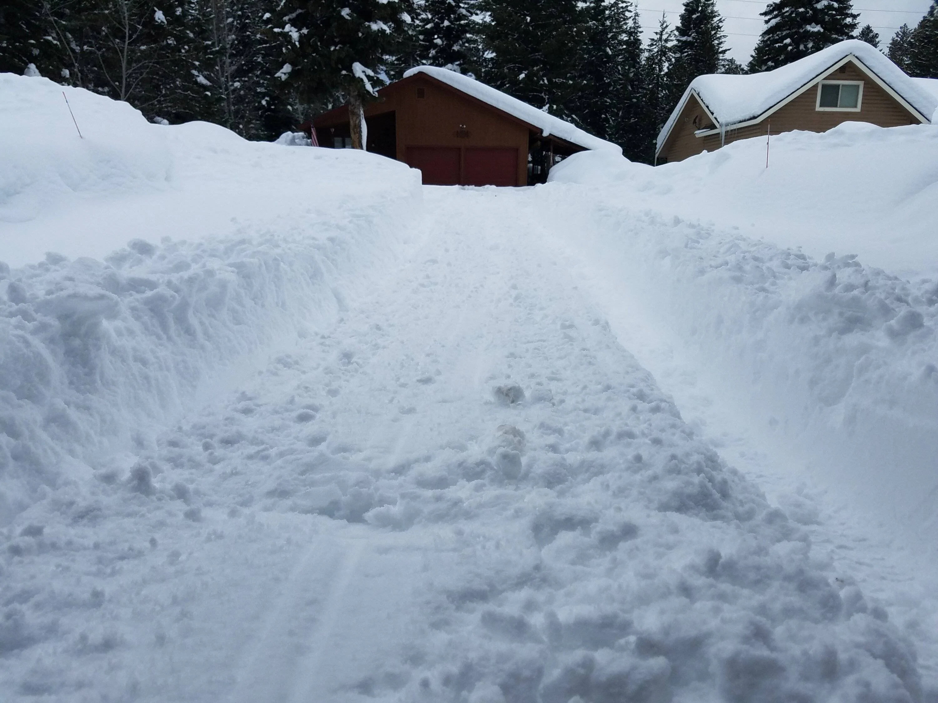

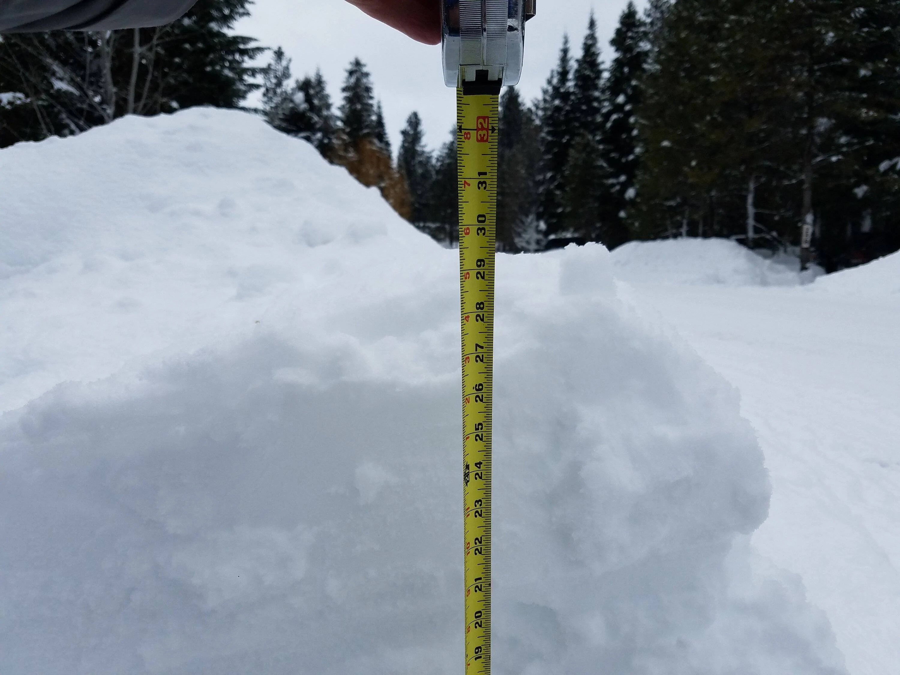

IdahoRanger
Sep 26, 2019
3,132
15,123
Idaho
2019 Lariat SuperCrew FX4
RETIRED
I'll use it carefully. Probably only in deep snow getting in and out of the driveway. Thanks!
It just happened to be in the truck I bought. If I ordered one. I probably wouldn't have included it. I would have used the 420.00 option on something else.
Only used it once in the driveway.
