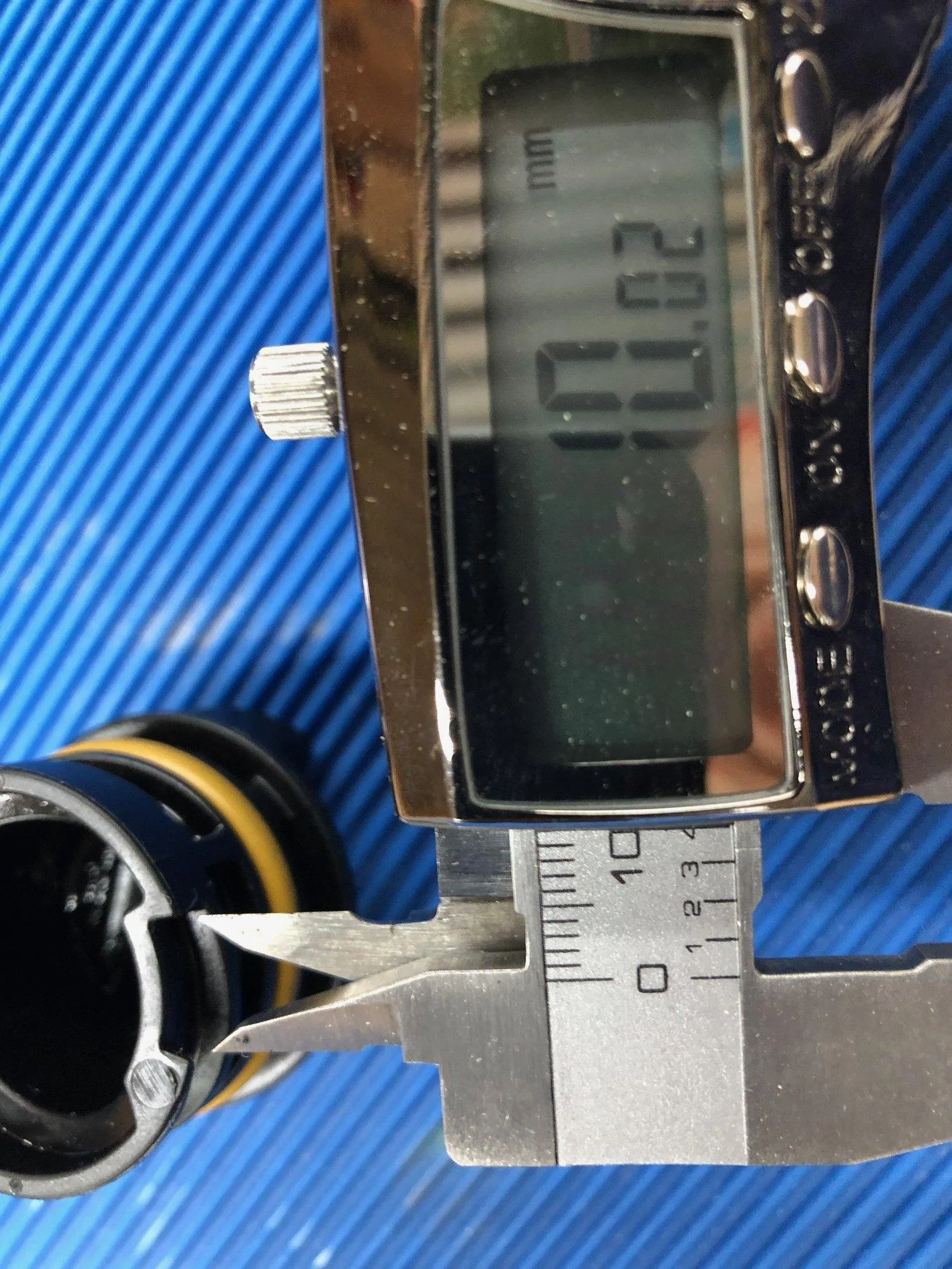

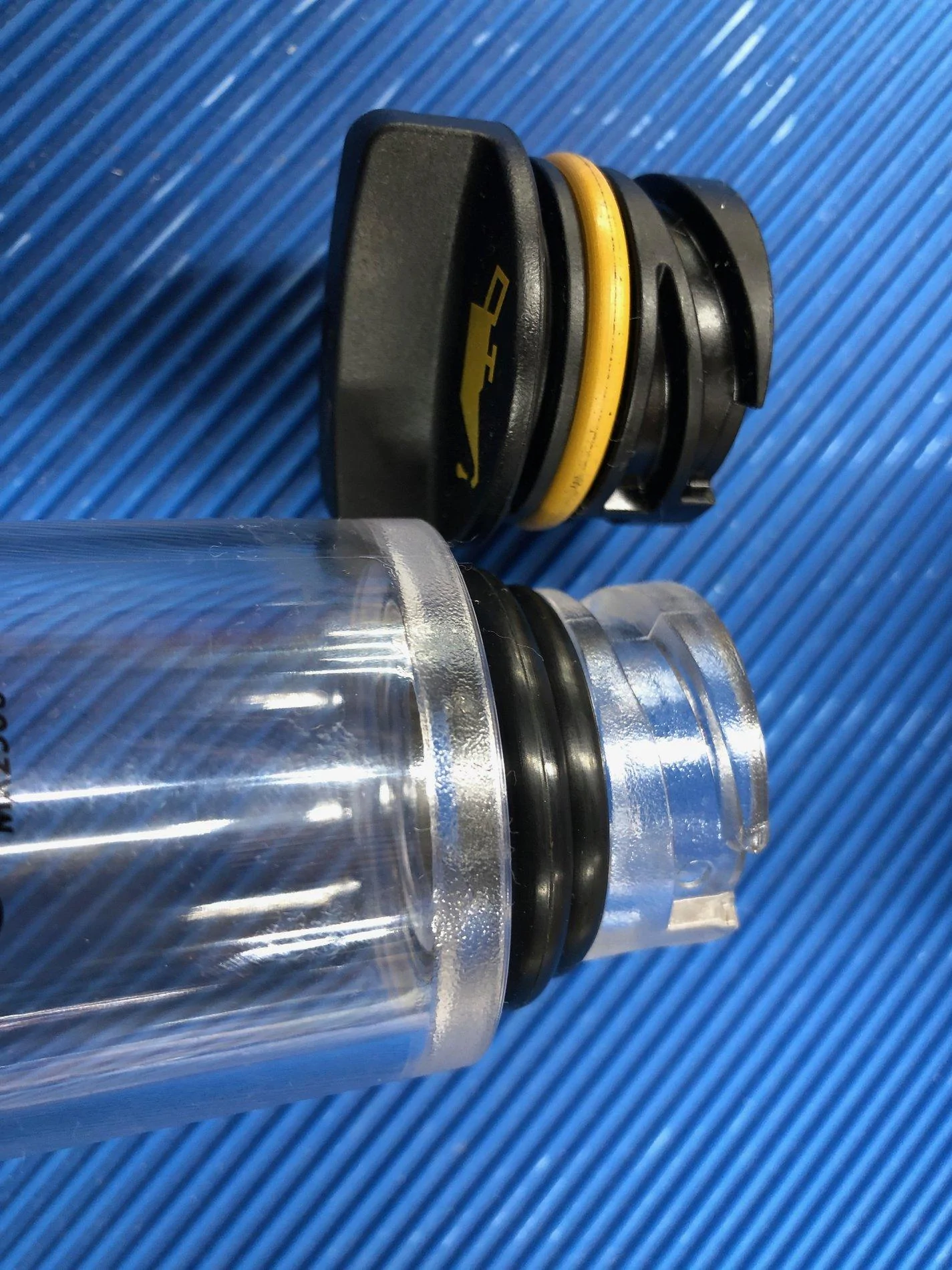

I removed my oil filler cap to use as a template/guide to make the necessary modifications.

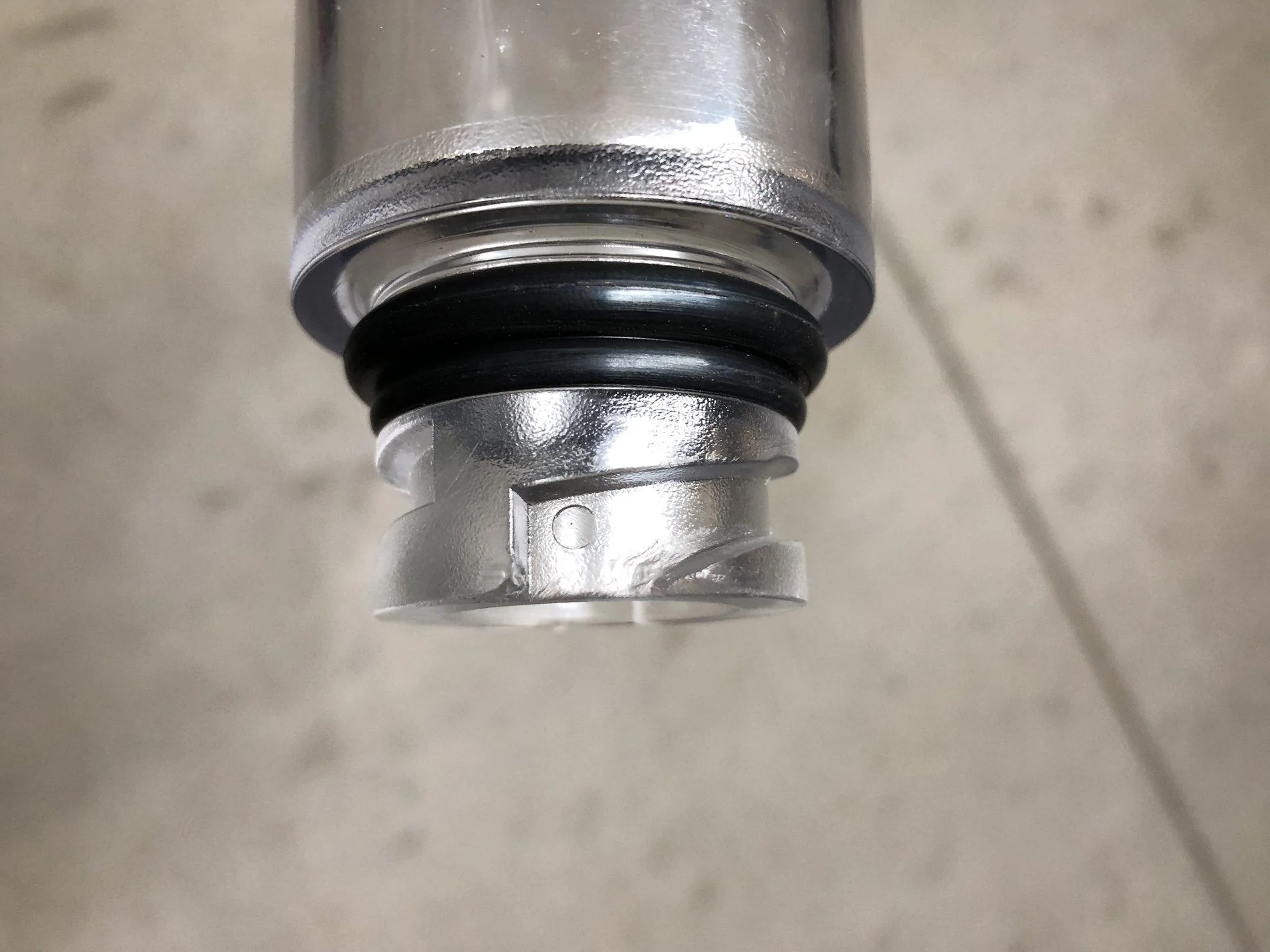

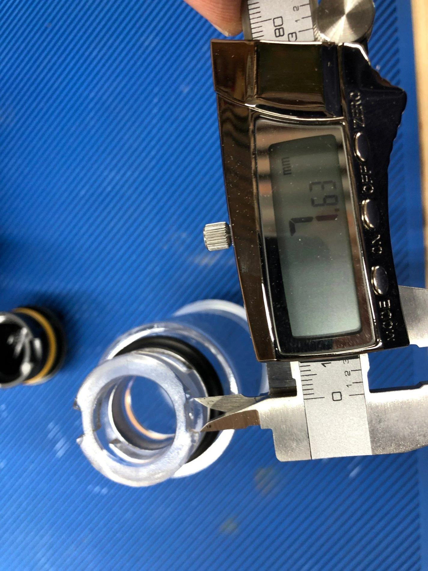

As you can see, the opening/patterns are pretty close, but the funnel does not screw into the oil filler tube on my truck. The problem is the thread-opening width on our truck's cap is wider than on the funnel. (why this would be different on our trucks vs. all other Fords, including older EcoBoosts.... only Ford knows!)
Using the filler cap as a visual guide, I used a number of different heads to grind/shape the polycarbonate with my FlexShaft. (A Dremel Tool would work too). In addition to widening the opening, I had to re-shape the thread to get it to fit properly. (the polycarbonate Motivx uses is basically bulletproof!)

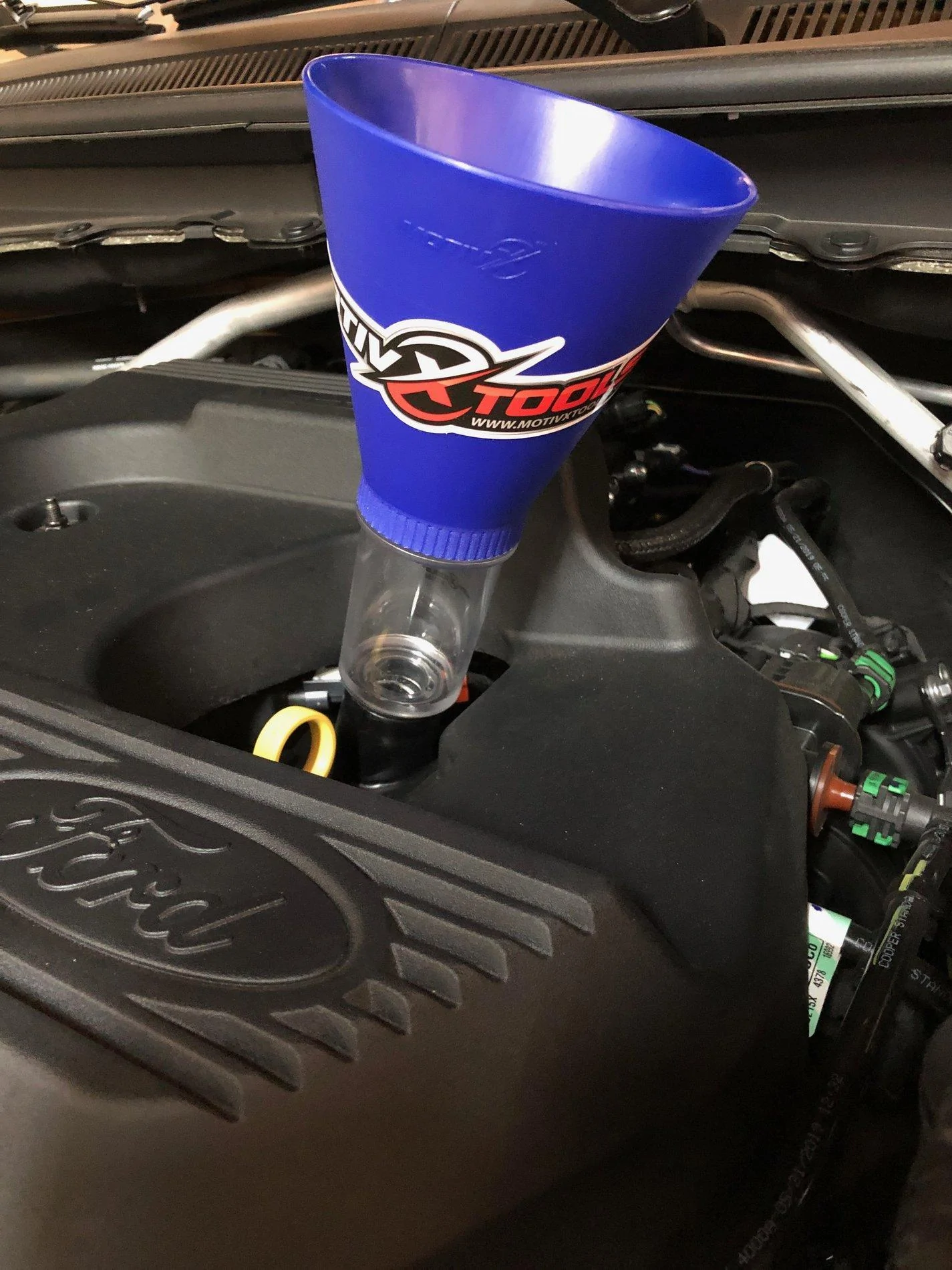

After about 10 minutes work (it took more time to walk back and forth from my shop to the garage to test fit!) it fits perfectly. The rubber O-ring seats nicely and the funnel will easily support a full quart bottle pouring itself.

I purchased the funnel that was advertised to fit all Ford and Mazda vehicles. It fit my 2019 Mazda MX-5 perfect but not my 2019 Ford Ranger. Opened up the funnel base slot with a rotary tool as you detail. Funnel now fits both my Mazda and Ford. Used the funnel on my recent oil change on the Ranger and it worked great. I have a 2 inch front leveling kit and need a step ladder to pour the oil. Using a 5 qt container, that funnel is worth every penny I paid for it since I didn't have to worry about a typical funnel moving or coming out of the filler neck.

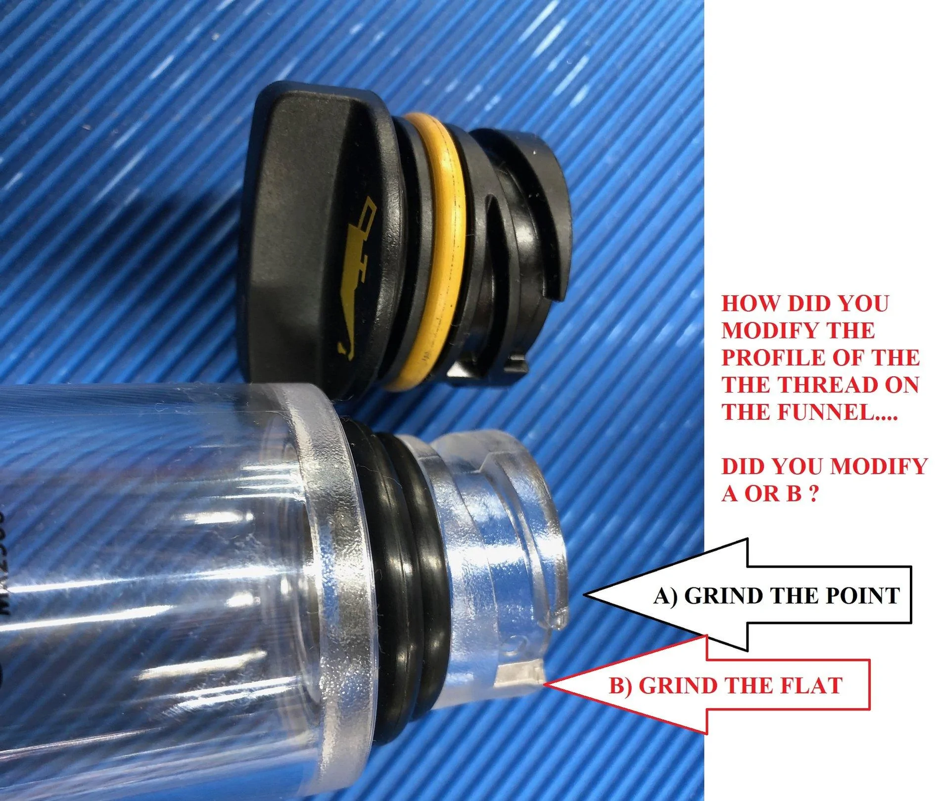

Hey fella's... can you post up a photo of your modified funnel threads? My question is which portion of the threads did you modify to widen the opening.... the point of the thread or the flat? See photo below. Thanks!

I actually did both. I shaved a small amount off the lip or point end as you describe of the funnel and then ground the flat width to match the oil cap.

Hey John, I did both as well.... but focused more on the threaded part "A", I opened up the gap and also modified the "slope" of the thread. (Does that make sense?)
Here's a photo, hope it helps:
