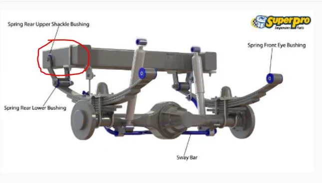

Did anyone with issue check if the leaf brackets on the frame are located correctly? Seems like a misplaced bracket on the frame could be a cause. or a bracket that is not correct length.....
talking about this bracket

Thanks, I'll check for that bracket. Just curious, how would this bracket lower one side if installed incorrectly. Sliding it forward or back doesn't seem like it would change the height.
BTW, how did you come across that diagram? I like seeing how everything is supposed to be installed.

Not saying forward or back....im saying up or down. Is mounting hole in frame off?
Is the actual bracket the same length on both sides???? If one was 1/2 longer or shorter.... would explain it.
Same with mounting hole in frame. If not located same on both sides......

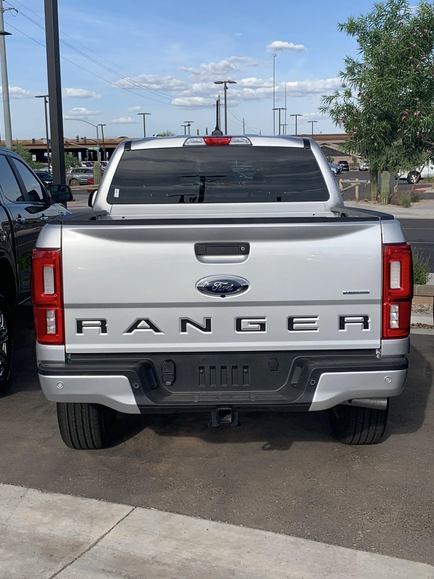

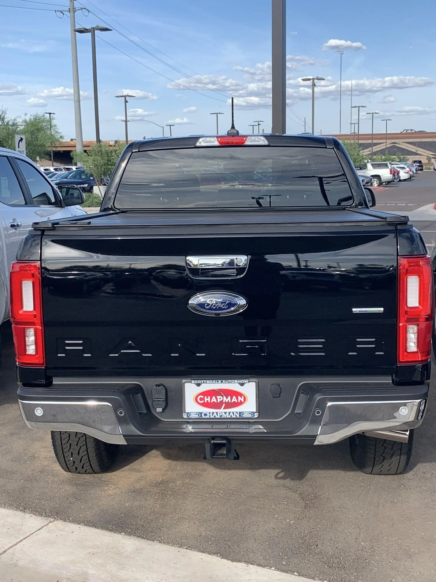

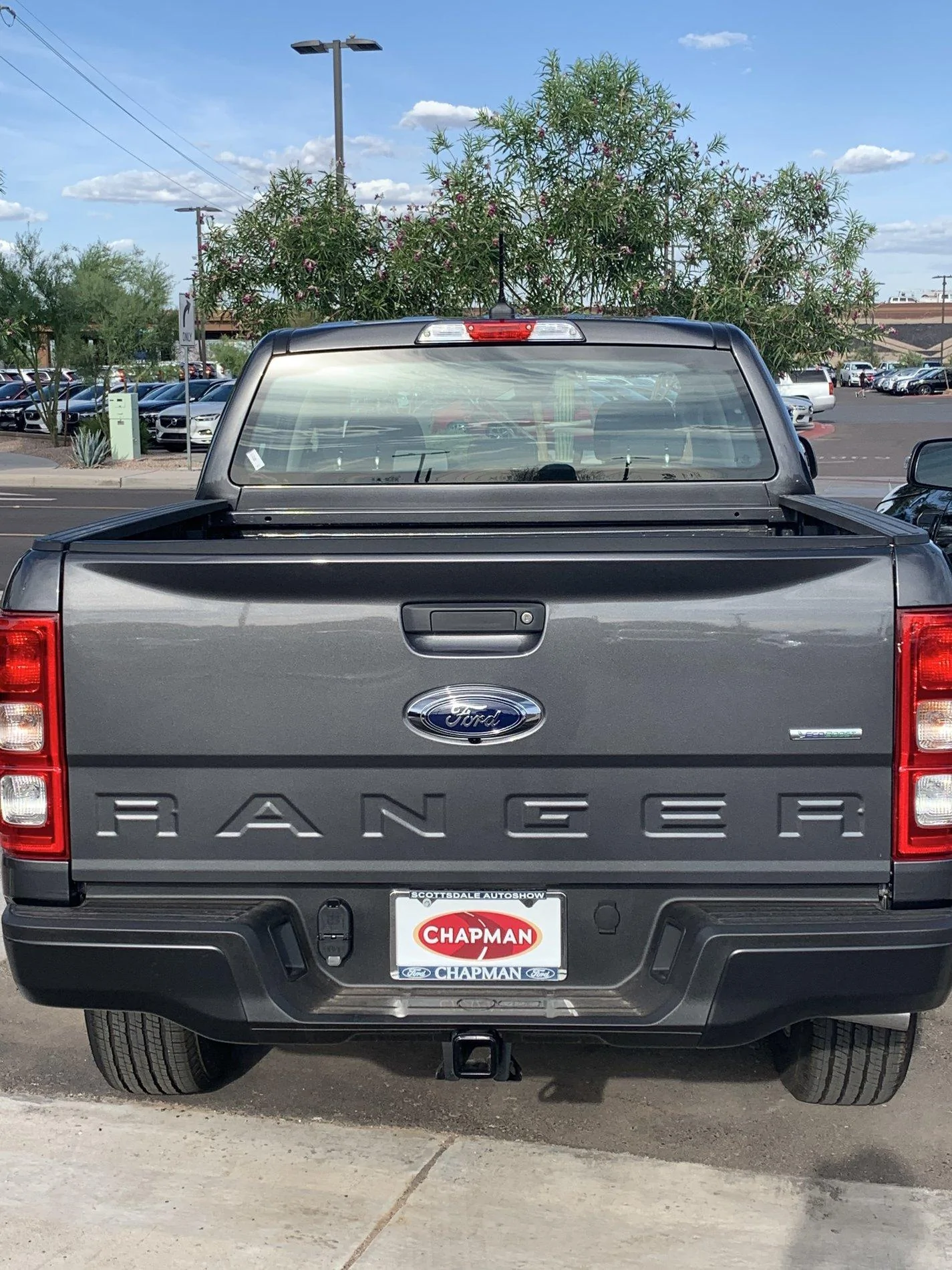

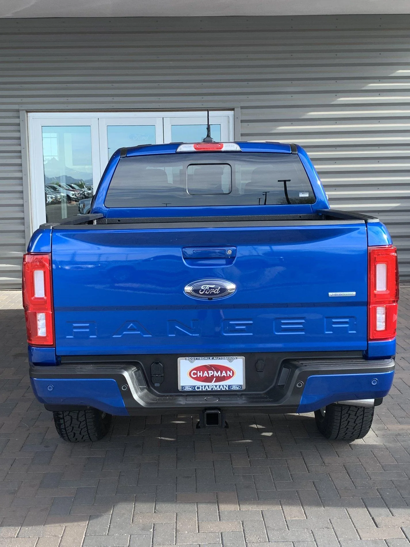

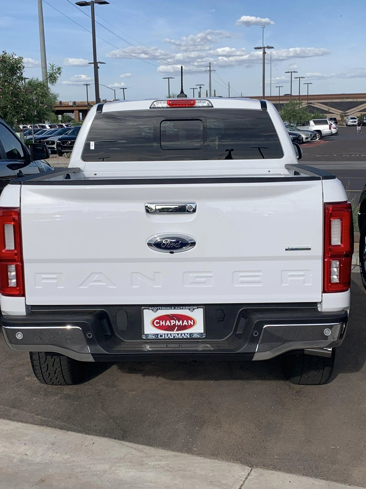

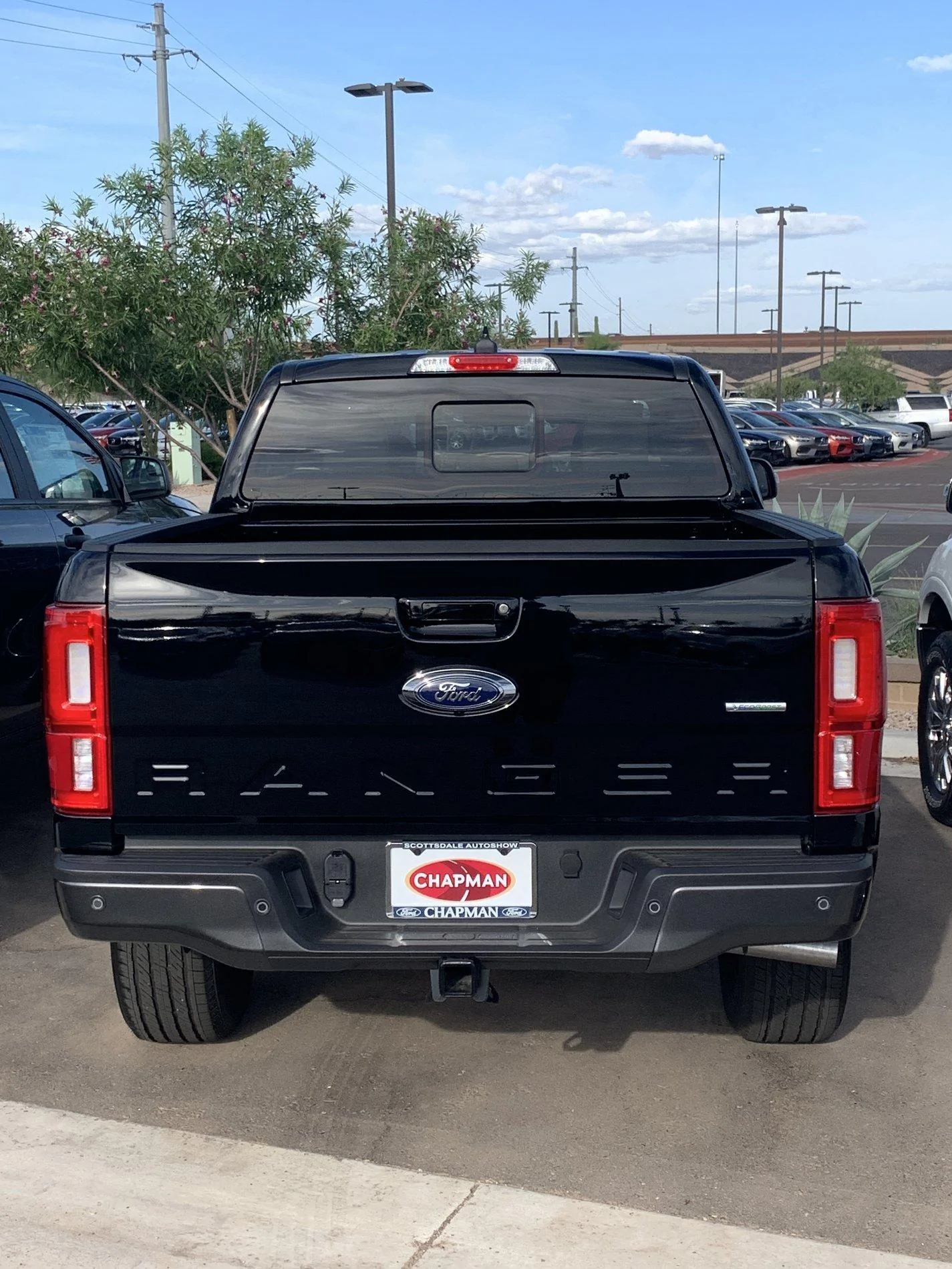

I'm going to go look at the Rangers at the dealership tonight, see how many suffer from this...
mike
Nov 8, 2018
287
219
Hawaii
2019 Ranger Lariat Supercab, Nissan Rogue
Thought? It is hard to tell from the perspectives and shadows. Looks ok to me.... not even close to how jacked up yours was. should have brought your tape measure.
PonyXpress
Feb 18, 2019
260
165
Sacramento CA
Not easy to tell from the camera angle, but those trucks all look ok to me
Truckguy
Jake
Mar 10, 2019
Az
2006 Ranger
Hard to tell, need the measurements
