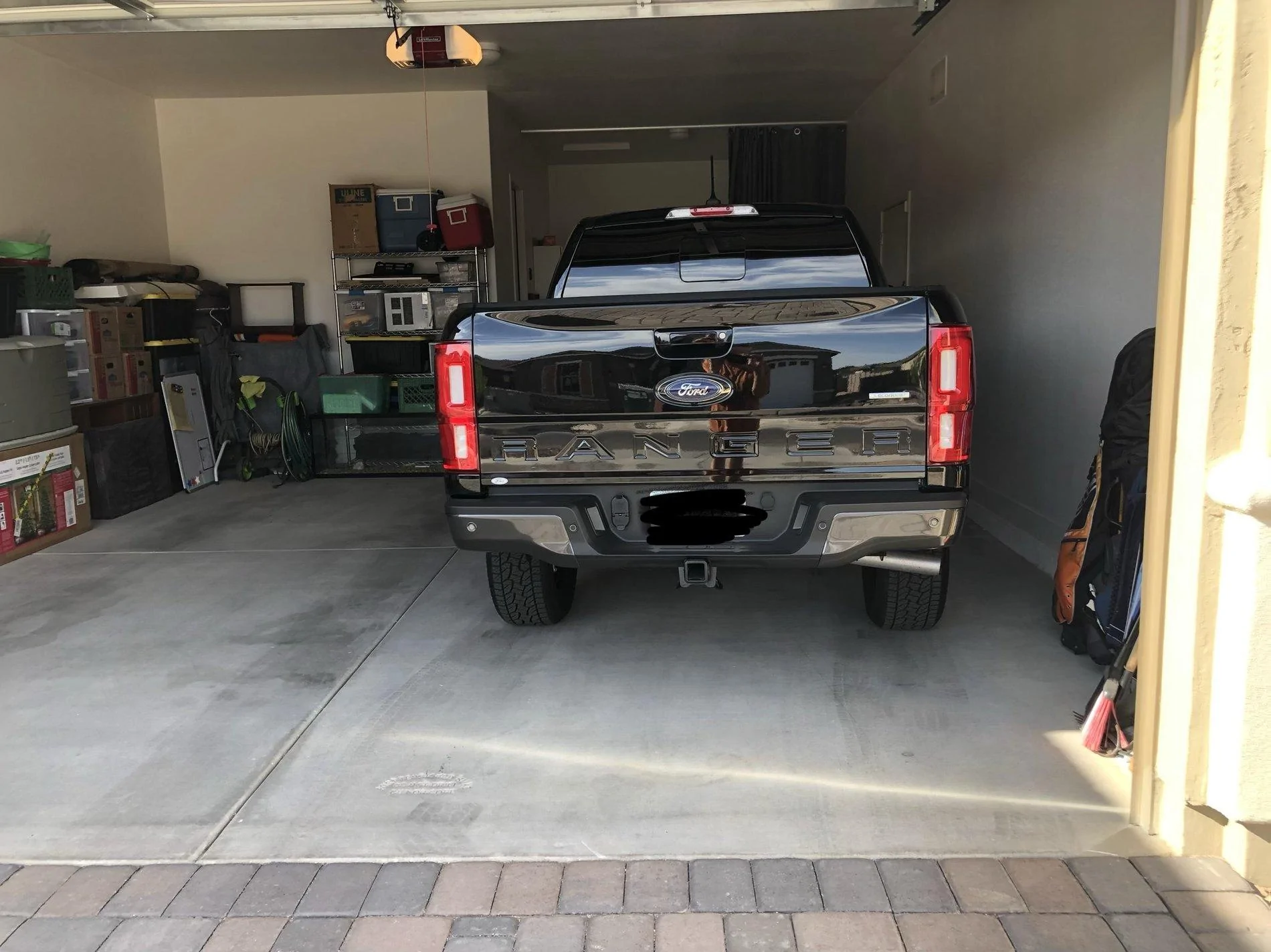

Check it out from the back, you can tell the front left is lower

Fuel tank is on the left.
Could be the upper control arm on one side is out of whack...that’s really weird..did you have a leveling kit put in?

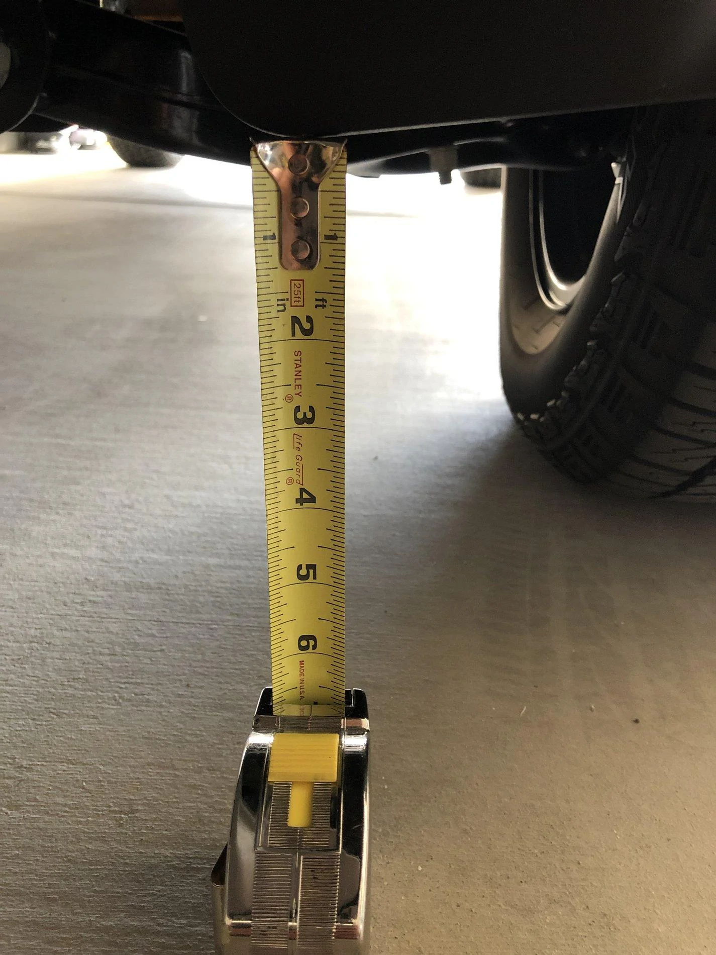

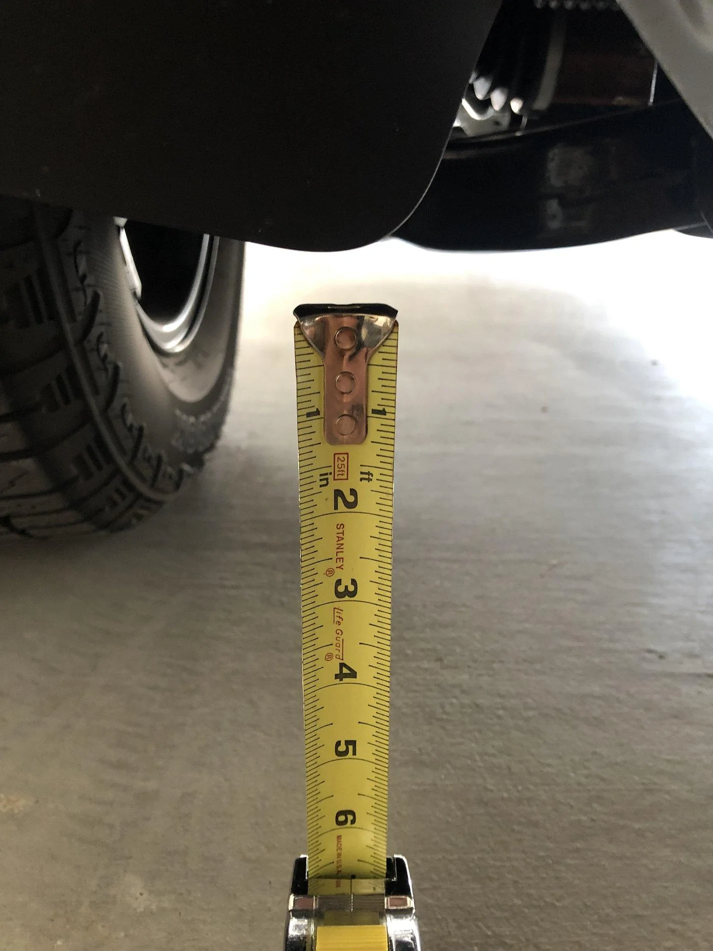

As Pioneer said, is the tire pressure good? Then measure from wheel hub center to bottom of fender well on both sides. Good luck,hope all is well
