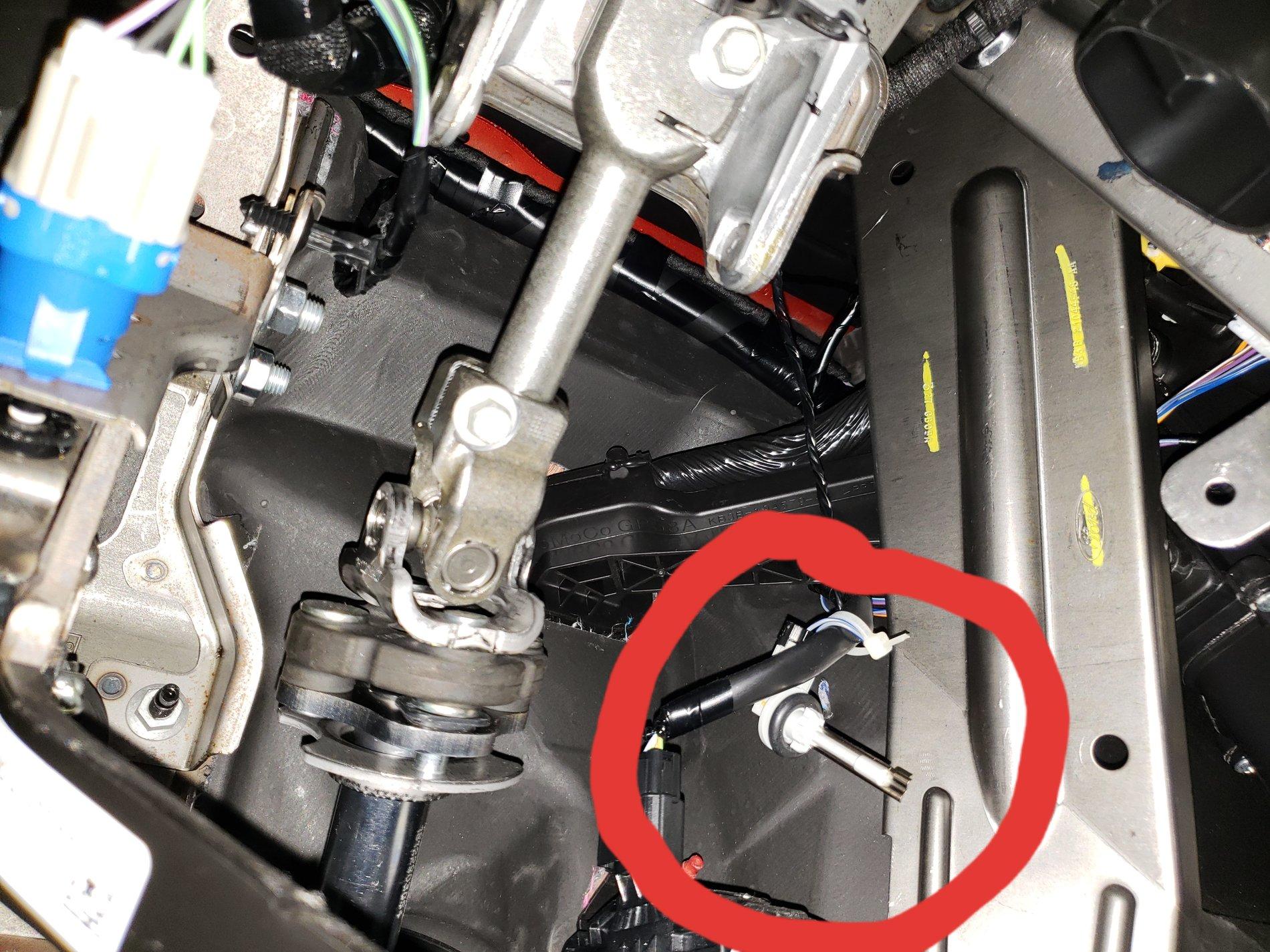

Hmm, curious if that'll throw off the climate control stuff. I'm guessing that's a thermistor

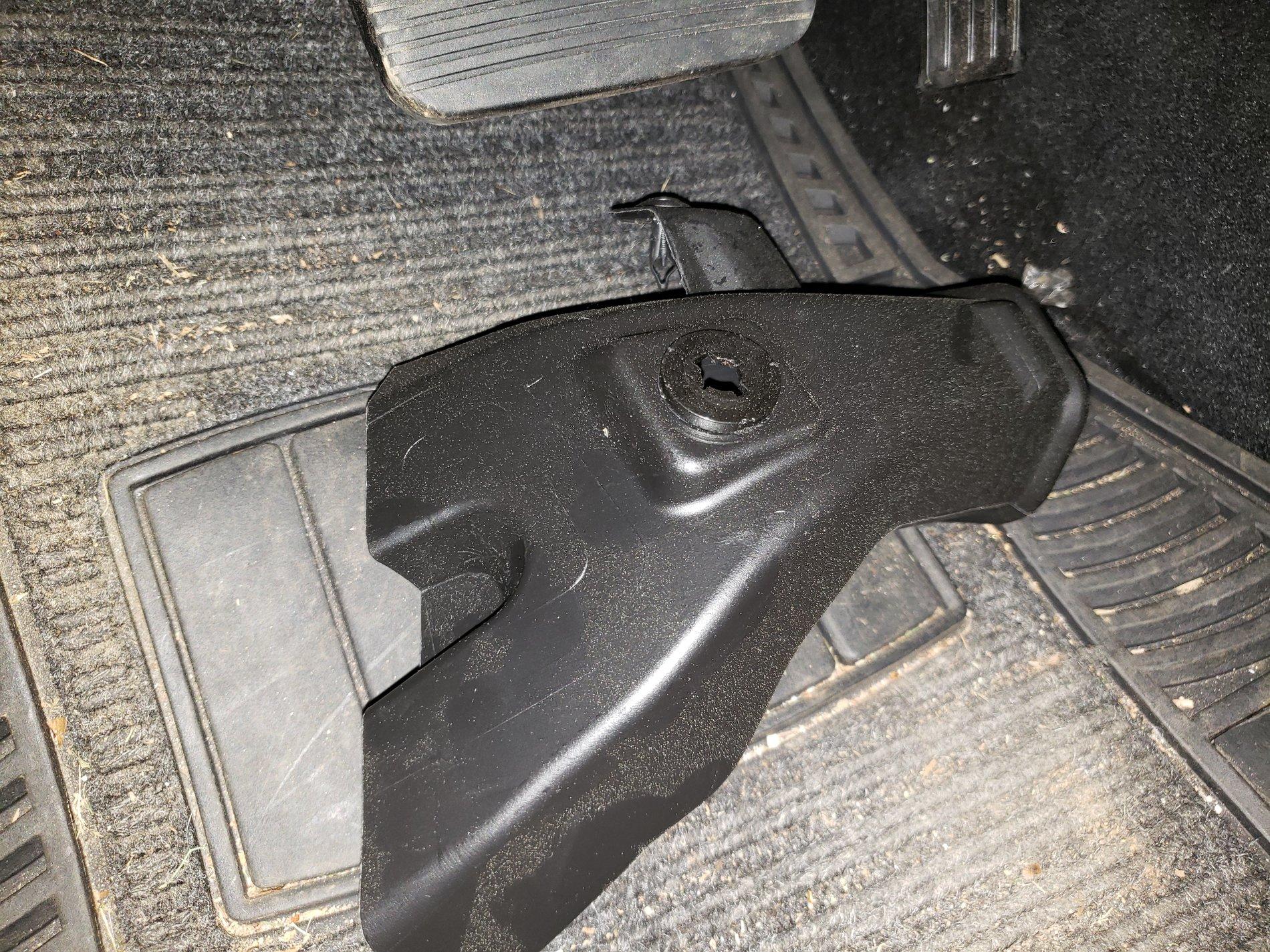

I thought I was the only one with this problem, with my Sideshow Bob feet. The way I was able to alleviate this problem was to order the vent (part number KB3B-18D277-AB it comes with the sensor for around $20 dollars) and cut about 2 inches off the bottom. It is a little tricky to cut due to its odd shape (see my zigzag cut below), but I have had no problems since.
Hope this helps.

Any reason you ordered a new one to cut up rather than trimming the factory? Just to have a full spare to put back on?

It was just in case I messed up and broke it, I would have a spare to replace it with. The part was fairly inexpensive as well, so I didn't mind purchasing a second one.
