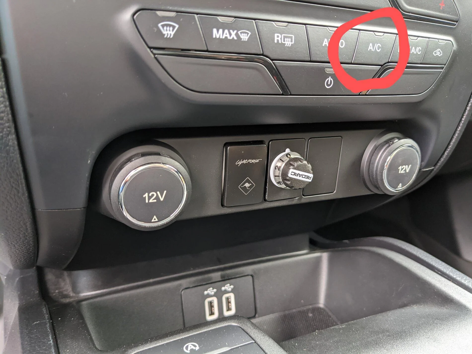

Just curious, what blue indicator are you talking about? Maybe a picture? Can't think of anything you would do in the BCM that would affect climate control. That would normally be in the APIM. Might be something not related to what you did in the BCM. Could be a dealer issue, stuck/failed blend damper etc.

Just wondering if you made sure to turn off the AC before trying to turn up the temp?
