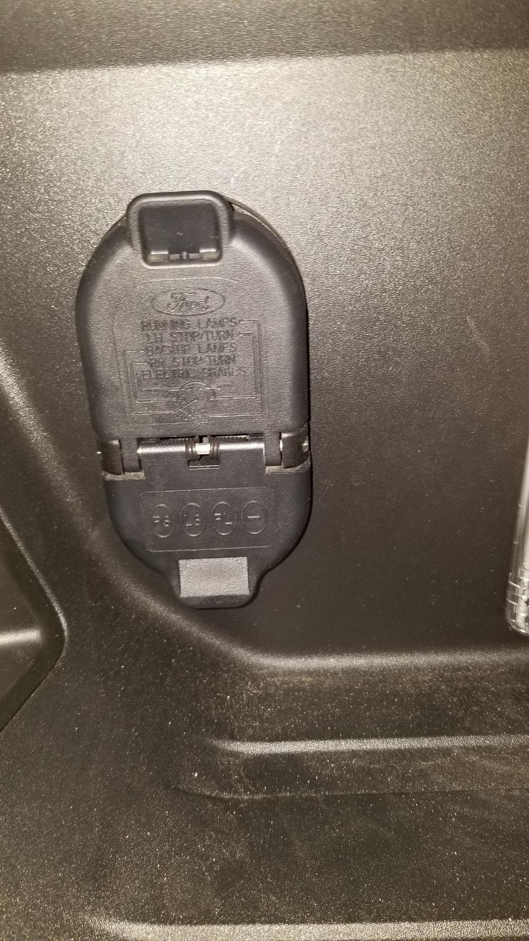

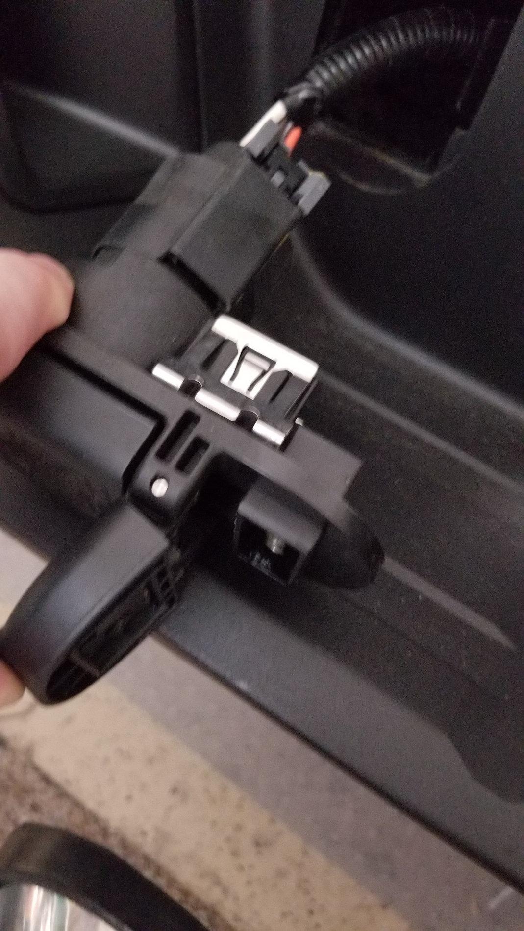

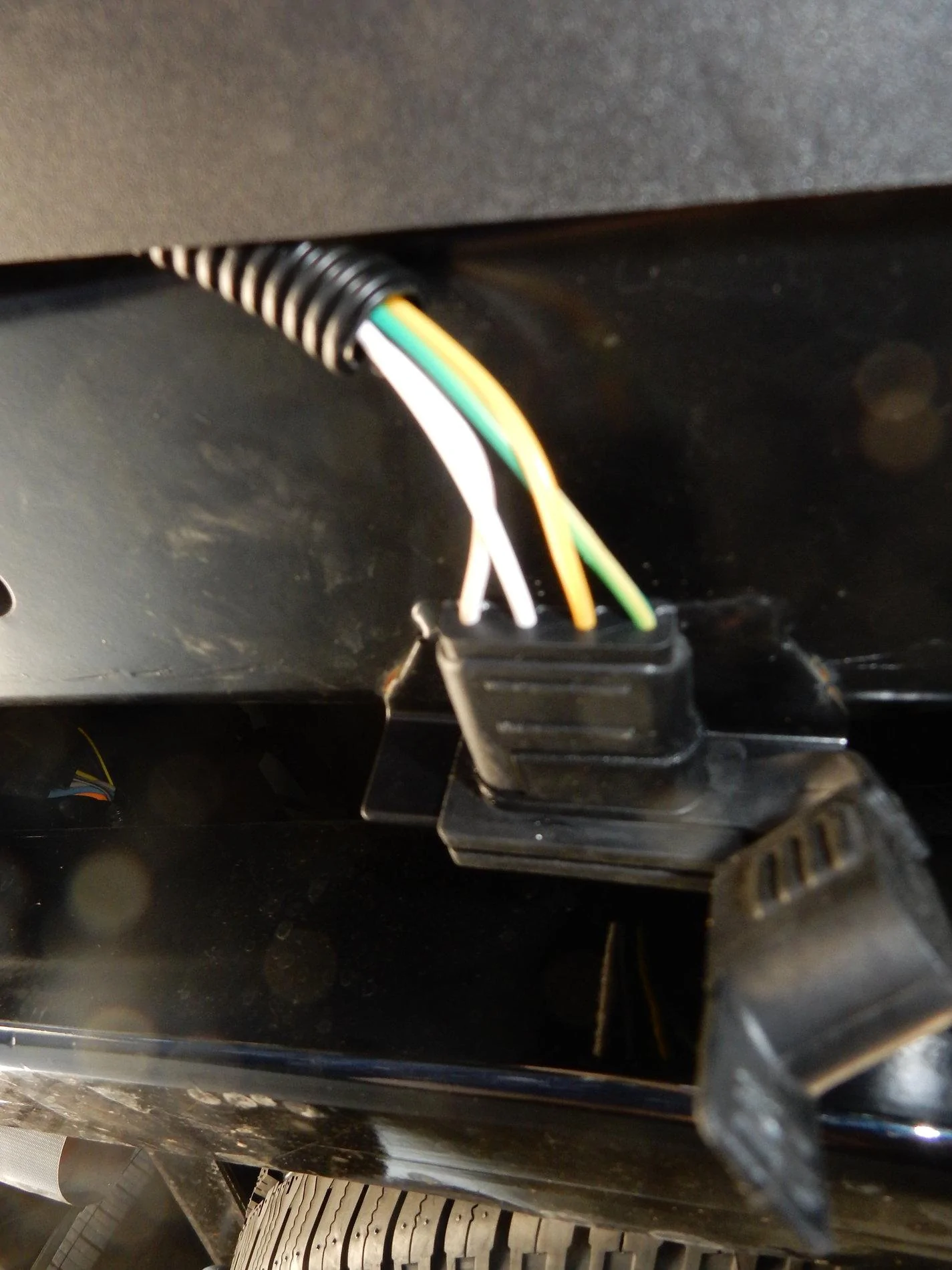

The tailgate light bar wiring harness has a inline protection fuse and a four pin trailer connector for the already installed 4 pin trailer connection on the 2019 Ford Ranger. If you are already using this fixed connector for your trailer you might need to purchase a 4 pin Y cable harness or just disconnect it when using a trailer.

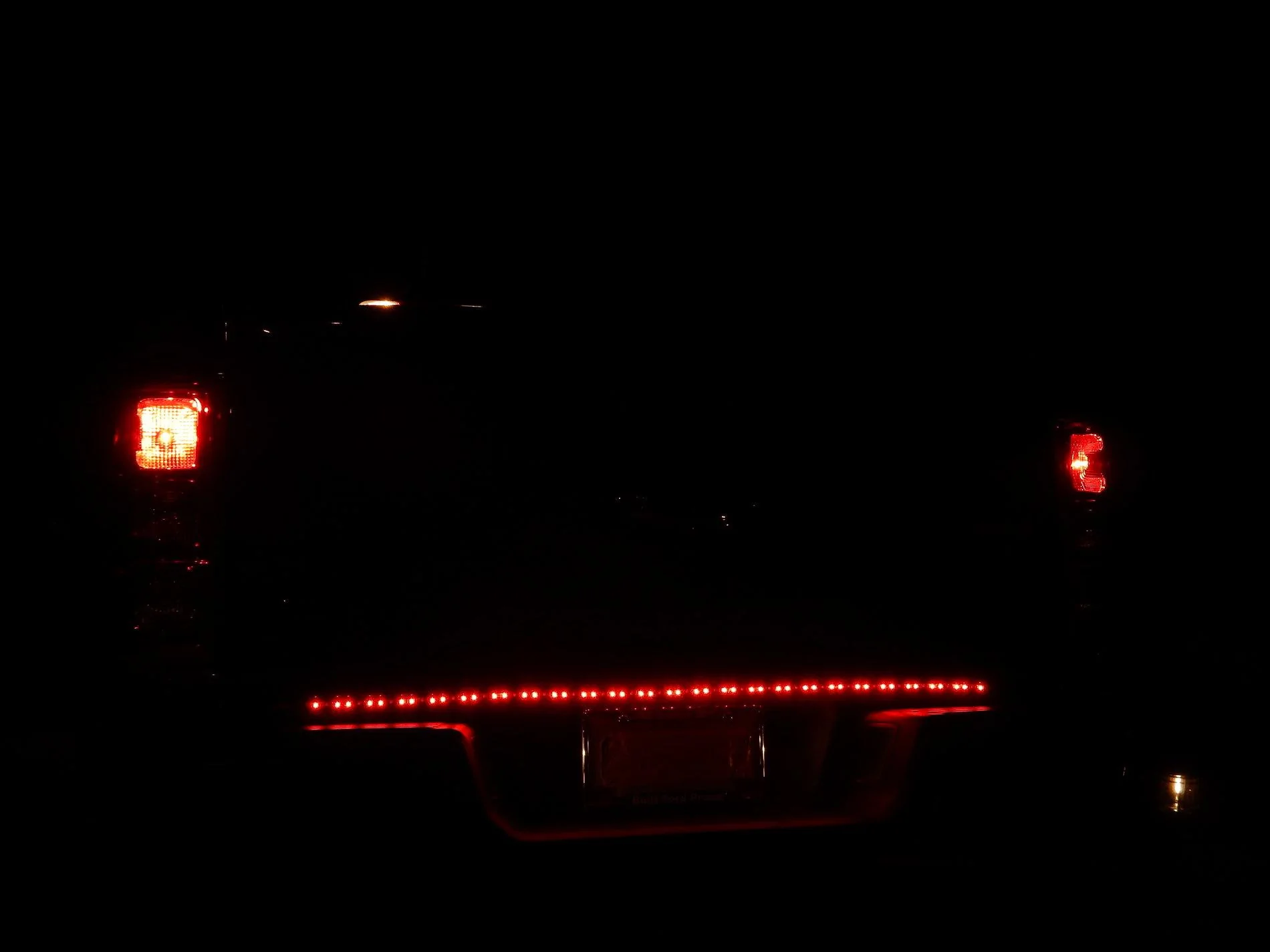

The tailgate light bar lights when:
Running lights - full tailgate red bar (steady)
Left turn signal - 1/2 red bar flashing
Right turn signal - 1/2 red bar flashing
Reverse/backup - full tailgate light bar - alternate red & white (steady)

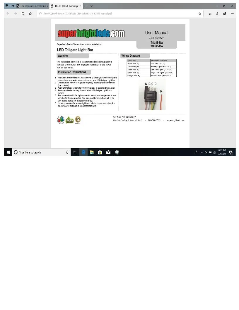

Installation tips:
You need to splice into the reverse/backup lights wiring for reverse or backup tailgate lights to function. (optional)

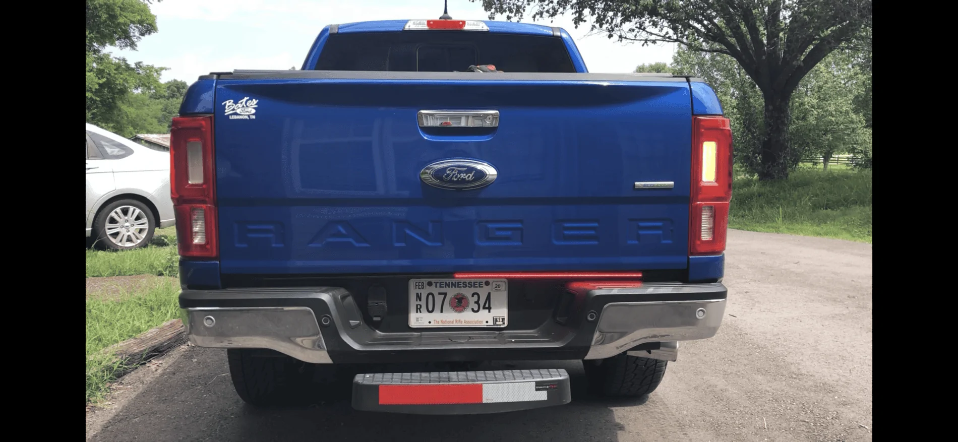

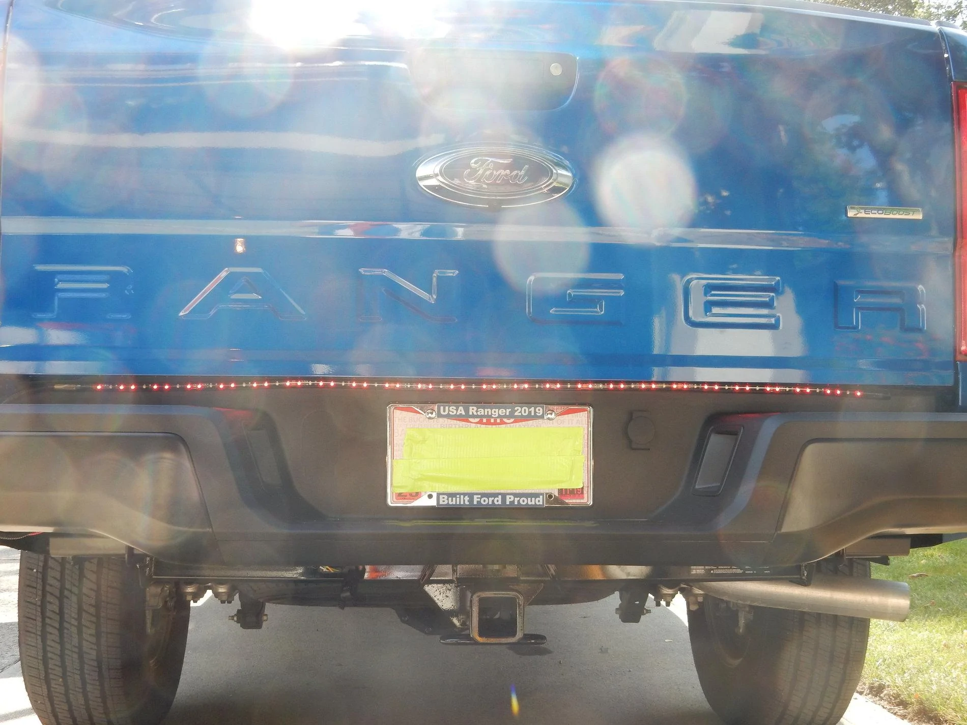

After you do a full tailgate light test simulation "before" to see if all the LED light bar functions and after centering/marking the light bar on the bumper vinyl just remove the tailgate for easy tailgate light bar installation.
(First - always double/triple check your clearances with the tailgate up and down!)
Definitely use the special 3M "foam tape" adhesive promoter to help "weld" the tailgate light bar foam tape to the bumper without fasteners. (You only have one try to make it right - good luck)
For a professional look - tidy your wiring with flexible plastic hoses and tie wraps.

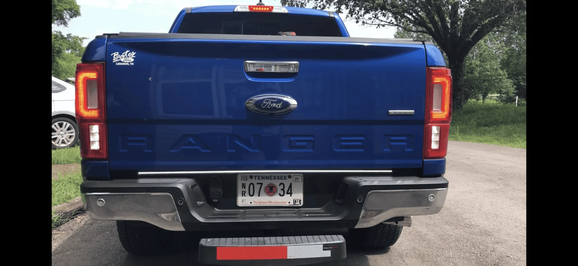

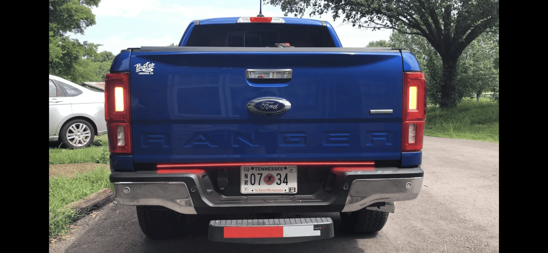

The picture, is bad, due to the fact it was taken in broad daylight and the shiny reflection of a highly polished Ford Ranger. At night time, the light bar is awesome.
