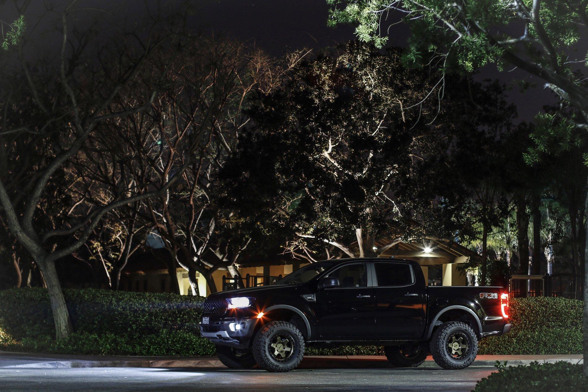

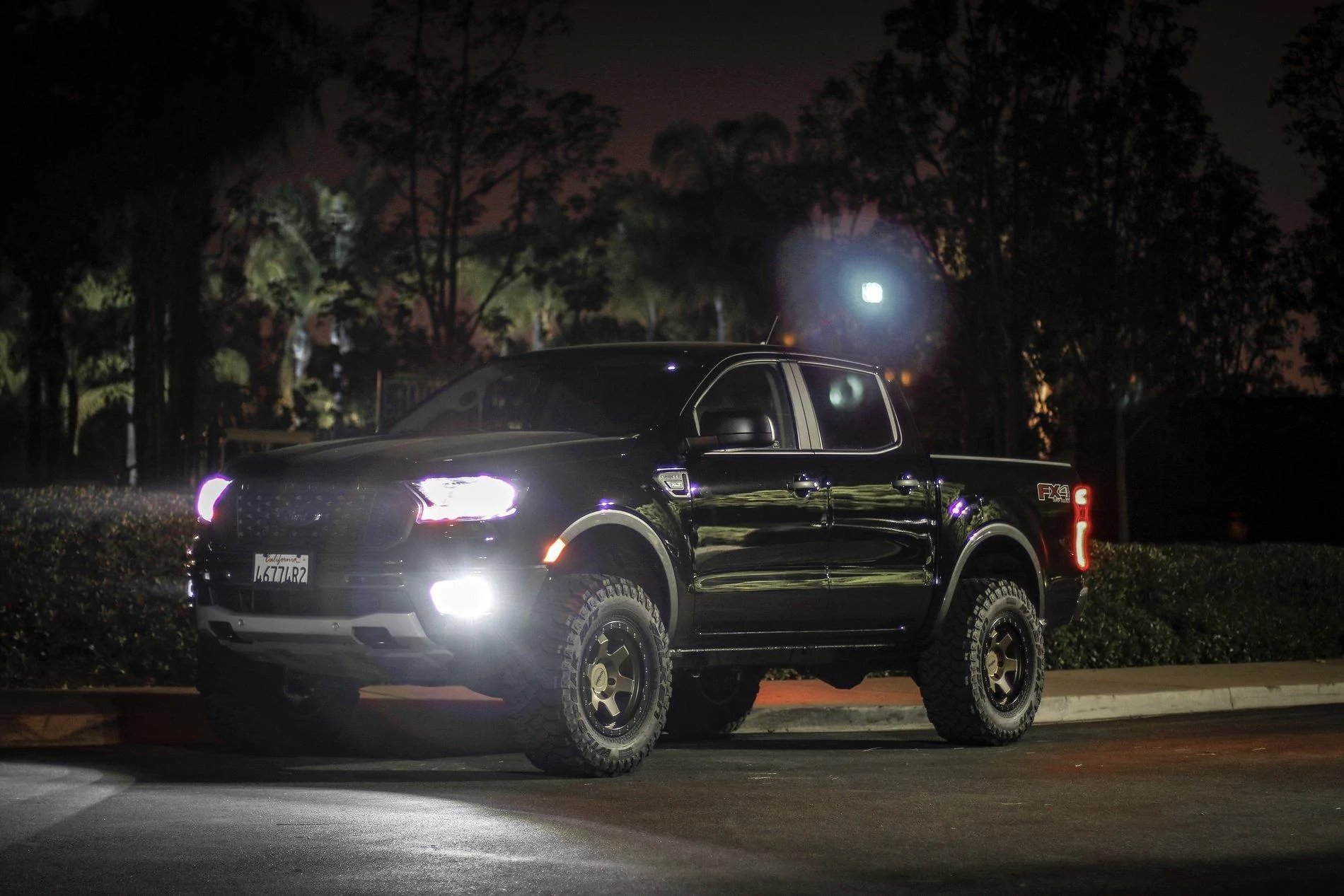

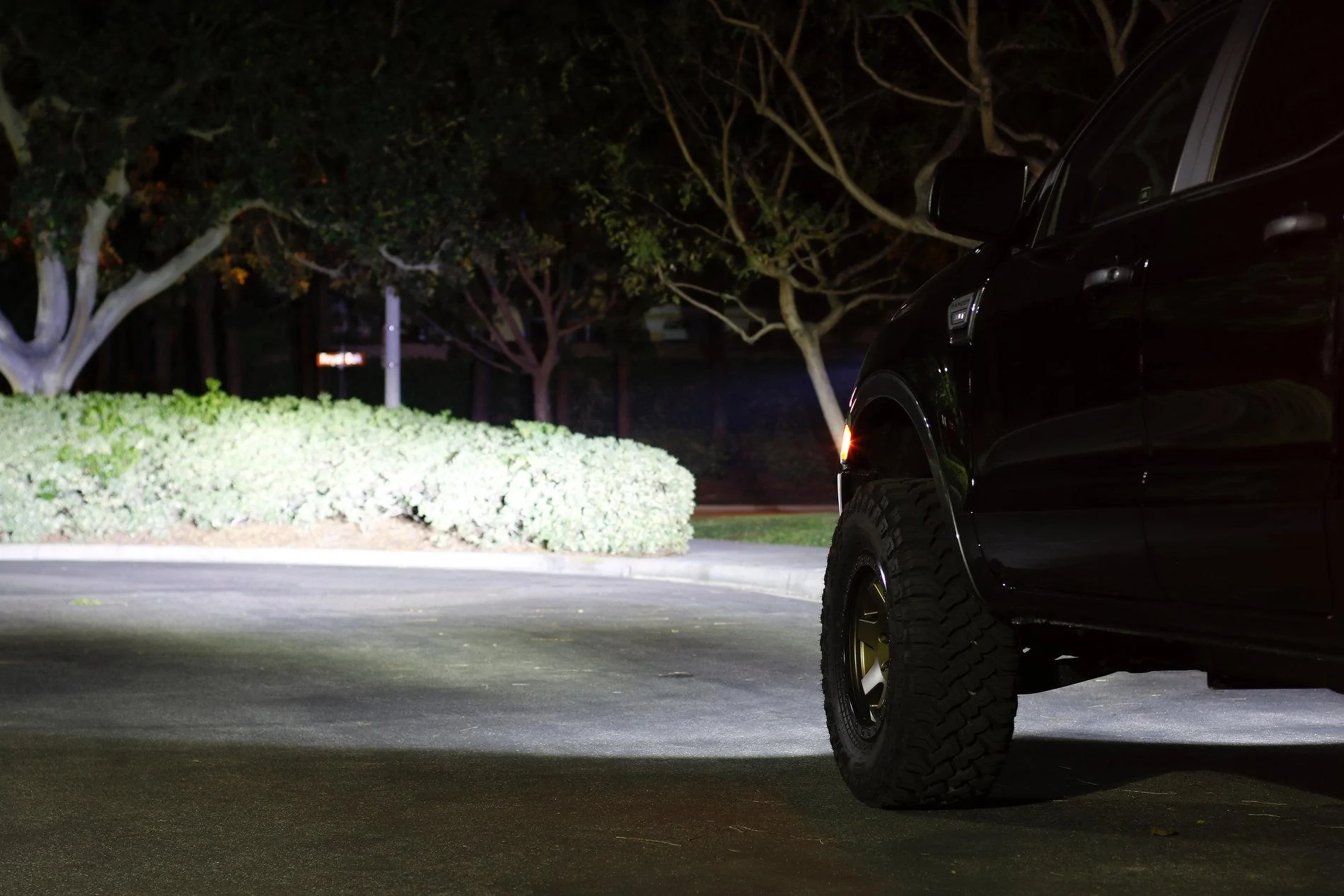

Here are some more photos to give you guys a better idea of how it looks and how bright they are.

Some photos taken so you can see the color of the light and the performance of the LEDs
