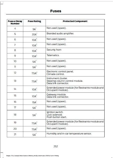

So over on the Mustang 6G forum a GT350 owner figured out which fuse to pull to disable the 4G modem. There's a 5 page discussion (so far).
Link - https://www.mustang6g.com/forums/threads/4g-modem-disabling-instructions.146860/
In a Mustang it's fuse #10 in the passenger compartment fuse box and it's a 5A fuse labelled "Telematics". Those that have pulled the fuse don't seem to have any side effects at all.
Looking at the Ranger manual it's fuse #9 and it's 10A.
Probably worth a try and if there's no side effects it's way easier than trying to remove the modem or disconnect it.

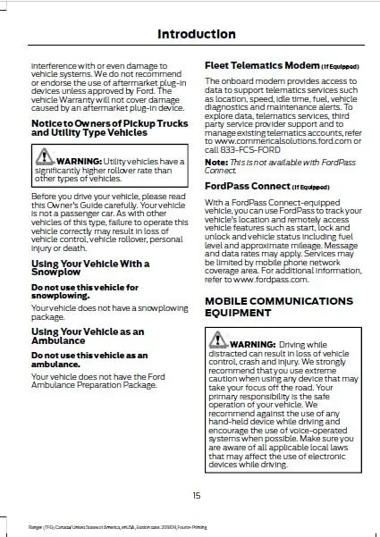

Seems easy enough... has anybody tried this?
And if you did, how did you confirm that pulling the fuse actually does anything at all?

I did this, and i think it worked because a fault code appears (not visible on the dash) that communication with telematics is lost.
Unfortunately wifi is still On, and i can't figure out how to turn it Off.
