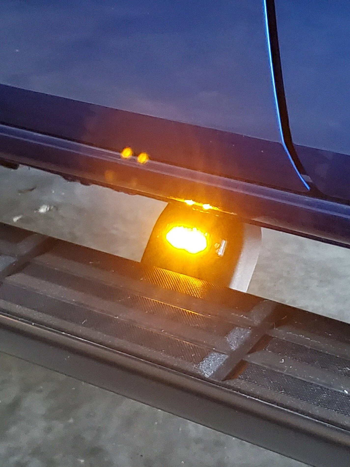

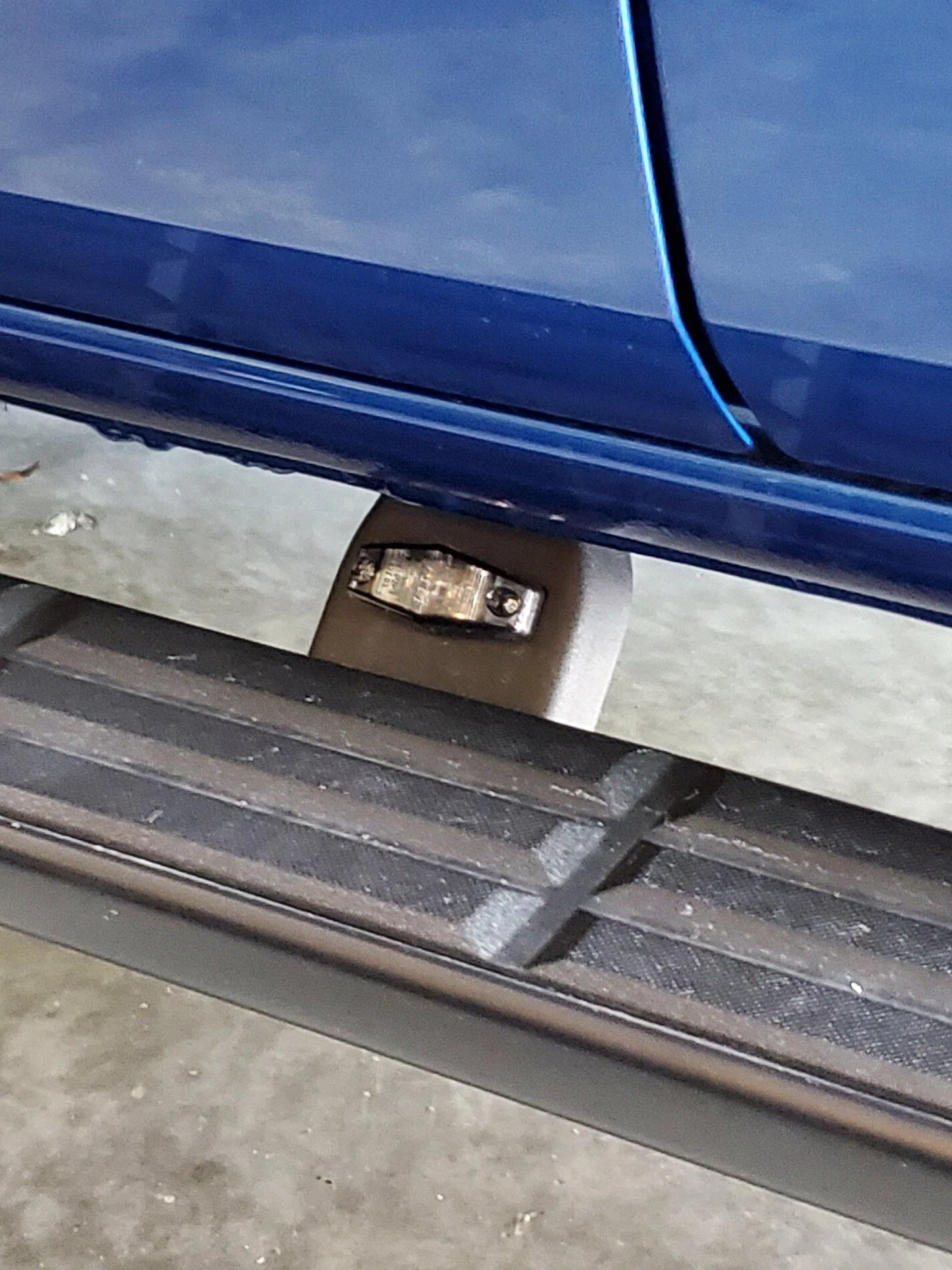

added some LED running board lights...

Yes,yes! This is fantastic. Would Like to know how you wired i and which lights you have. I can easily see this as my next mod!

Looks good John - where did you wire them to? Side markers?
Yes , just pop out the front marker light (you tube it) and splice into the wires. I ran the wires under the wheel well and down to the running boards

What would be better/different would be to tap into the courtesy light circuit, then they would act like puddle lamps…..hmmmmm.
anyone know which fuse that is? For dome lights?

dont know the fuse, but the Lariat puddle lights and cargo lights are on the same circuit.
actually the side marker lights come on the same time as the puddle lights, do
But if I tie to side markers, the puddle lights would be on when headlights are on too. I think. ?
correct, my running board lights are on when the headlights are on as well, if you want them only on with the puddle lights, then yes you would need to splice into the courtesy lights
