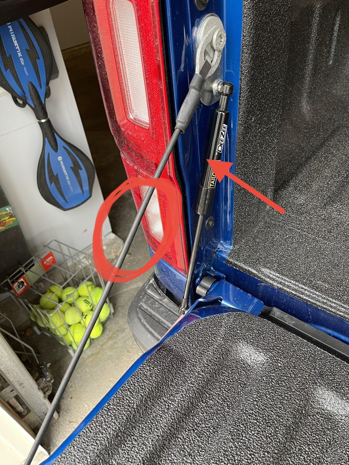

I experienced the same thing. I simply "trained" the cable to fold to the other side of the strongarm.
It took only a couple of minutes to repeatedly fold the cable to the inside as I closed it.
I did this about 8 or 10 times and it now goes that way naturally.

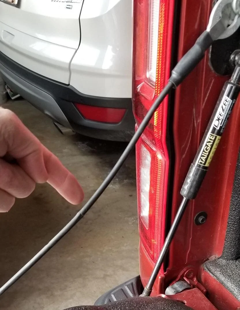

Has anyone noticed any kinks in their tailgate cable on the damper side? I've had mine on for a long time, and today noticed a kink in the cable, on the damper side, and the cable is slack. The opposite side is taut. Don't like this.
When I slowly closed the tailgate it seemed the cable was kinking at the damper shaft/cylinder area, which is about the center of the cable as seen in the pic. I'm sure there is only one way to install it, but now am wondering if the cable kinking is a design flaw or something else and happens every time you close the tailgate.

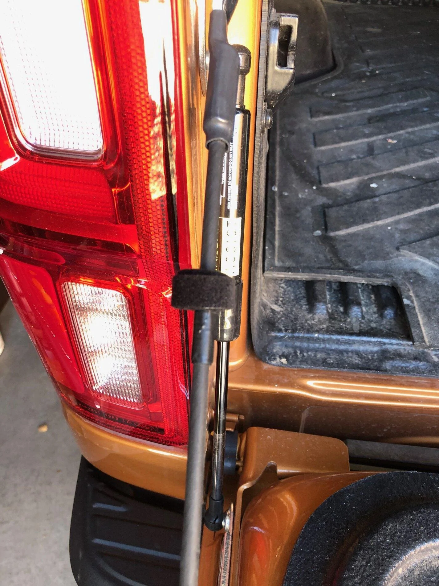

I used a velcro tie on the cable to guide it around the damper so it doesn't get pinched between the damper and the body. Add some black tape below it so it doesn't move and you're gtg.
Thanks for the idea and I'm going to give this a try. Just noticed in the one week of damper ownership that my tailgate cable was getting roughed up by the damper.
