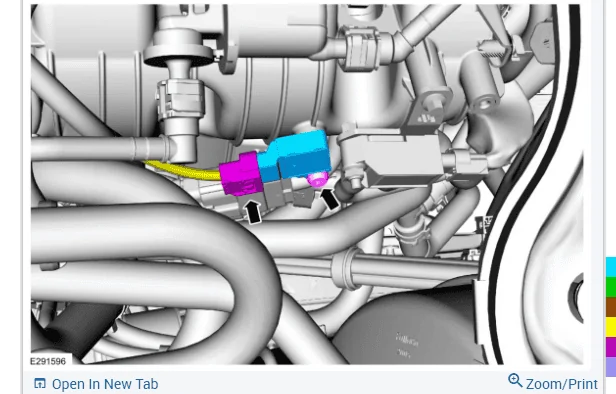

My understanding is that the Ranger's 2.3L Ecoboost doesn't have a MAF sensor, but, does have a MAP (Manifold absolute pressure?) sensor. I'm still researching if GDI cleaners have any negative effect on MAPs. My local Tire Discounter shop showed me where they would normally insert a tube for their GDI spray cleaning system and basically they loosen the intake pipe clamp on the side that's opposite the throttle body on the short ABS connector pipe just before the throttle body. They insert a very narrow spray tube that's bent to allow replacing the intake duct onto the ABS coupler and mist the GDI cleaner into the throttle body at 2K RPM.
I'm thinking about drilling a small hole in the ABS coupler that would be just large enough to fit the spray tube into and when done install a short screw to seal it back up which would allow easy removal for the next time.
I think this picture shows where the MAP is located on the intake manifold.
