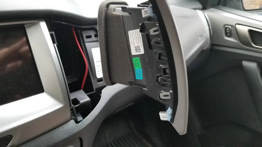

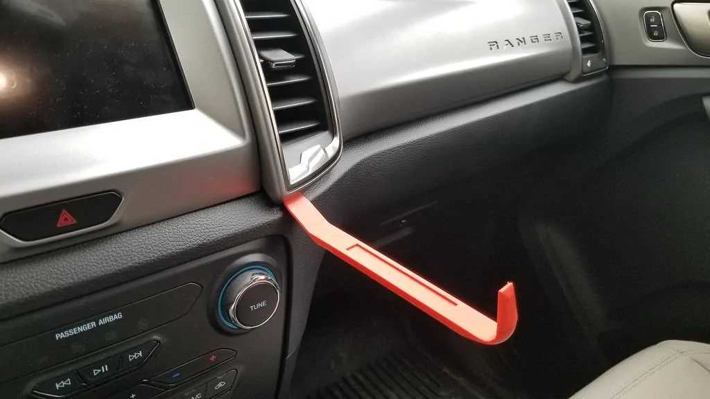

I haven't covered mine but the panel is very easily removed.
Here are the steps I used for a phone holder
Then just pop it off at the passenger side.

Wow thanks. I didn't realize it would pop right out. I thought there may have been an airbag behind it.
