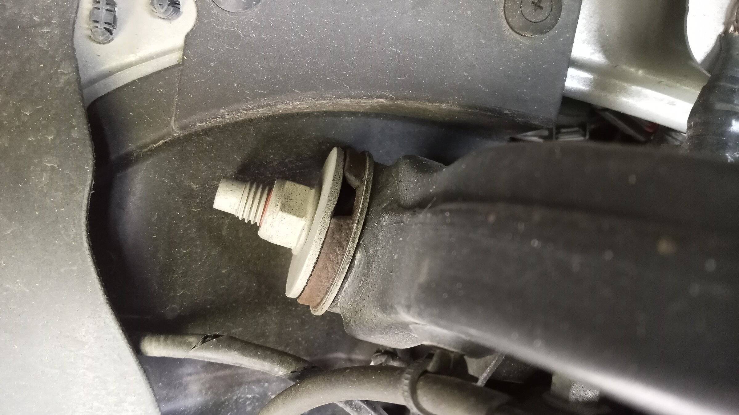

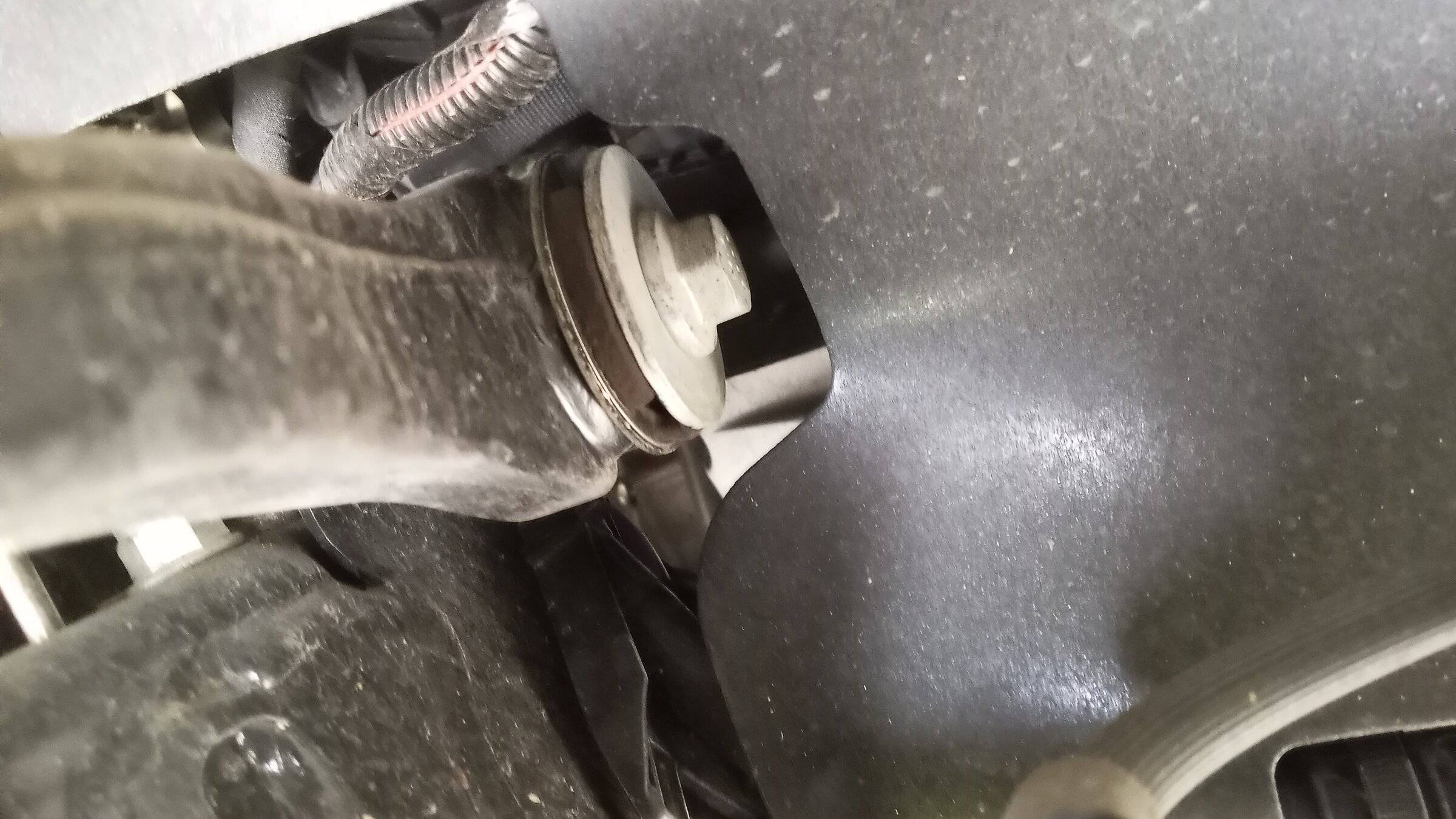

All the bushings in my upper control arms have small sections missing, like chunks missing.
This can't be normal can it?
Both driver side and passenger side bushings are like this...

Can't say for sure it's normal on the Ranger, but plenty of other vehicles I've worked on had similar molding in the bushing. Usually helps control flex and deflection direction when absorbing shock.
Hopefully Phil can chime in on this for the Ranger.

I just did a quick search and the Duralast replacement bushings at Autozone also have sections missing.
142
7,016
36,214
When you compress a rubber bushing, the rubber material has to go somewhere so voids are purposely molded in the bushing to fine tune the "spring rate" of the bushing... Sometimes there is also an orientation mechanism to give the bushing rate difference in one direction, say Jounce/rebound vs outboard/inboard for example.
The old F Series twin I beam front axles had an asymmetric design to improve center feel of the steering but better compliance in the jounce and rebound movement... Sort of an oval bushing...

Ah, ok thanks.
