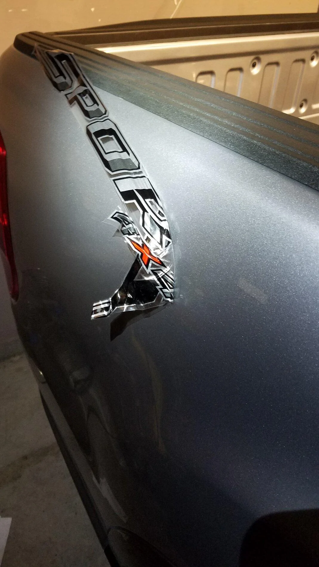

Considering removing the “Sport” decal on the bed of my Ranger XLT Sport. Has anyone else removed theirs? Is it even possible?

It’s easy to do, wait for a hot summer day and it peels right off. Or get a hair dryer on a mid heat setting and get it slightly warm and it comes off easily

Super easy to remove the sport or FX4 decal when it is warm out, or a hair dryer like Jimmy said :thumbsup:

My FX-4 decals peeled @ first wash, ripped 'em right off.

Uh... what? Dude all you do is hit it with your wife or girlfriends hairdryer for a second then peel it right off. It is literally a sticker decal.

Removed my 4x4 sticker as soon as I got it home, as well as the EcoBoost badge, dealer crap, and blackout decals between the windows. Everything came off clean in about 15 minutes.

The heat gun / hair dryer really helps as others mentioned, also try a spray bottle with 99 percent water and a few drops of dish soap. Spray the area down after heated and then peel. The soapy water helps to prevent minor scratching and oopsies. Think of it like wet slick paint is much harder to scuff and scratch than dry paint.
