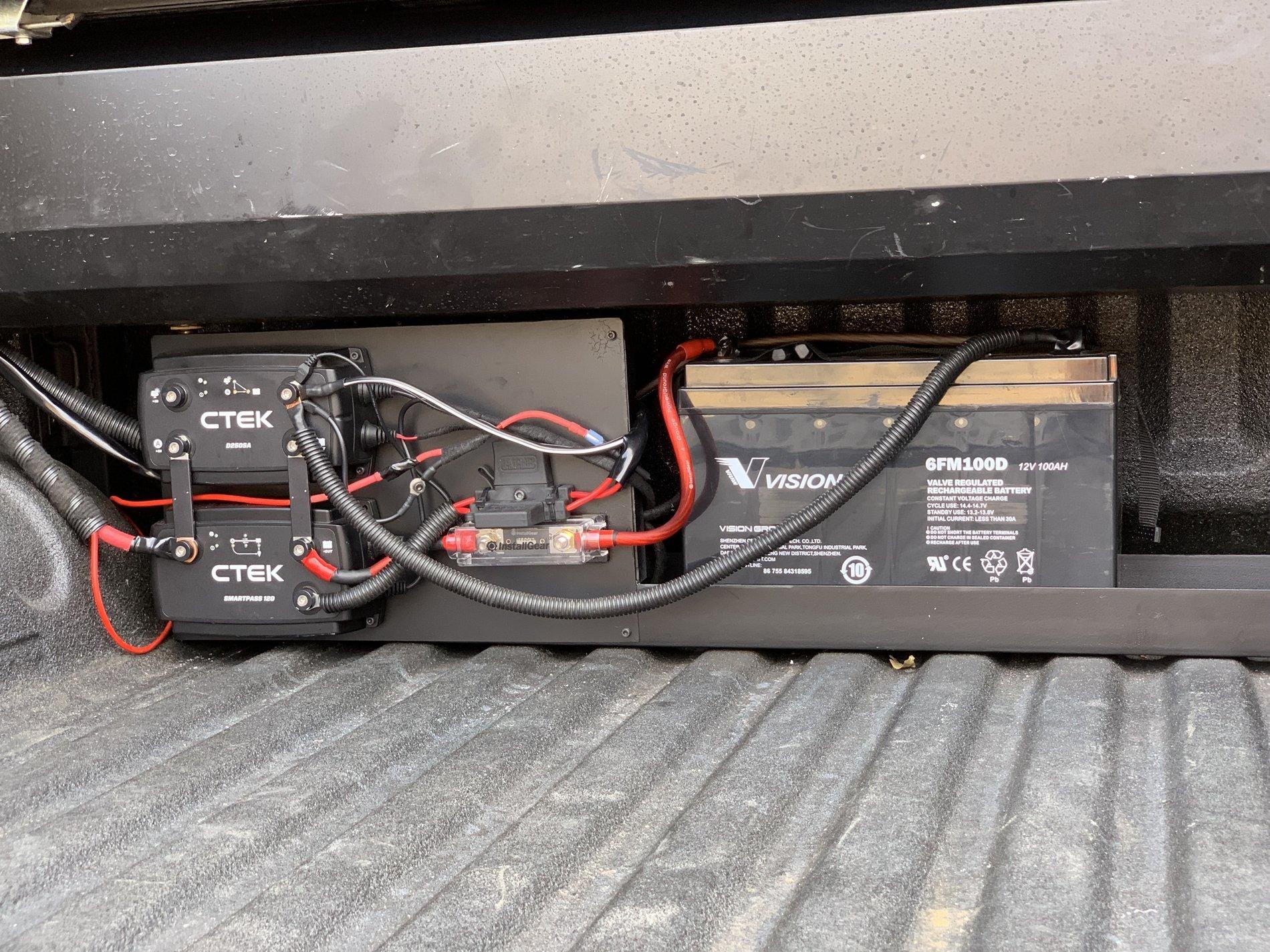

I made some custom panels and brackets for a dual compressor and electronics, and a separate one for Dual Battery and chargers.
I'm using a CTEK Smartpass 120 and CTEK D250SA combo, with a 105Ah AGM battery, BlueSea systems fuse distribution boxes. main fuse/breakers and ground distribution blocks. ARB Dual compressor for air, tools and automatically controlled pressurized water tank.
Getting the cabling to look nice still needs some work, but it's taking a bit of time
