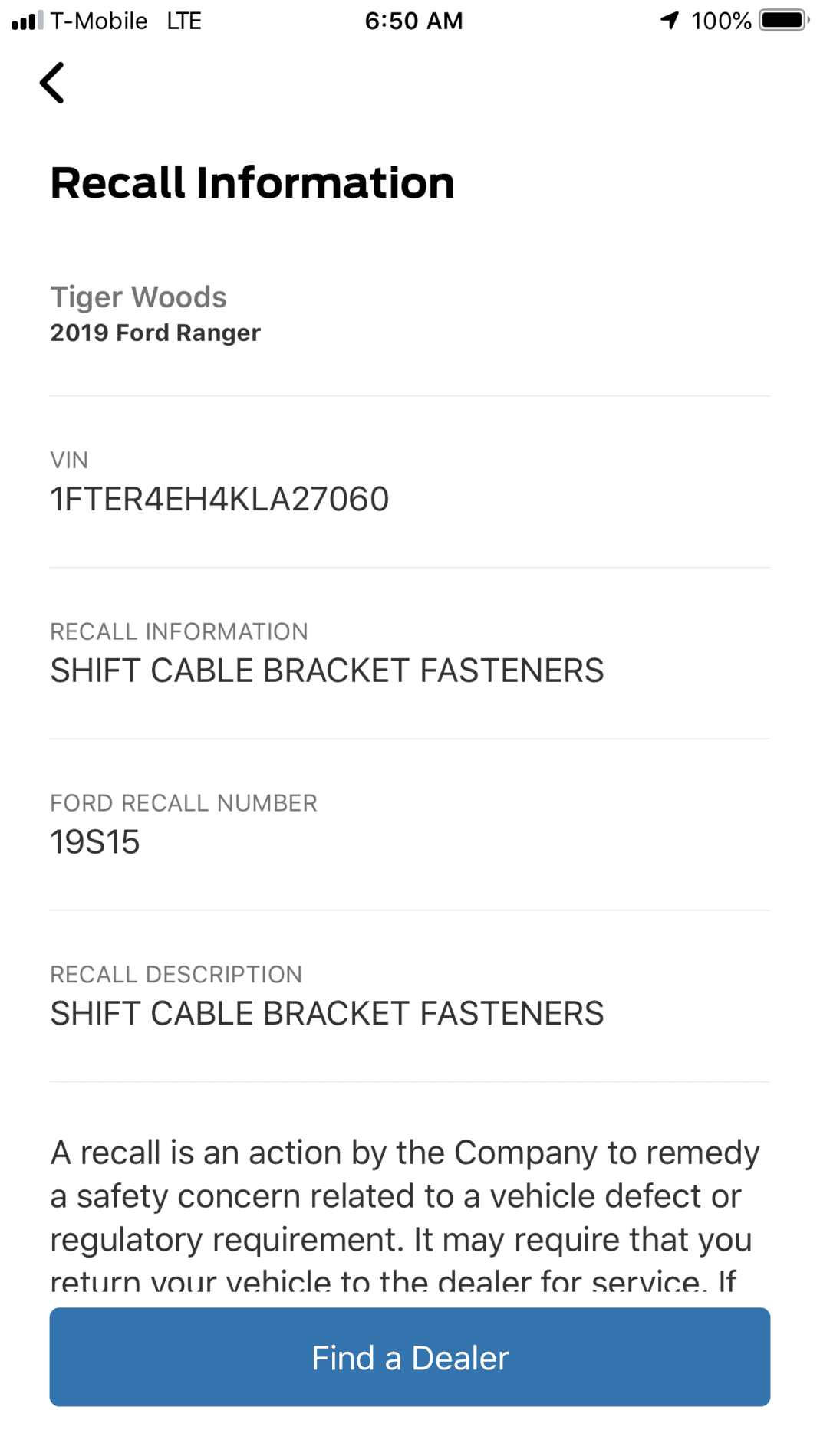

Thank you. Assuming if I got recall via “Ford Pass” then my vehicle is affected?
Yes. I'm assuming you'll also get a letter in the mail from Ford with the details.. If the press release from Ford is correct, you can verify your build date on the FMVSS sticker on the driver's door pillar and if it falls between March 5 -13th it is under recall. You can also confirm with your dealer, although I wouldn't be surprised if they don't have the details yet. Since there don't appear to be any parts required, just torquing bolts and verification of shifter behavior, it should be a quick trip to the dealer.

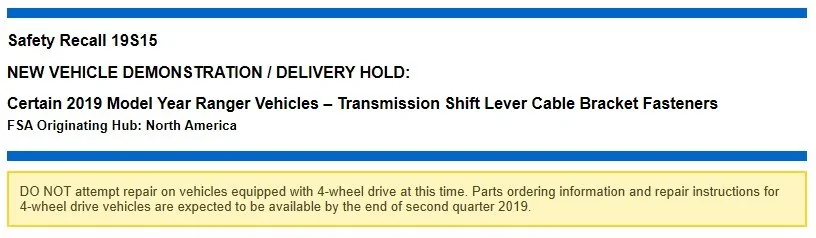

This little tidbit is alarming:
DO NOT attempt repair on vehicles equipped with 4-wheel drive at this time. Parts ordering information and repair instructions for 4-wheel drive vehicles are expected to be available by the end of second quarter 2019.
