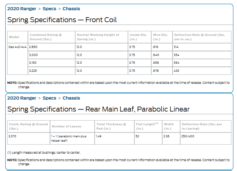

Anyone know what the spring rates are for ranger?

Frenchy Well-Known Member First Name Chris Joined Mar 15, 2020 Threads 98 Messages 6,122 Reaction score 8,264 Location Elizabeth, Colorado Vehicle(s) 2019 Ford Ranger, 2019 cargo van, soon to be 1993 Occupation Crown Forklift Technician Nov 24, 2020 #2 Stiff if that answers your question lol. Someone on here might know but im curious as to why you want to know? Are you thinking of lowering or lifting the truck?

painter1 Well-Known Member First Name Ali Joined Oct 21, 2020 Threads 2 Messages 72 Reaction score 139 Location SW BC, Canada Vehicle(s) Ford ZX2, F350 Nov 24, 2020 #3 specs from ford bbas https://fordbbas.com/publications 2019 Ranger spec https://madocumentupload.marketinga...5fe6a3f071f94debbe9ff7c4c82020f48213&v5=False guess you first need to find your front axle weight rating from the door jamb sticker on edit : I think the front coil is a constant rate spring so the last column would give the spring rate (dependent on the FAGWR) Sponsored
