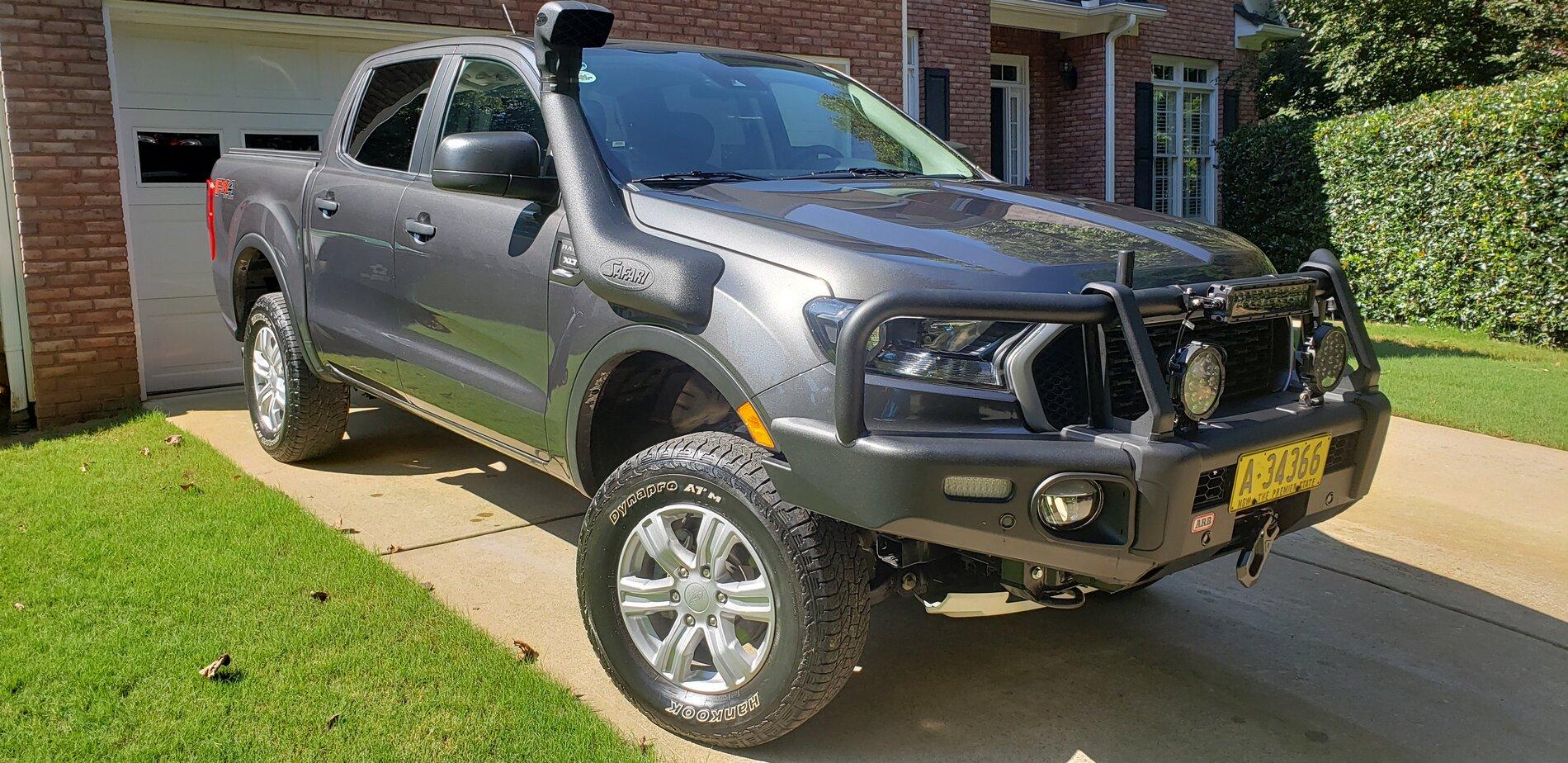

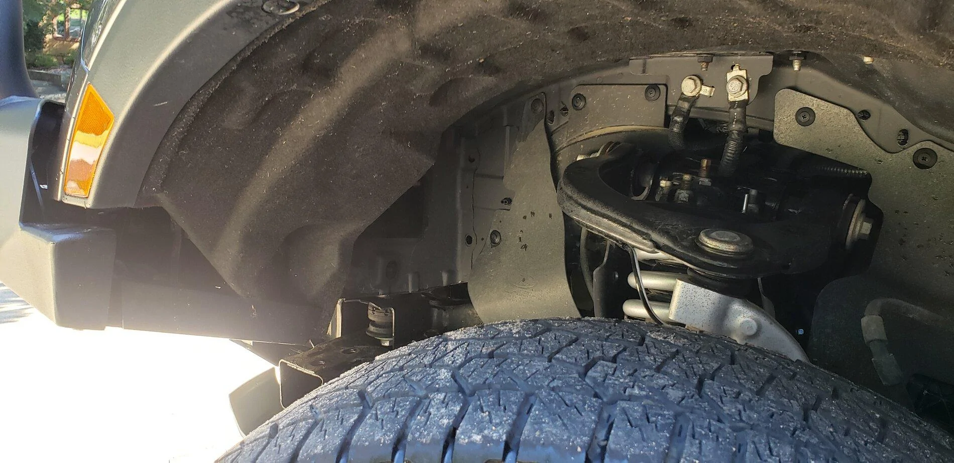

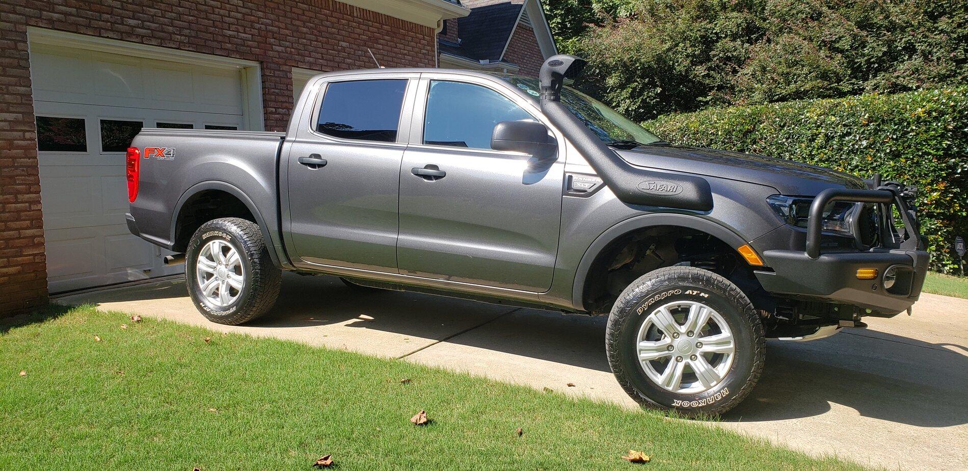

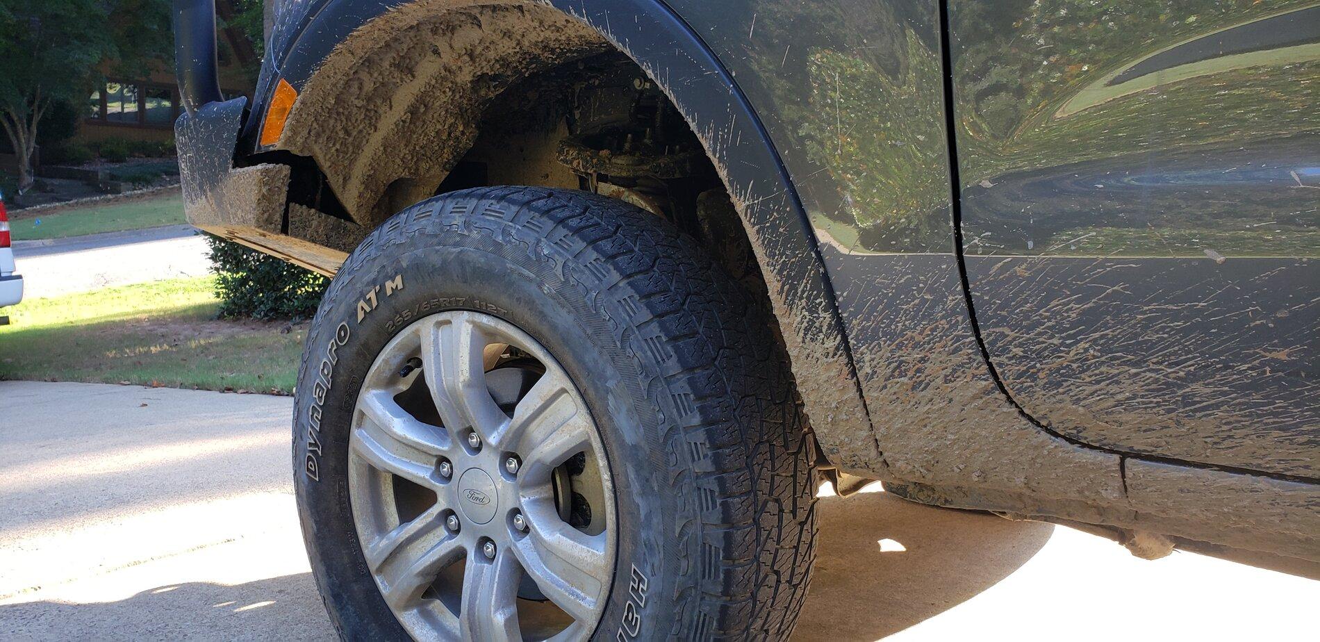

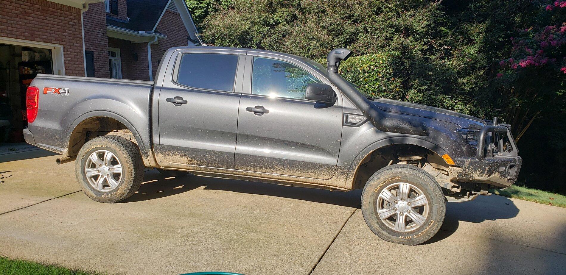

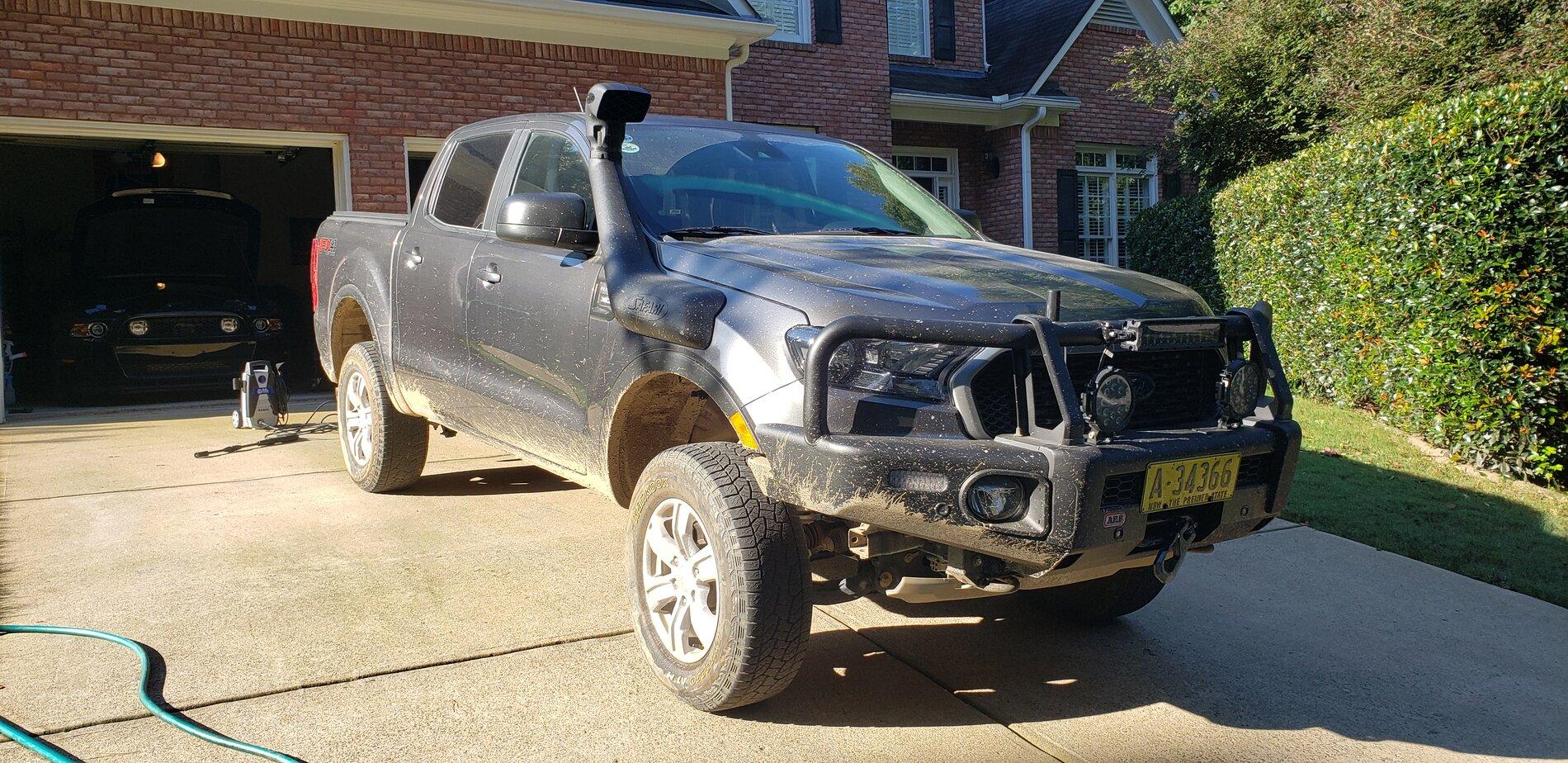

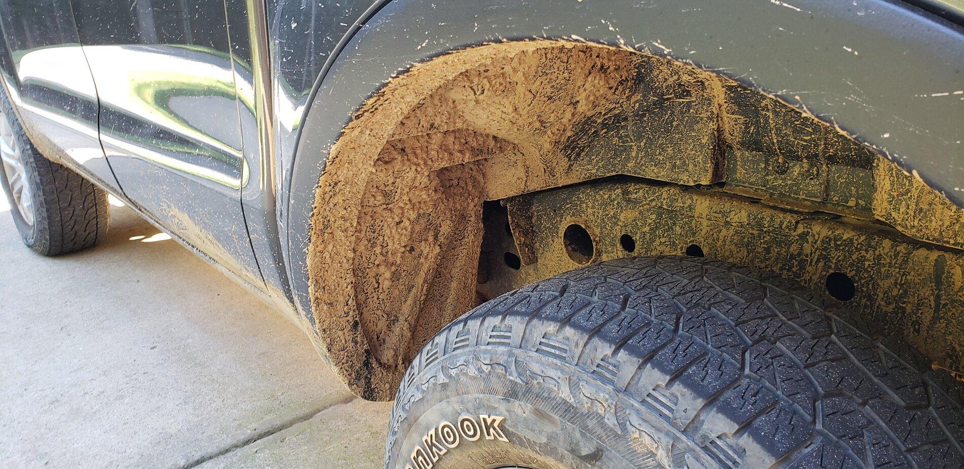

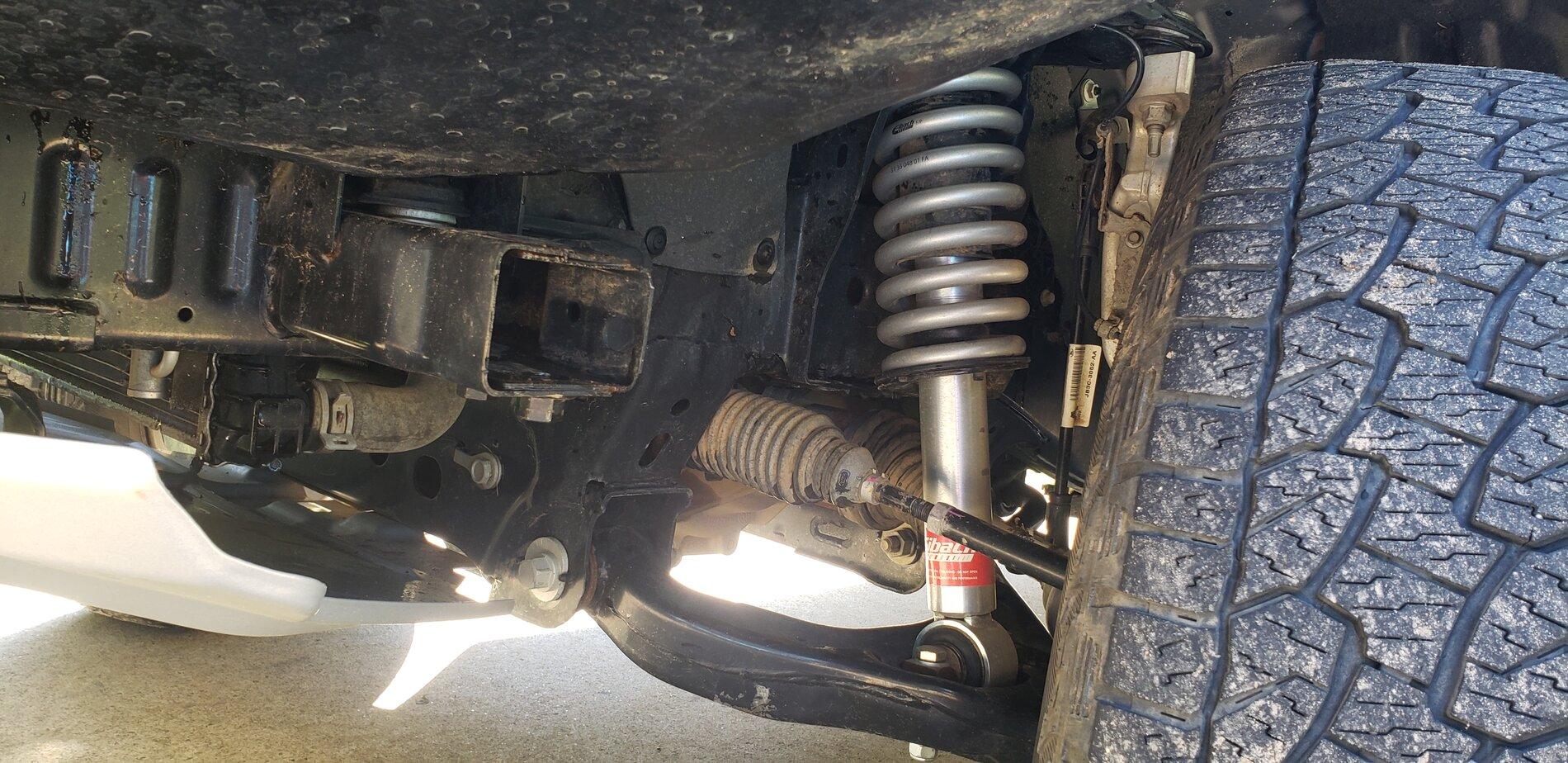

A couple of weekends back I went on an all day off-road excursion and my truck got VERY dirty! The next day I busted out the pressure washer and blasted the dirt off the body and the caked on mud from underneath.
And then I cheated! I drove my truck down the street to a hand-wash car wash operation and paid $45 (after $10 tip) for them to clean my truck up, inside and out!
BEFORE:
AFTER:
BEFORE:
AFTER:
BEFORE:
AFTER:

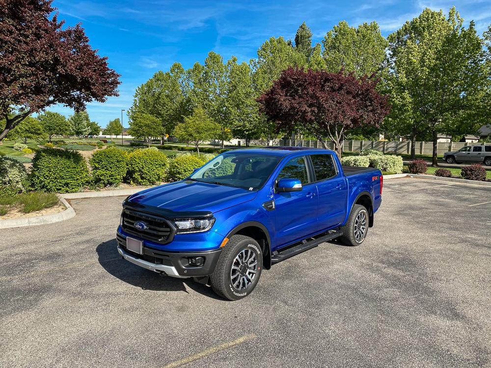

I'm actually working on a video for my YT channel right now all about what I've done to protect the exterior of my Ranger. In a nutshell, here is what I did shortly after purchase:
Very thorough wash, using 2 bucket method and basic car wash (no fancy wax additives, etc).
Clay bar entire exterior to remove fallout/grime.
Polish entire exterior to remove any light swirls from dealer washes.
Installed bug guard / deflector at front edge of hood.
Installed Paint Protection Film on all forward-facing surfaces (rear view mirrors, front of roof, grill, bumpers, headlights, etc)
Ceramic coated entire vehicle.
I did it all myself, took 3 full days because I filmed it all. Lots of work, but the payoff is amazing.
Now that all of that has been done, my upkeep routine is:
Wash the truck every few weeks or anytime I get it really dirty off road.
I'll re-apply the ceramic coat annually.
That's about it.
I did manage to get some pretty good pinstripes from some thick brush I had to drive through on a trail once, so I had to buff that out and re-apply ceramic coat to one body panel.
Here's how it looks freshly washed:

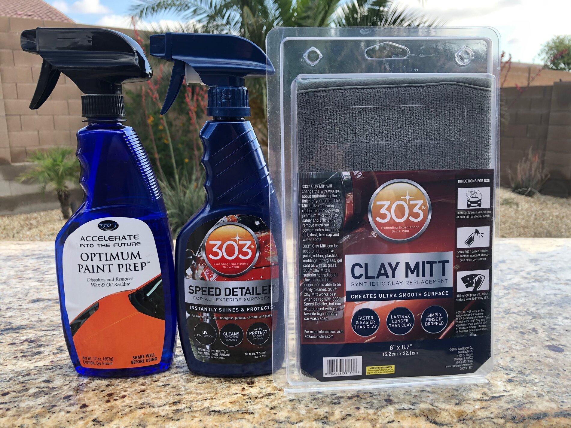

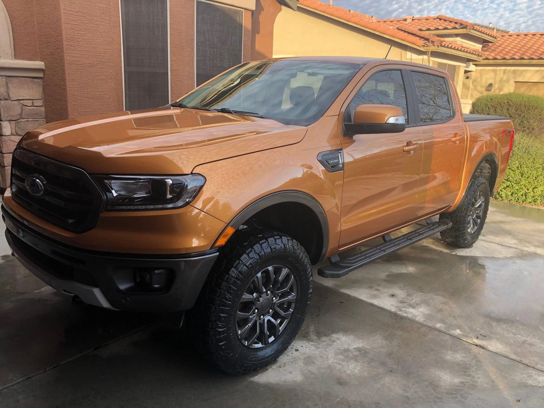

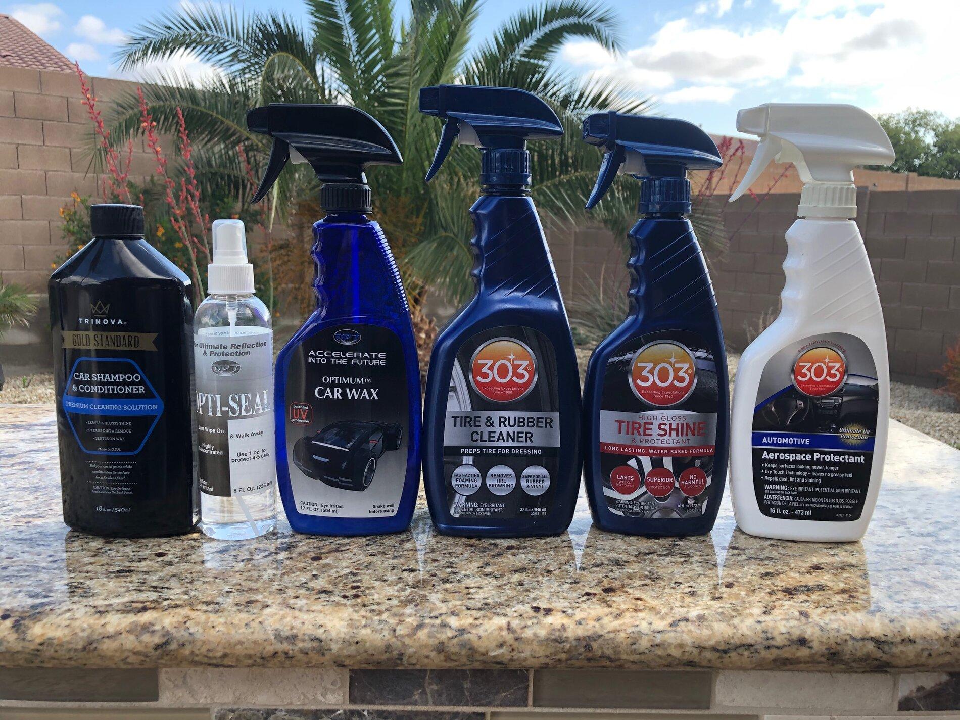

I had done a write up in the detailing section back in the spring so here's a copy of it.
I’ve been using these products for years with great results. I was going to try the ceramic coating but I'm actually one of the weird ones who enjoys waxing my vehicles. lol
If claying,first wash the truck and do not dry. I use the 303 Speed Detailer (more is better) for my lube. Spray one panel at a time with lube and run your clay mitt side to side then up and down using NO pressure but the mitt. Once you’re done with that panel take a plastic sandwich bag and put it over your hand and run it down the panel you just clayed. If you feel any grit spray more lube on and re-clay that area until it smooth. Continue this for the entire truck until the baggie glides over the area without any grit.
Next I like to strip off any old finish and start fresh so I use the Optimum Paint Prep. Just spray it on and wipe off with a micro fiber cloth. I only do this about every 18 months just to get a fresh base to start with.
My basic wash and wax:
I use the 2 bucket system 1 for washing with a grit guard and 1 for rinsing my micro fiber mitt also with a grit guard. I use the Trinova Car Shampoo and Conditioner as it has no added wax or sealants. Dry with a chamois,spray a coat of Optimim Opti-seal (use very little as less is more) usually 1-2 sprays per panel. I use a foam applicator and just give it a couple of sprays on that and run it over the panel. Once it starts to drag just give it another spray or two. Top coat with Optimum Car Wax,same less is more. This I spray directly onto the panel and wipe with a micro fiber cloth. You don’t have to buff out just wipe on and let it dry. I also use the Opti-seal on all the exterior glass,this seal the glass and beads up like Rain-X but lasts much longer. I also use this in my house on my shower glass,bath mirrors and stainless appliances.
I use the 303 Tire and Rubber cleaner to get rid of any road grime. Just spray it on,let sit for a minute and scrub with a brush and rinse. I also use their Tire Shine to top dress,it comes in satin and gloss finish.

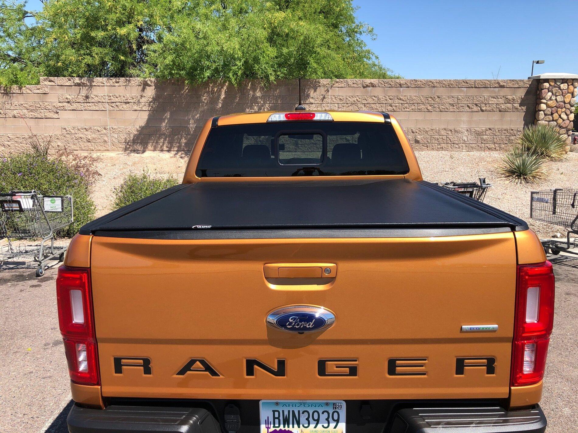

Finally I use the 303 Aerospace Protectant for my tonneau cover and any black plastic and rubber, This is the best UV protectant you can get! It has super UV protection and will even help restore weathered gray black plastic back to original. I use this on all my interior too from the dash,seats,steering wheel and all the black plastic moulding throughout the truck. It does not leave a greasy film like Armor-All does.
All the 303 and Trinova products can be found here,I think Amazon sells most of them too.
Optimum Products can be found here.
Edit: So obviously now I've switched to 303 Graphene Nano Spray and the Graphene Detailer. ?
Wash:Wax products.jpg
Tonneau cover and black plastic with the 303 Aerospace protectant applied.

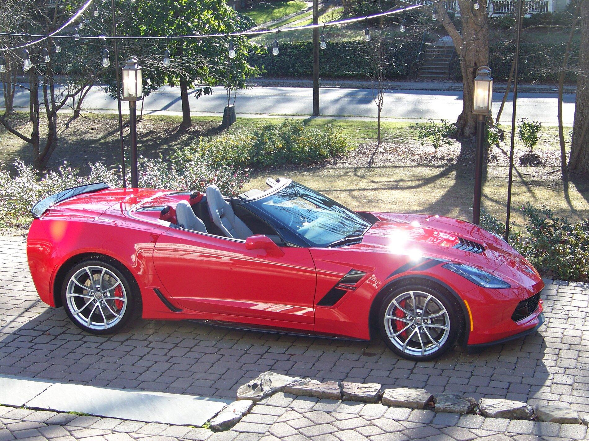

I'll use the same stuff I use on my other vehicles. Meguiar's Ultimate line of wash, and waxes. They are great products at a reasonable price, and EZPZ to use. Now that I've gotten more mature "easy" is the way I like to go.
Here's is the results. And, it works that good on my Jeep, and the wife's Mustang.

Dave, at my mature age the only thing we had back in the day was good old ArmorAll for all of that stuff. And it worked although it was greasy, and attracted dust like a prom Queen attracts horn dogs on prom night. Then I found 303. If anyone needs any ArmorAll I have several bottles on the shelf in my basement. :)
