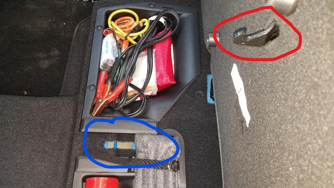

On a related note, does the hook underneath the rear seat bottom (circled in red in the picture below) actually do anything on anyone's Ranger? It seems like it should engage the catch circled in blue in the picture below, but mine misses it by a few millimeters. The hook doesn't move when I try to move it by hand, and it doesn't move when I pull the strap that releases the seat bottom to move it up or put it back down. The seat bottom only seems to be held in place (rather weakly, I might add) by some mechanism at the pivot point. It seems like this hook is there to keep it locked down, but mine doesn't.
Mine doesn't latch or make contact either. Maybe it's a safety catch in a collision?
