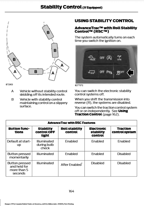

This page of the Owner's Manual should be titled "How to Donut". Just hold that Traction Control button for five seconds and have some fun!

On another note in case some didnt know, there are two stages to "traction control off" push the button and its off but you still get some driver feedback. Press and hold the button for a while and another message pops up , basically saying that everything is off. You are on your own after that:like:

I believe the first push disables traction control but leaves stability control and roll control enabled. The longer push disables everything.
