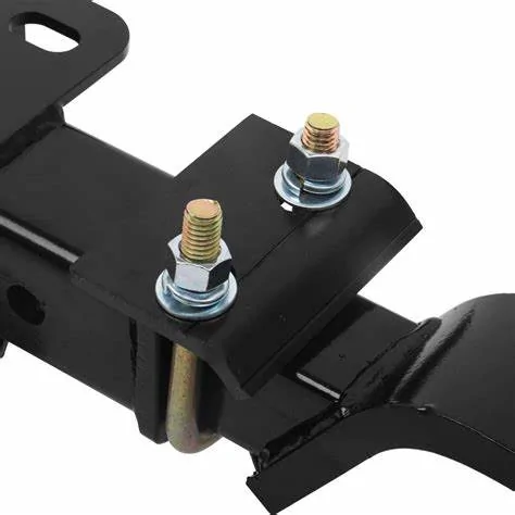

I use one of these to lock my drop hitch into the receiver. I have been using one for years and find that it eliminates the rattle and looseness of the hitch into the receiver.....gives a much more solid feel to the trailer.
The product you have pictured has been around in one form or another for awhile now. Nice product, but the major source of a bad ride are the springs on the trailer, and the "looseness" of the drop hitch into the receiver...even as little as 1/4 inch play transmits to a clunky ride.

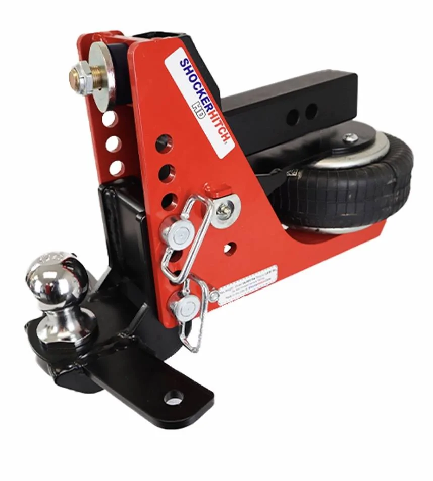

From the website:
Great for taller or lifted pickup trucks including GMC Sierra, Chevy Silverado, Chevy Colorado, GMC Canyon, Dodge Ram, Ford F150, F250, F350, F450, F550 Superduty, Toyota Tundra, Tacoma, Nissan Titan, Frontier and Honda Ridgeline.
Honda Ridgeline? Taller and lifted? I wouldn’t transport this hitch in the bed of a Ridgeline, let alone in the receiver.

The first problem I see with the Shocker Hitch is that it will act the same as any hitch that is inserted into the receiver...it will still have the "play" that is common to all unless you use a "lock" like I pictured above. Even with the "shock absorber", without the lock, it will still "jerk" and bounce.
The other reason that, although a nice idea to get you to spend big $$$ is that all the "roughness" and jerking you feel when towing a trailer is first the looseness of the hitch/receiver, and second is the fact that almost all trailers rely on a suspension that was used in the 1920's...a suspended spring that will almost always give a rough/bouncy ride. Travel trailer or flat bed trailer or box type trailer...pretty much use 100 year old technology. That lousy trailer suspension transmits along to the loose hitch in the receiver and you get a lousy tow. Called "road shock".
Easiest way to eliminate is to use a hitch lock as pictured, and up -grade the suspension on the trailers spring hangers, and/or add a trailer specific shock set up to it.
Without going into lots of pictures and products, google up ETrailer, and look thru trailer suspension up-grades.
A shock set up is probably the easiest and cheapest way for either a single axle or tandem axle...
Think of it this way...
Your Ranger weighs around 4400 lbs, has springs and shocks on all wheels/axles. Take away the shocks and what kind of ride are you left with ? A lousy one.
Take a 4400 lb trailer that only has some stiff leaf springs and what kind of a ride do you get...a lousy one.
Just got our new travel trailer and a shock set up is one of the first mods I plan for in the near future.
Used them in the past and they do help smooth out the ride.
And, a good shock set up will run around the same as that fancy hitch...probably less.

@Grumpaw , sorry but I'm new with trailers, a pic how this works/attaches?
Tks.
Benny just posted a pic. Their called hitch anti rattle devices, stabilizers, locks...any number of names.
They run around 10 bucks. Their only drawback is they have to be loosened every time you need to take the hitch shank off.
If you plan on leaving it on the truck for awhile, like your out camping for a bit, than its no problem.
