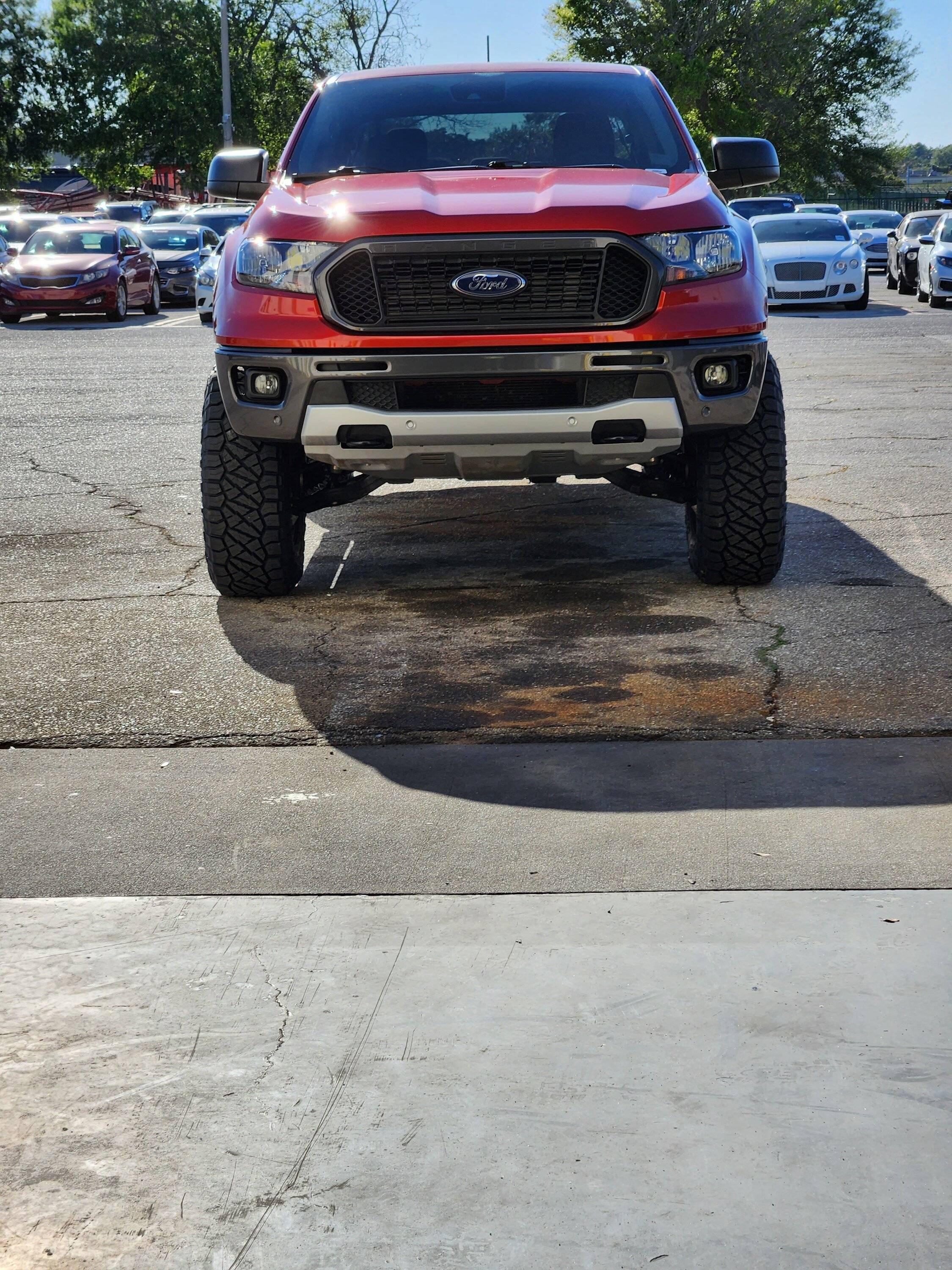

Bronze rocktrix 17"s on Hot pepper red

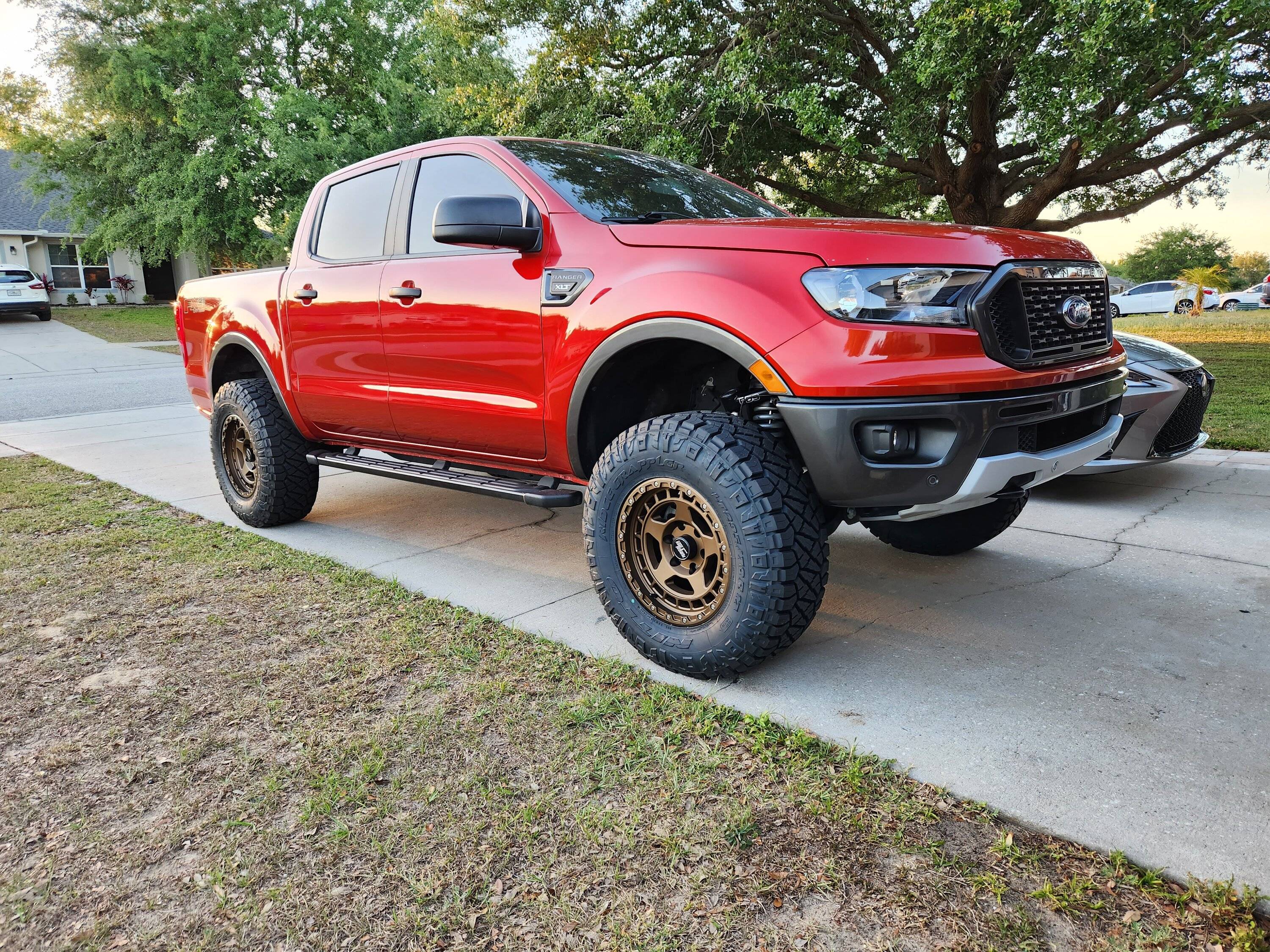

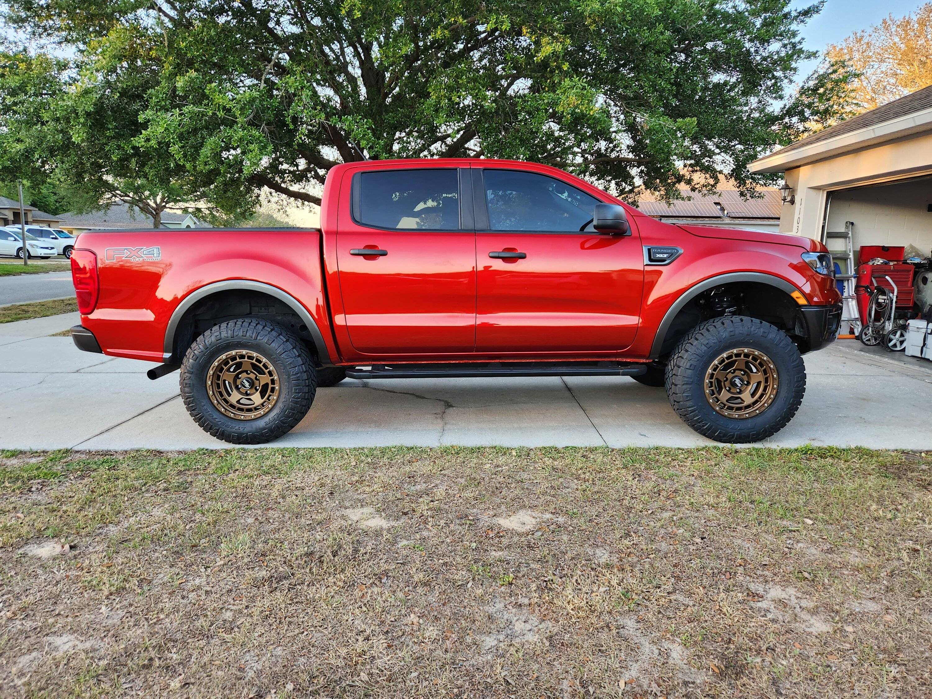

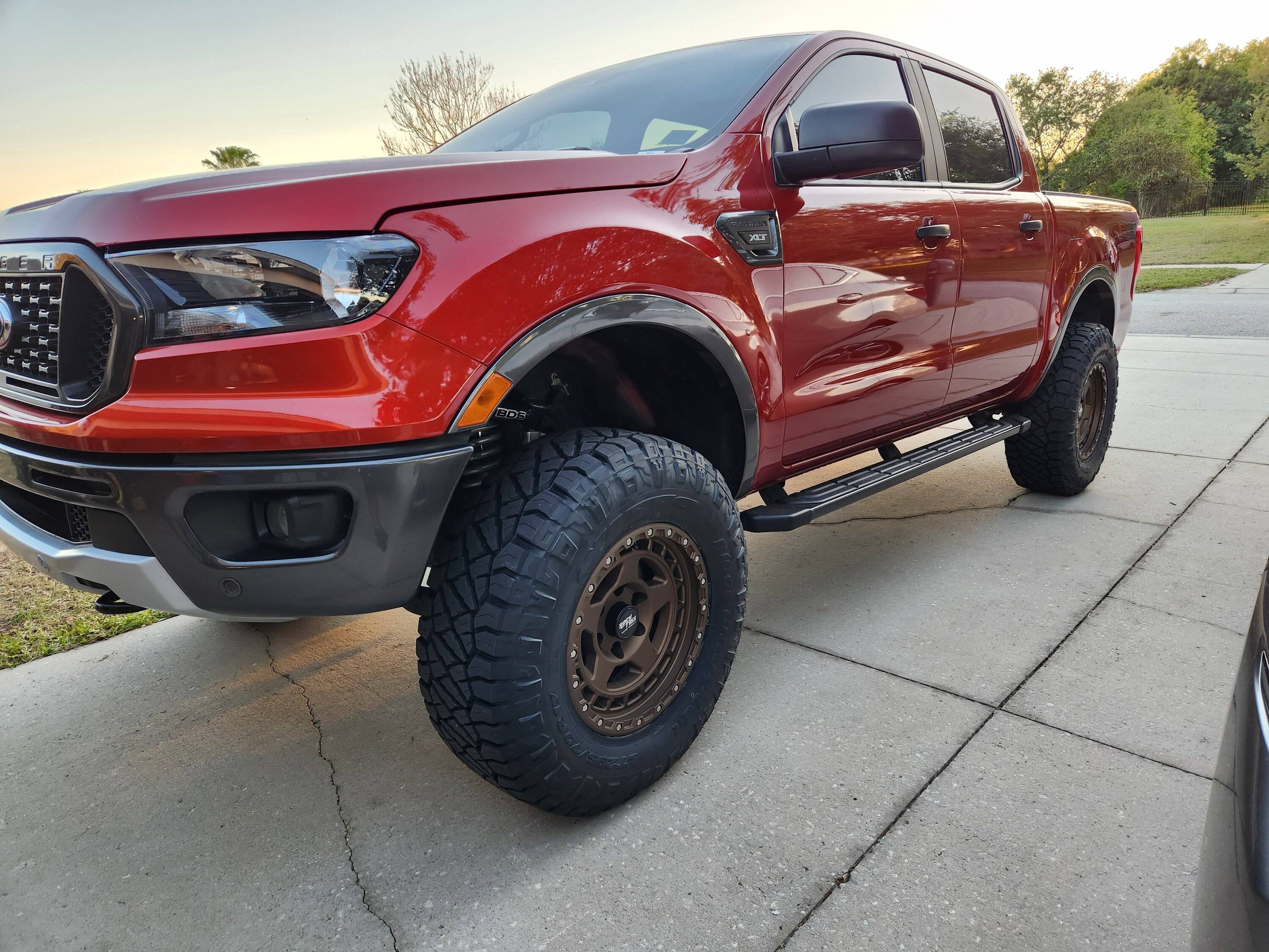

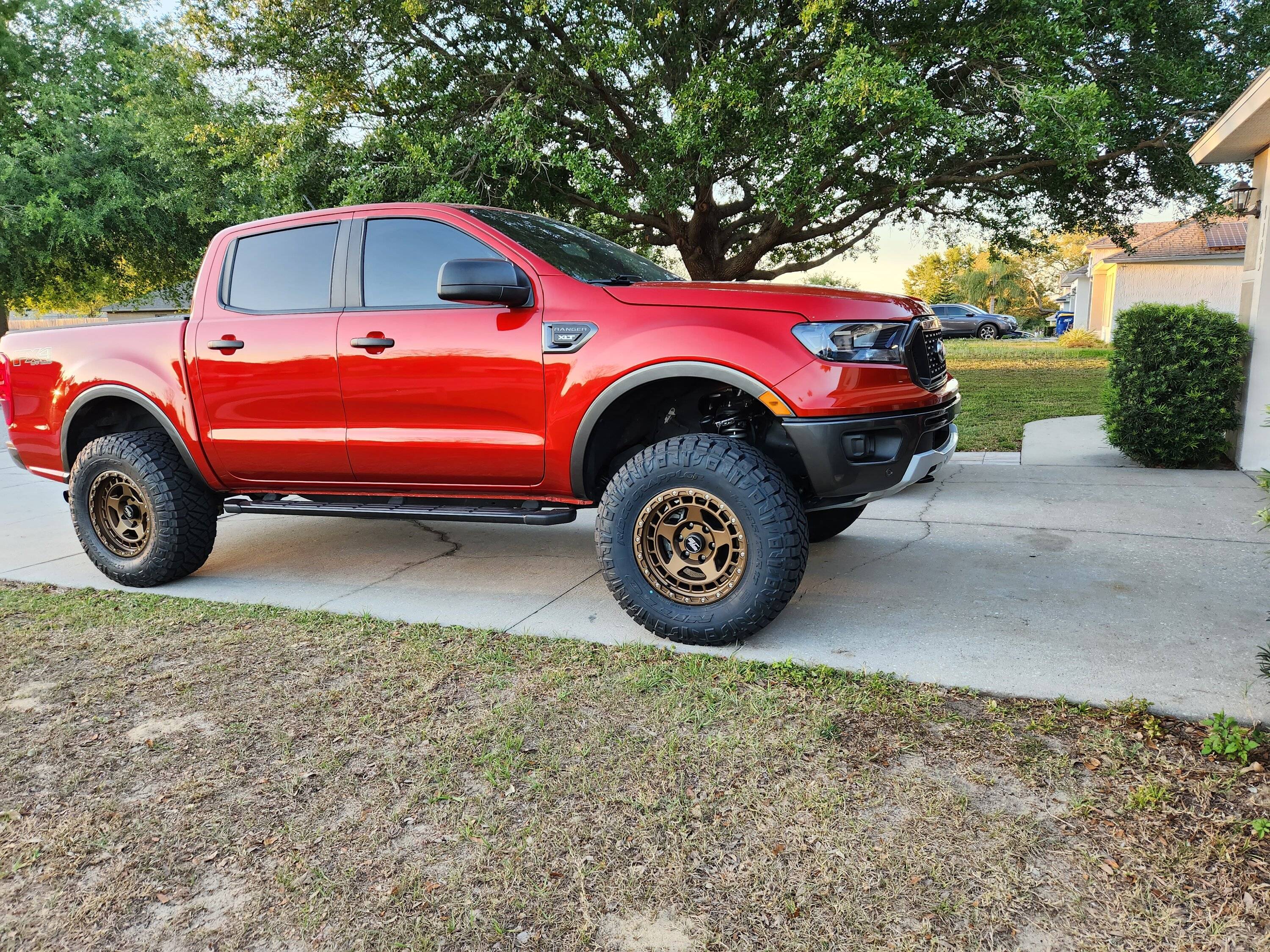

Do they rub anything? I ordered same wheels in black think I'm gonna run 285/70/17.

never was much of a fan of bronze wheels, but those look pretty damn good with the red. must be nice to have leaves on the trees this time of year

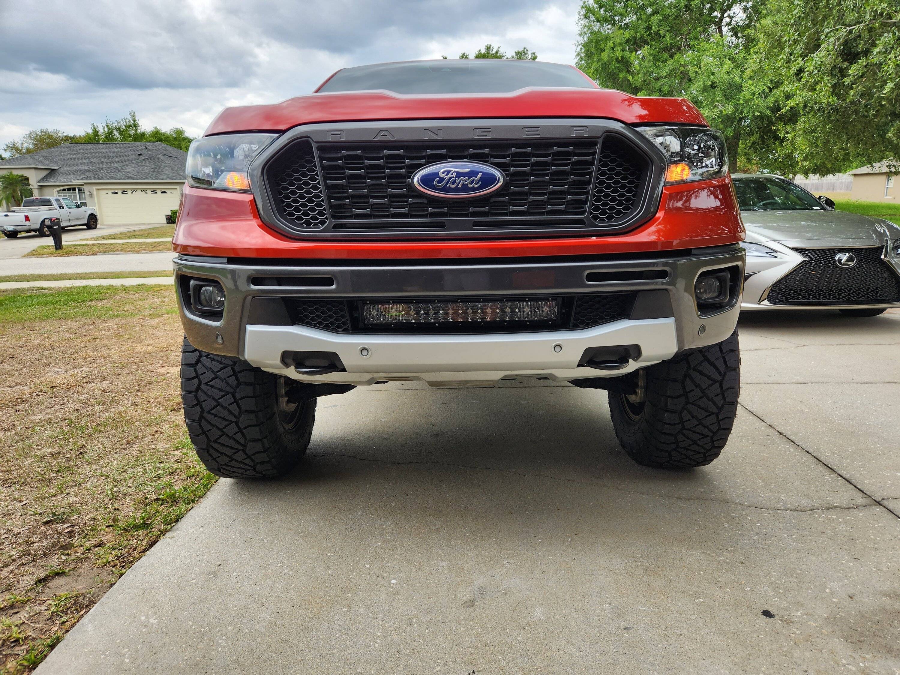

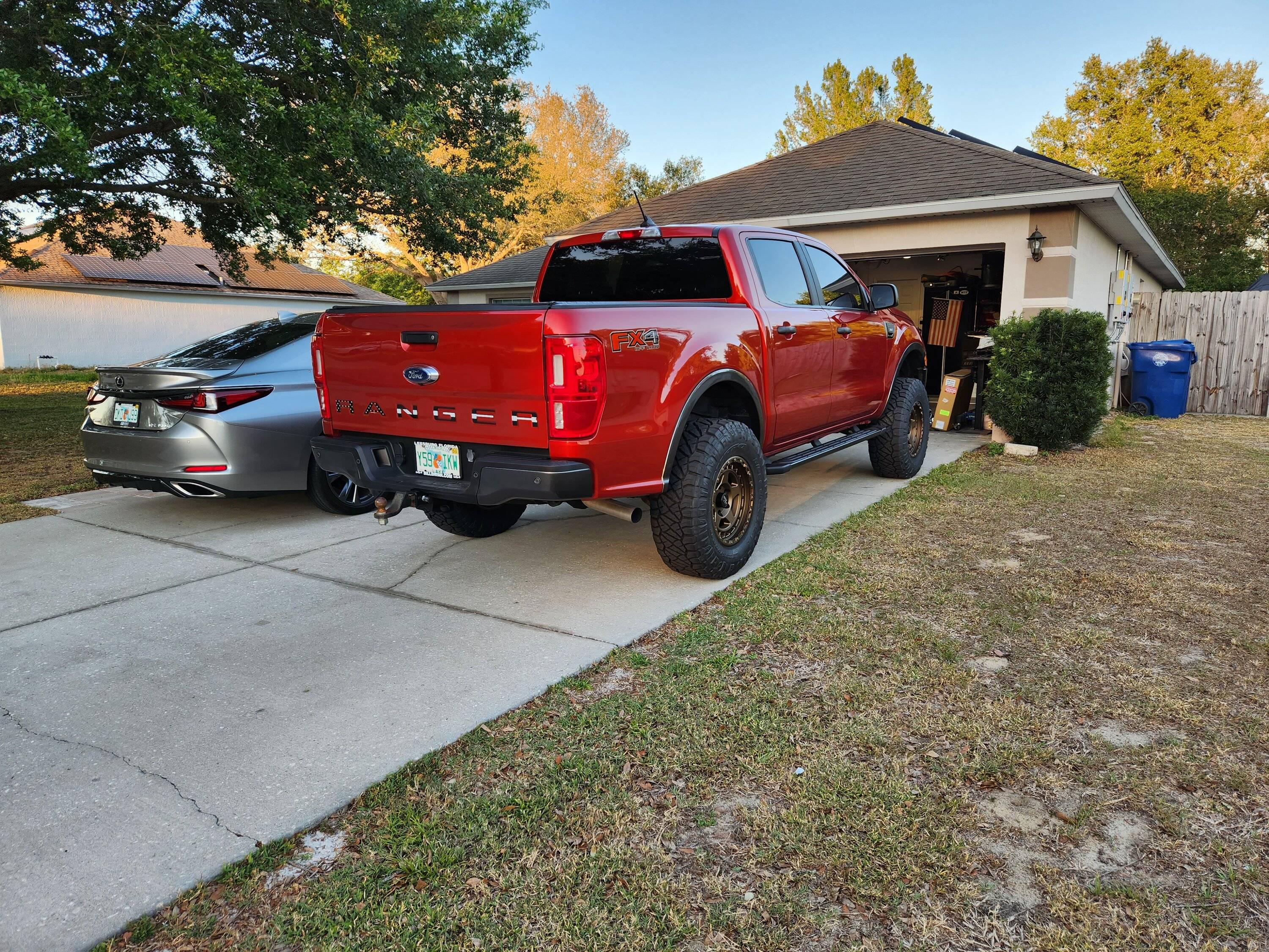

No rubbing. But I did remove crash bars and the honeycomb
I was skeptical. Did turn out good looking. Florida we are always green. Never gets really cold enough not to be a constant swamp

Any input on the crash bar removal?
Unbolt the front bumper. Leave it attached just work pullbone side to remove the front crash bars one at a time. The rear, well most would freak. But I used a airsaw and took about 1/2" off the fender underneath the fender flare. It pulled right out.
