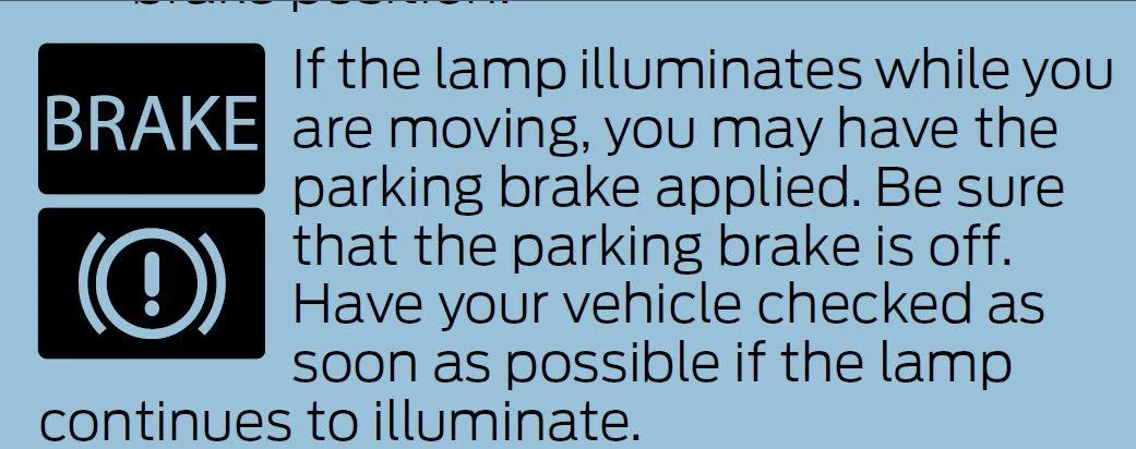

Hi Pete,
My take is it is parking brake related, not abs.
Here is from the owner's manual.
See Warning Lamps and Indicators
(page 86).
Note: Indicators vary depending on region.
E270480
This lamp also illuminates
momentarily when you switch
the ignition on to confirm the
lamp is functional. If it does not
illuminate when you switch the
ignition on, or begins to flash at
any time, have the system checked by an
authorized dealer. If the brake warning
lamp illuminates with the parking brake
released, have the system checked
immediately
