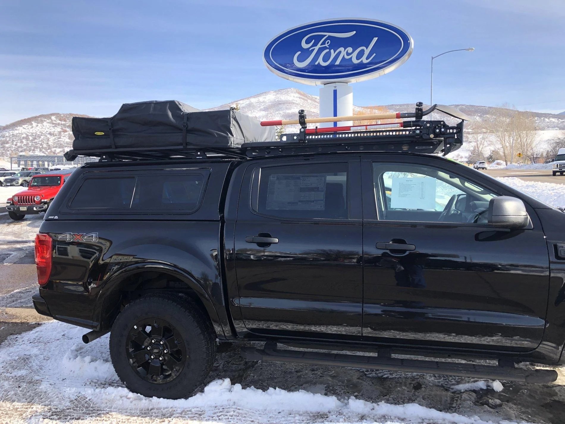

This just showed up at my local ford dealer. Looks awesome. The place I bought my topper from did the build. I’ll give them a call soon to chat about it. More details to follow...

I would be interested in a setup like that... so all you would really need is the Smittybilt Tent, and the Rhino Topper platform if you already have a topper with the Yakima Rack.
