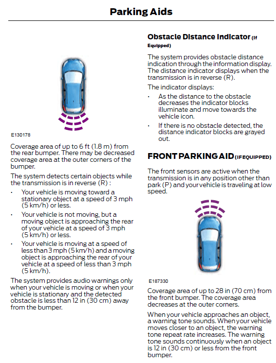

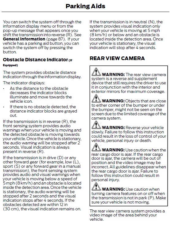

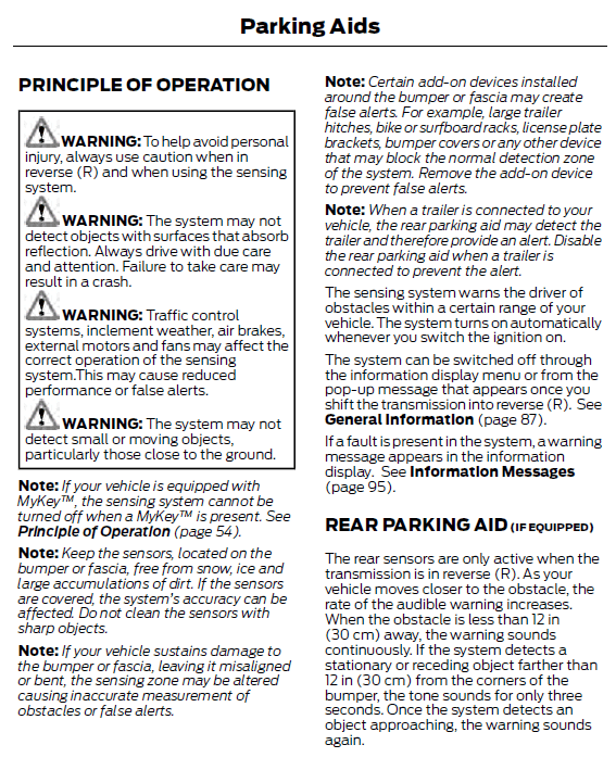

No offense intended, I'm sorry the manual clearly states less than 5 mph and a sensing distance of 28 inches. Even if they had gone you would not have been able to stop in 28 inches from 12 mph, even if they are enabled at that speed. Sounds like they were working as intended. They are parking assist not collision avoidance. That uses the camera up by the rear view mirror and the ACC sensor if you have one. Probably activates at a higher speed.
None taken. I appreciate the information. I mistakenly trusted the truck salesman to sell me a truck with the features I requested. Along with the information I was sent to watch in videos. During the minimal test drive. I did voice my concerns but he said it would still do it. The test drive was minimal as the main road to test it on by the dealer was under construction as well.
