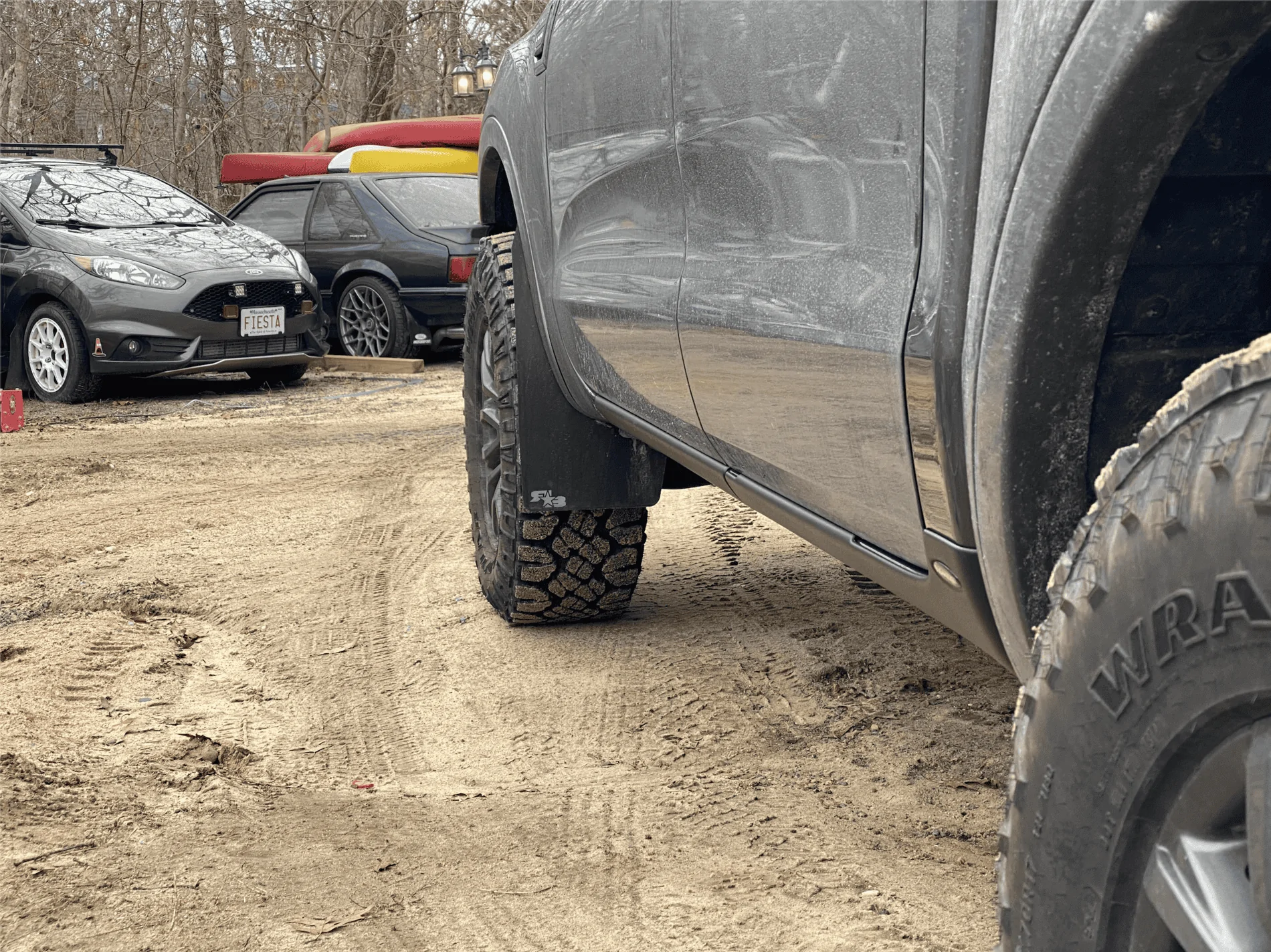

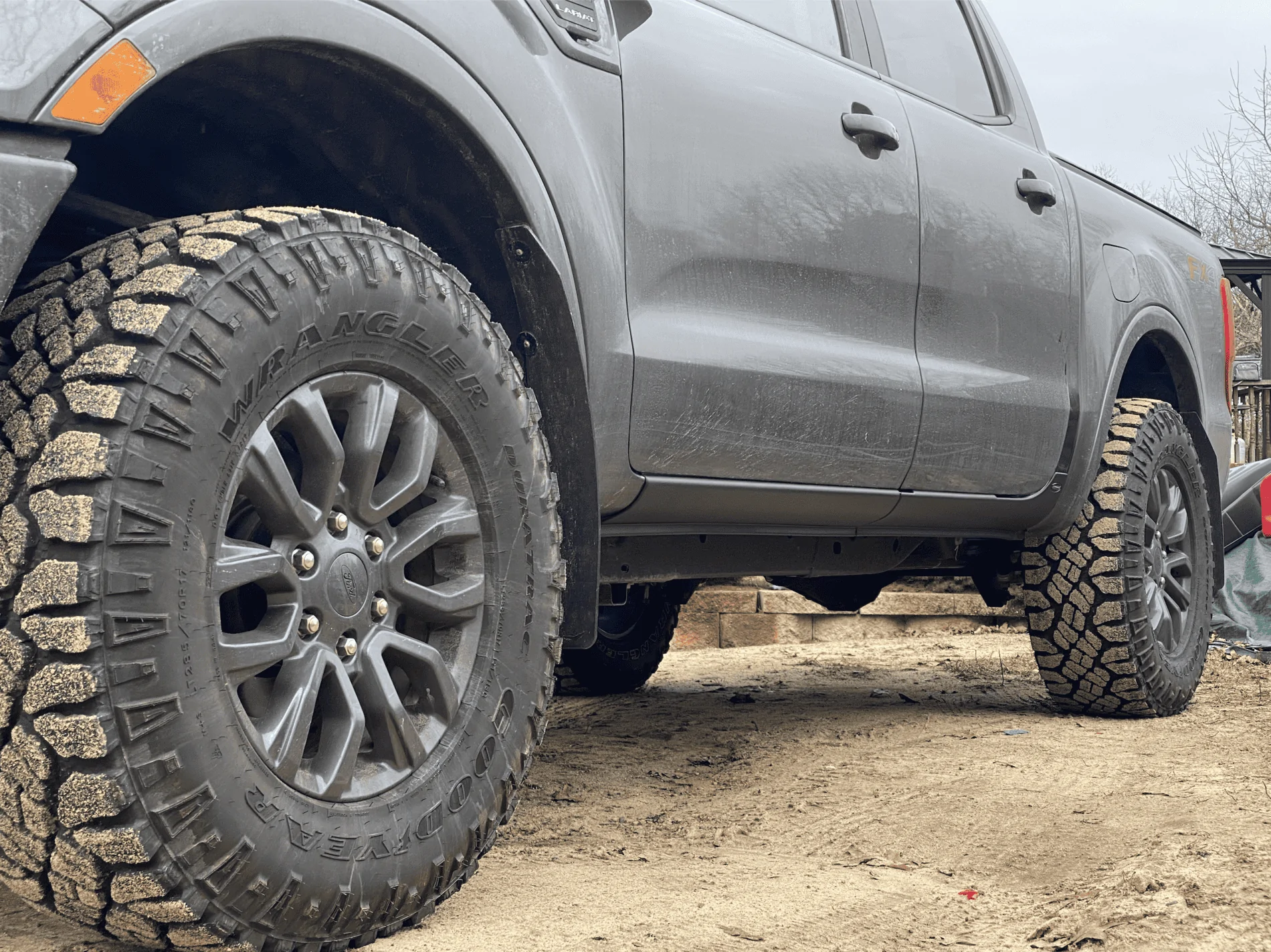

Here are my 285/70R17 tires on stock Sport/FX4 wheels with a 1.5" spacer. They JUST clear the mudflaps, like, they brush them a little full lock turning into a driveway sometimes. If you run a less aggressive offset, you'll be fine. Others seem to have excellent luck with a 1" spacer instead of a 1.5"
These are the RokBlokz XL, by the way.

@Trey1940 thank you, this is exactly what I was looking for. Have you noticed any rock chips down the sides of your Ranger from the tires? Or do you feel that the XL Rokblokz really protect the paint well?
I have one little rock chip on my bed side right behind the cab, but the RokBlokz would have to be touching the ground to keep something from flying all the way back there. They keeps all of the big stuff off the truck, and sand/mud spray doesn’t start until midway down the drivers door.
I also have Bushwacker trail armor rocker panels though, so anything the RokBlokz miss just hits those.
