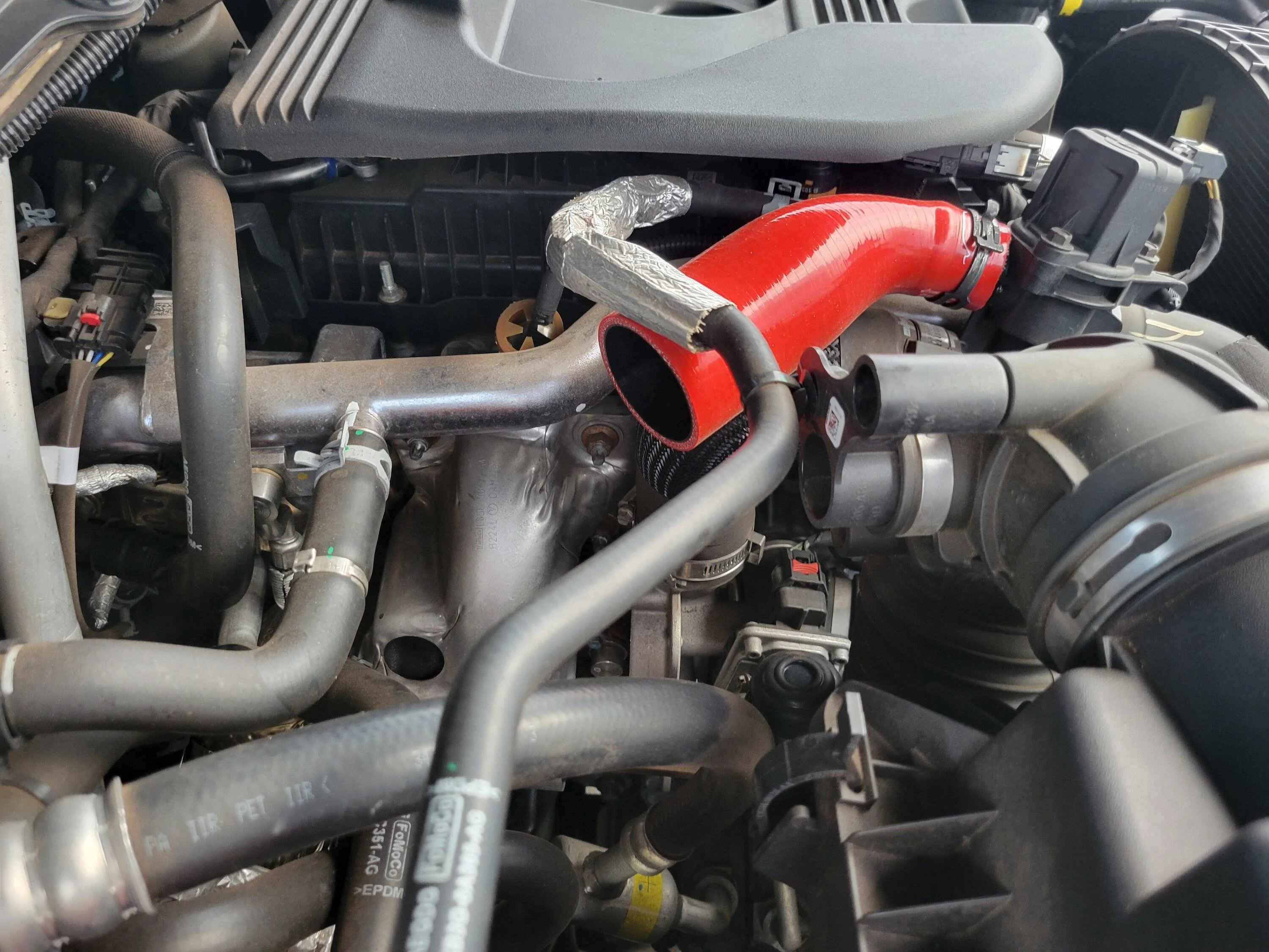

$18 DIY BOV.
1)Remove tour factory hose & clamps
2) Install rubber end cap on intake.
3) Install flared hose on factory BOV and secure with factory clamps.
4) Reflect on the fact that you did not needlessly spend $250 on an aftermarket piece
5) Enjoy Pishshshst! Sound as you back off the throttle around your Colorado and Takoma friends..
