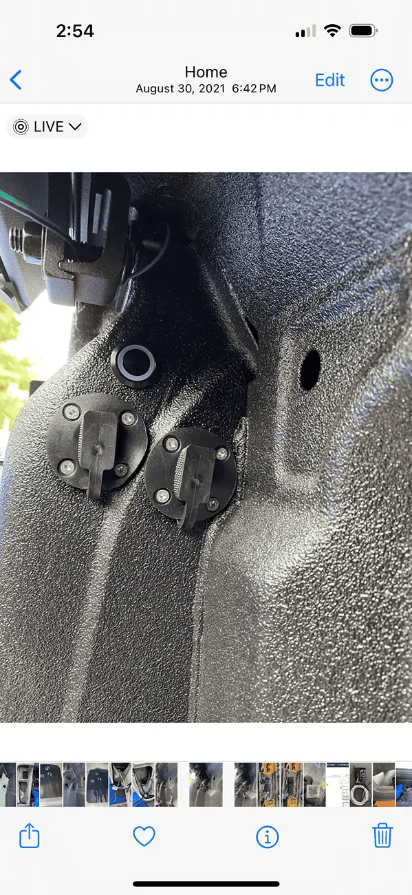

Ditto for me. Quick and easy install, used for my SetPower refrigerator and Jackery battery. The 3D printed socket surround comes with a foam gasket, but is a little loose. I might redesign the rotating clips to take an embedded nut so I can tighten it down more. The price is a little steep for what it is, but you can't beat the ease of installation. I haven't installed bed lights.

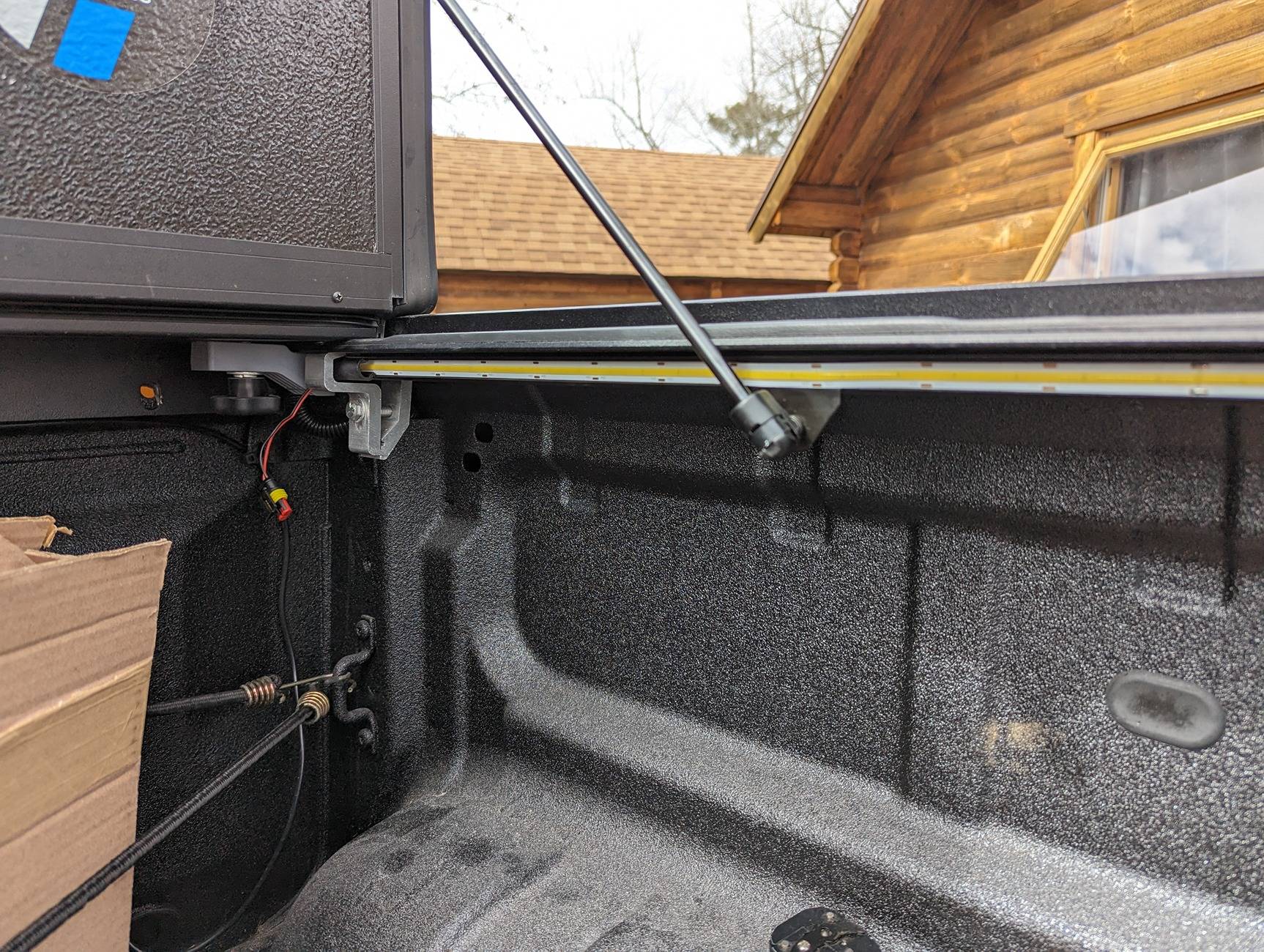

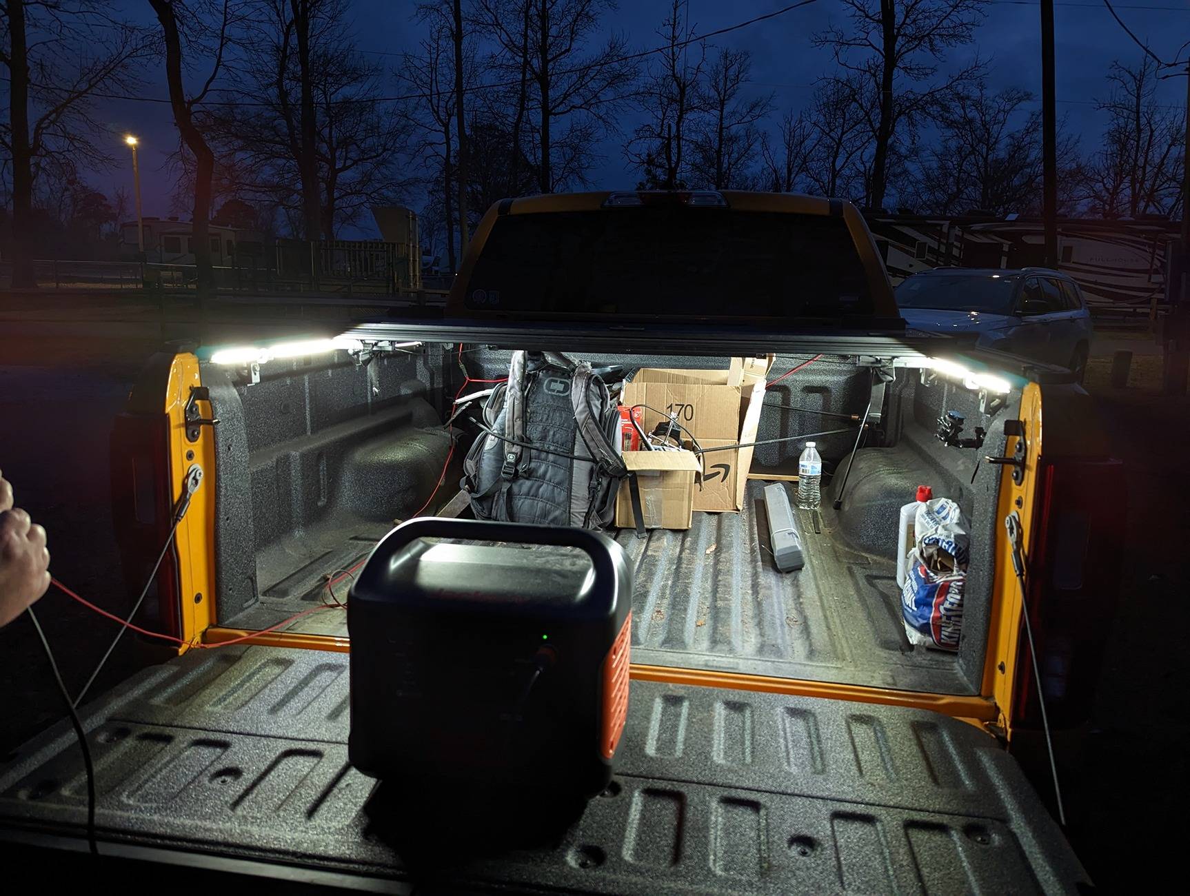

I got some LED stripes I had on my Amazon wish list from my wife. I don't have the link since I don't have an order receipt for them and they were removed from my list when bought, I should have set the has to 1, instead of removing it. In these pictures I was just installing them. You'll notice the plugs at the front of the rails so that If I need to remove the rails I just unplug them and remove them. Also, when I'm "camping under the cover" I can use the Jackery to power them, as seen in the picture while testing them below. Normal use they are tied into the bed light in the HMCL and controlled by the BCM, so they work using OE controls.
