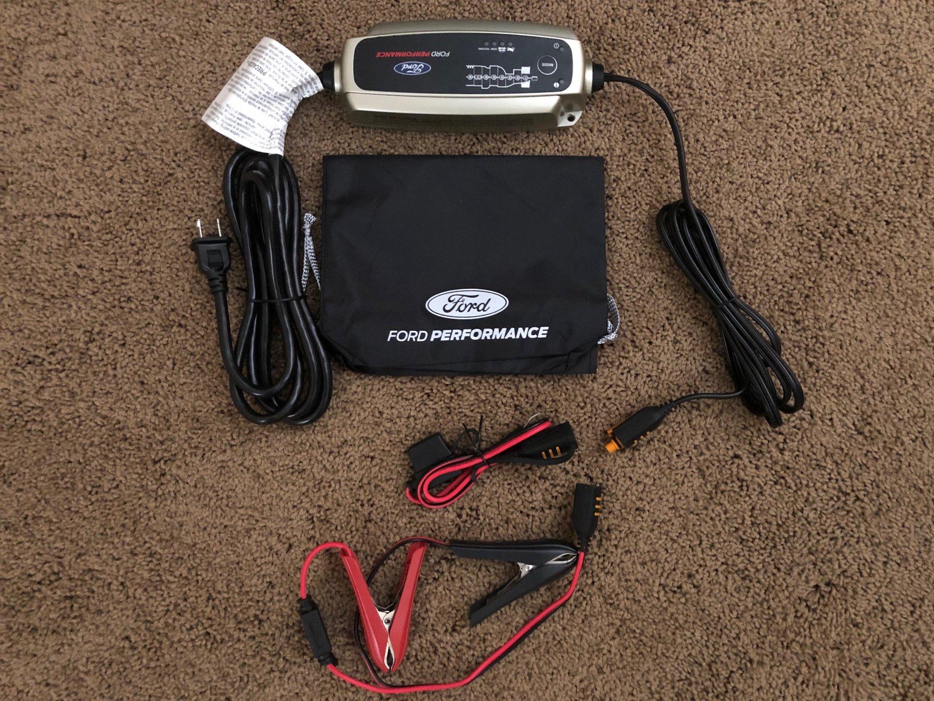

Mine did the same when I was gone at Christmas,emailed me after 14 days almost exactly to the hour I originally parked it. But after reading some of the issues here I bought this Smart battery charger & maintainer with my FordPass points just in case. :)
https://accessories.ford.com/catalo...art-battery-charger-maintainer/category/3115/

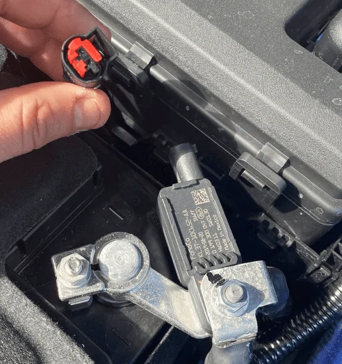

Just disconnect the software extra plug connection at the battery and it will regulate as normal.
Could you give details about the 'software extra plug connection' at the battery? It would be nice if it's as simple as that to set it back to a normal charging system.

Here ya go..... Just this simple.

Interesting. Need more info from peeps more knowledgeable than me :idea:
I'm with you Greg. I'm interested in learning more about this system. I already have 2 vehicles that need a battery maintainer, and I just don't want to be bothered with another. If unpluging the system won't hurt anything down the line that's what I'll do, but I would like to have a little more info. before I do that. Maybe @P. A. Schilke (Phil) can help us out. He's probably forgot more about Fords, and stuff like that than I'll ever know.
