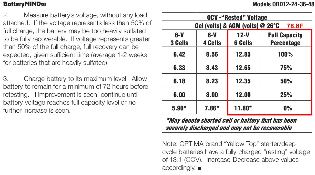

With truck not running and having sat over night voltage should be at a minimum 12.5V.
You can get very good info from an inexpensive tester like this Harbor Freight Viking unit.
Or take it by your local auto parts store and they will generally test it for free.
Or simply charge the battery overnight, and see if it corrects the problem.
The chart below shows the battery charge percentage based upon the voltage of the battery.
Also after you have started the truck measure the battery voltage at idle. Your alternator should raise the battery voltage.
This may be your best bet! (It won't hurt your truck or battery)
As a test you can unplug the BMS sensor located on the negative battery terminal (Do this with the truck off). It is the little cable plugged into the black box on the negative battery post. Squeeze the release tab on the connector and pull. Then start your truck.
This will raise your charge voltage to over 14v when you start the truck. Verify with a voltmeter. Then turn on your headlights and see if they are still dim. If they are, the problem is not due to low voltage and is most likely the Auxito LEDs.
With BMS cable connected voltage will most likely be in a range of 12.5 - 13v. Ford likes the battery to be only 70%-75% charged for gas savings,
With BMS sensor disconnected > 14 - 14.5v. This is the standard charge rate used on older vehicles. If it is higher than 14.5 your battery is in a weakened state of charge.
