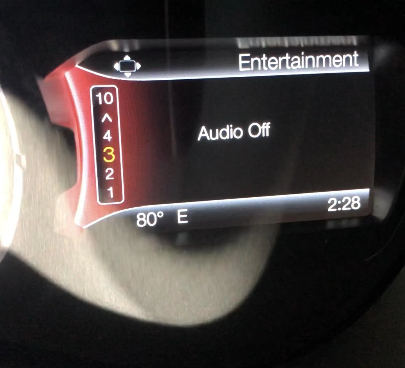

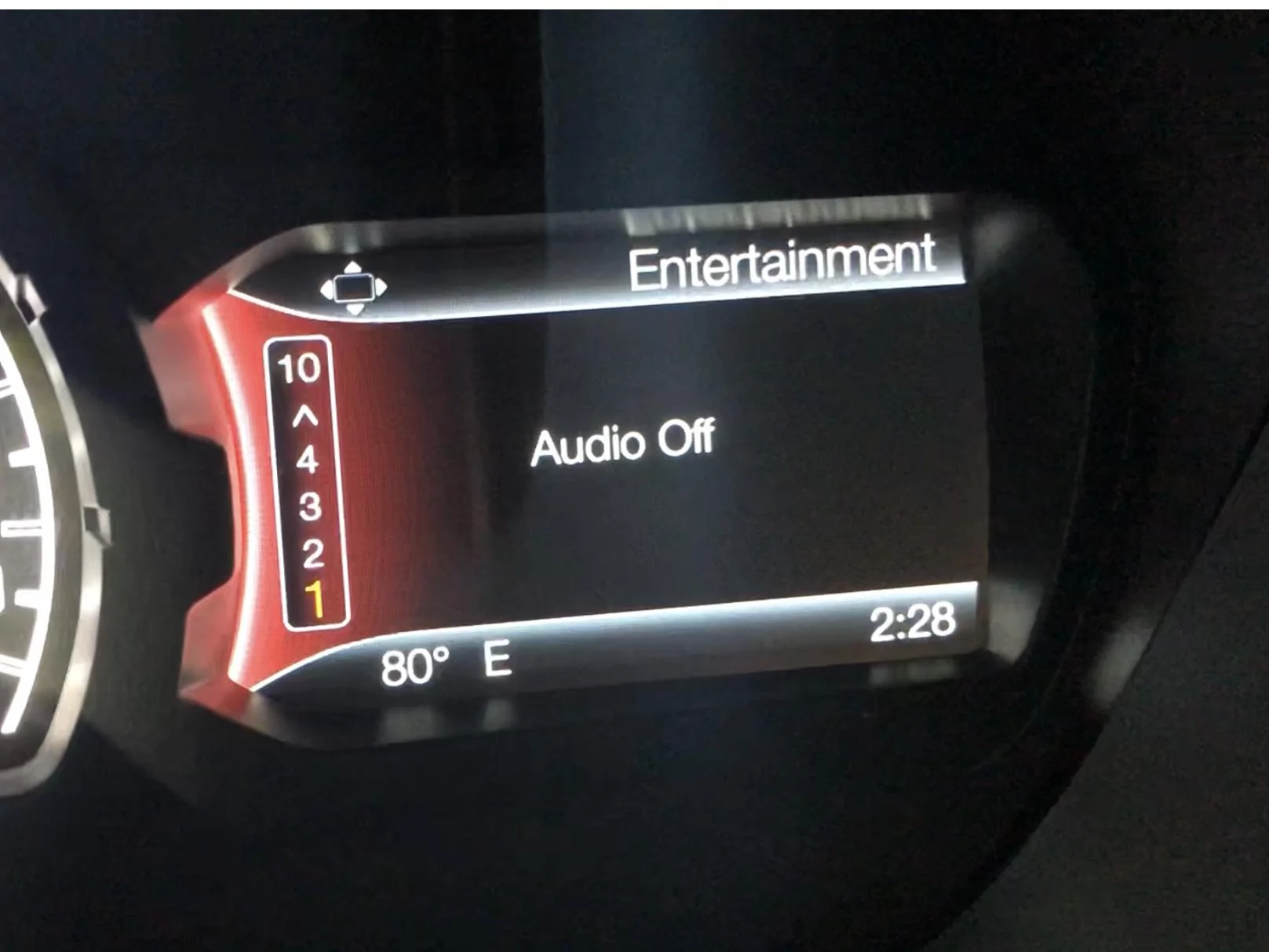

So I’ve noticed according to my indicator the transmission doesn’t seem to ever Shift in/out of 2nd gear. It goes from 1 to 3 and so on. Then 3 to 1 when stopping.
I’ve tried various stop and start speeds and I have yet to see “2“ light up. Curious if anyone else has the same experience.
BTW...I have just over 500 miles on my new truck.

This is a common and normal occurrence. No worries. If you use Sport mode or Tow/Haul mode, it'll go through 2nd gear.
OK...a bit strange but thanks!

Yeah, but this doesn’t race up to a higher gear & shift. No matter how slow I drive from 0mph to 10, 20 or 30 it skips 2nd then shifts 3-10 gears normally. ??‍♂

Discussed a bazilion times on here. Unless you’re towing or running hard in sport mode, the truck will skip a few gears on the way up. A tune can eliminate this if you choose.
