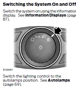

If I start my truck and ride down the road at night the auto high beams come on at 32mph and off at 27 mph as they are supposed to. However, if at any time while driving I either flash my high beams or manually operate them, the auto high beams no longer function as they are suppose to. Any idea what is going on?

By manually operating them you just turned off the automatic highbeam function of your headlights. To get it back, turn your headlight switch to the on position and back to the auto position and they will work again.

Sometimes you can have the knob on automatic but the little A needs to be on the dash indicating that the high beams are automatic. As you manually turn the high beams on and off the little A will come on the screen one time and come off the next. So if you manually turn them on and you want them to still be automatic make sure the little A is on the dash..

That is because you manually turn them on by pulling the lever toward you. Or you can manually turn on the high beams by pushing the lever the opposite way and let go and the high beams stay on until you manually push the lever again. The way you are doing it doesn't turn on or off the automatic high beams which is what I was saying is indicated by the green A on the dash. Basically you can push or pull the lever to turn on your high beams.
Pulling it, you have to hold it to keep the lights on and will not deactivate your automatic high beams, however pushing the lever away from you and letting go of the lever it will turn on the high beams but now the automatic-ness of the high beams is off and there is no more green "A" on the dash. Push the lever 2 more times and it's automatic again. You don't have to worry about activating/deactivating the automatic-ness if you are only pulling the lever to use the high beams.
