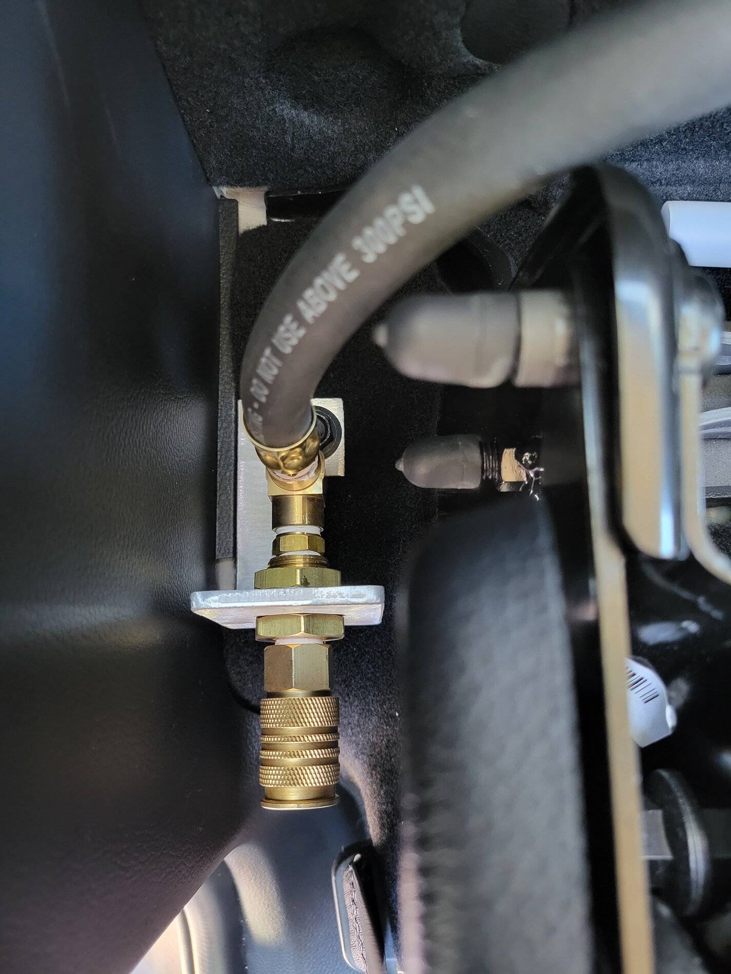

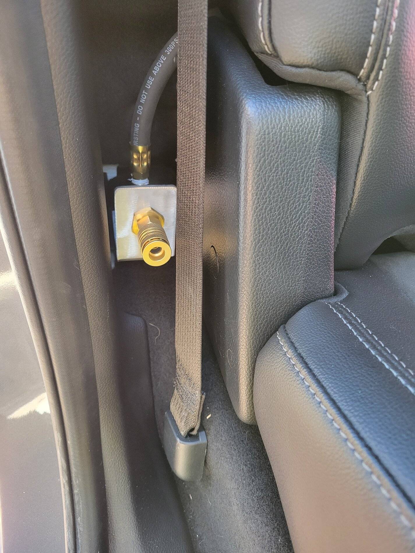

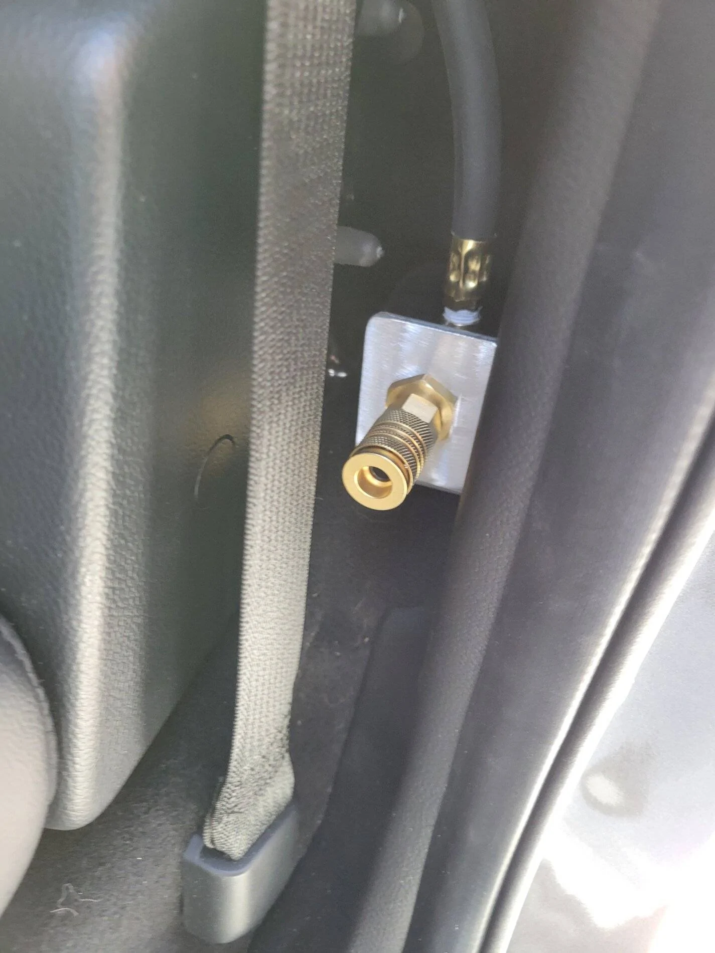

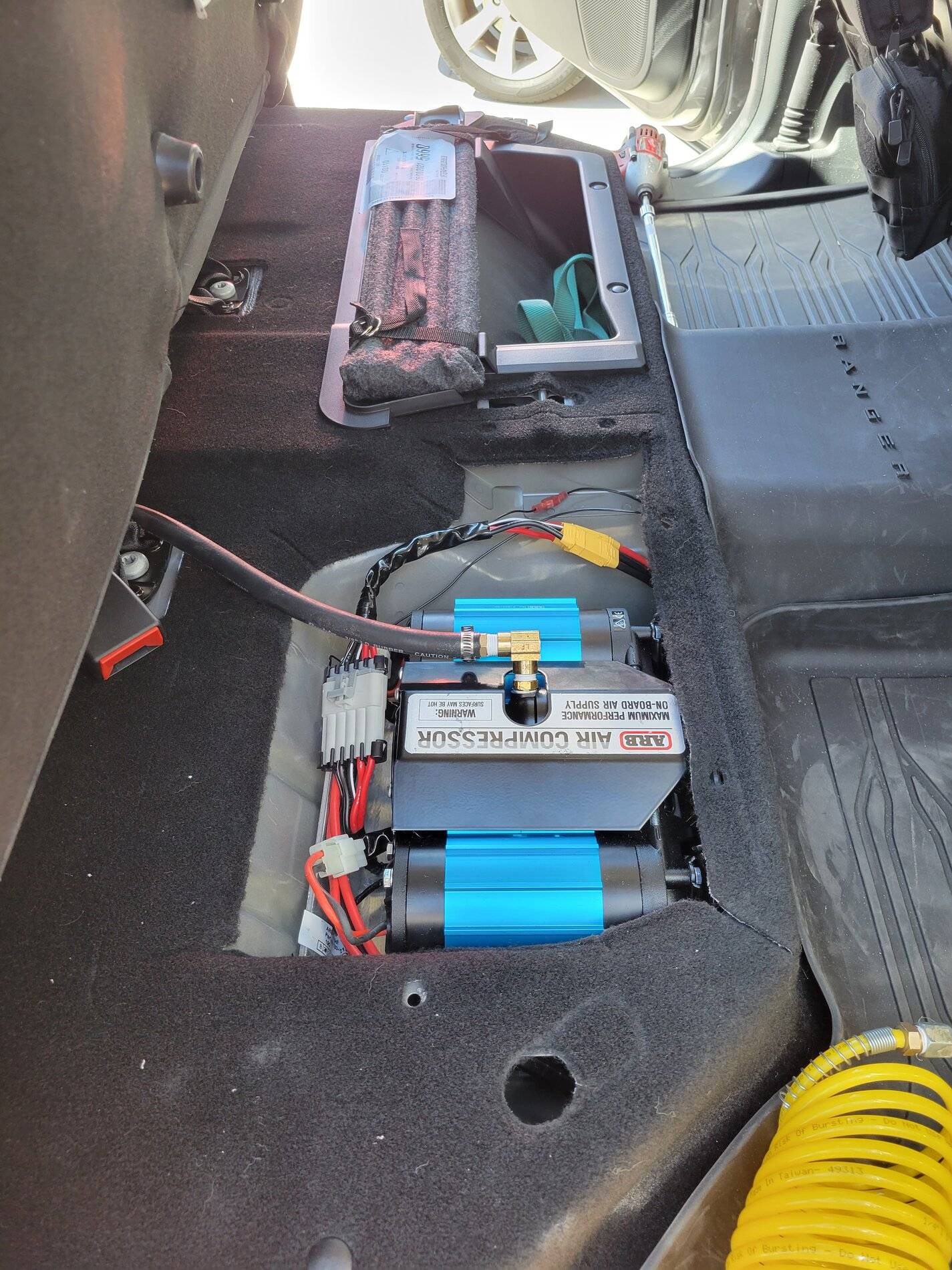

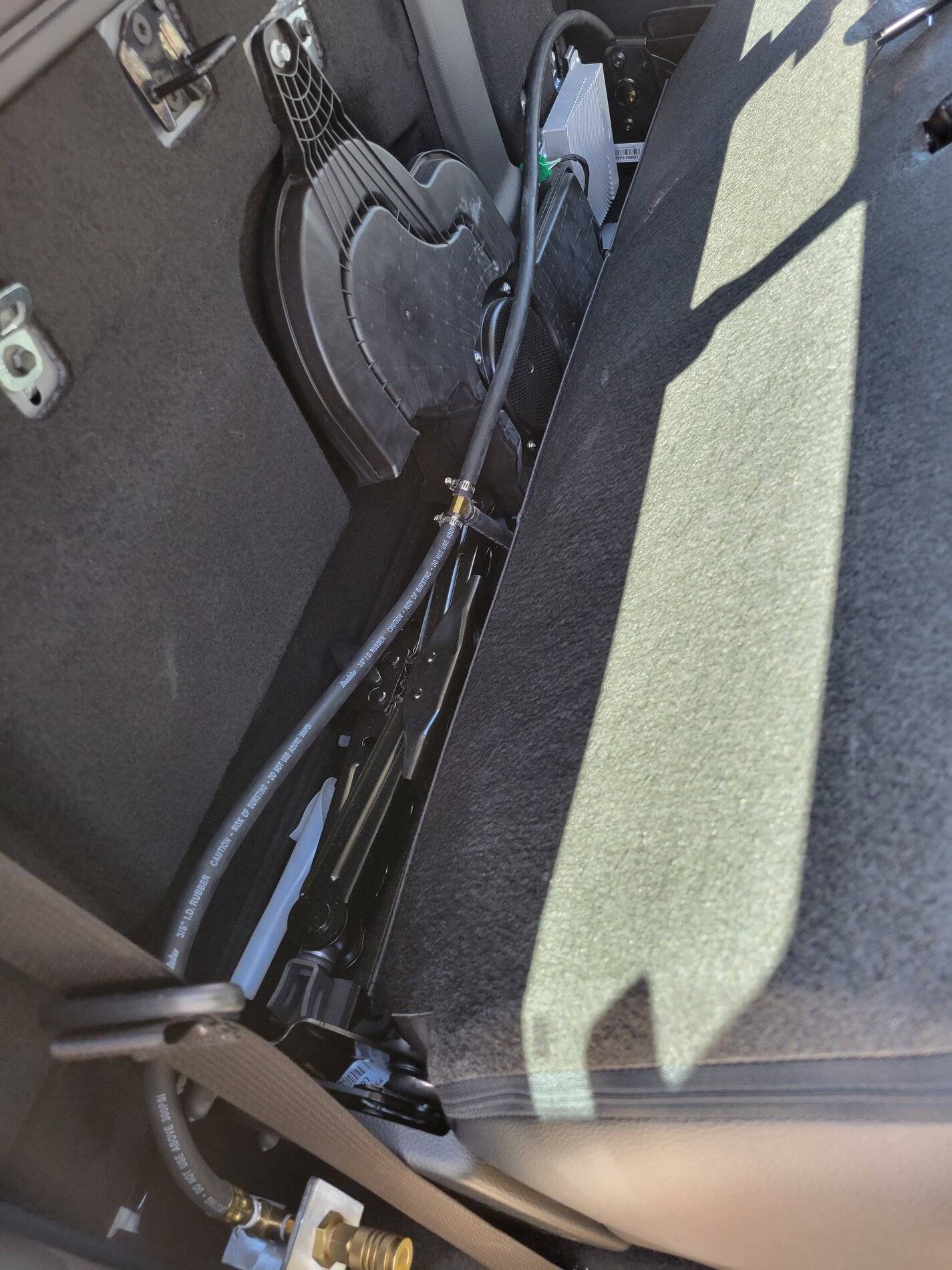

Built a twin ARB system. Went with the twin so if I expand with a tank it's good to go. Decided to tuck it under the back seat. I wanted it hidden, not in the bed because I'm running a decked system and felt under the bed was ripe for a thief. Made all my own brackets and plumbed in a quick disco tucked by the seat belt on both sides. Wired it all up so it flips on using my upfitter switch 6 (tremor).

Super clean install. What did you use to mount your L-brackets for the quick disconnects on the driver and passenger side?

Bracket is 3/16 aluminum plate I had laying around. 3/4" bulkhead fitting with 1/4 npt internal thread to attach the quick disco and hose. Then I used the seat bolt to the chassis to mount it to the truck.

Right on. Excellent utilization of the existing mounting hole for the seatbelt. Super super clean.
