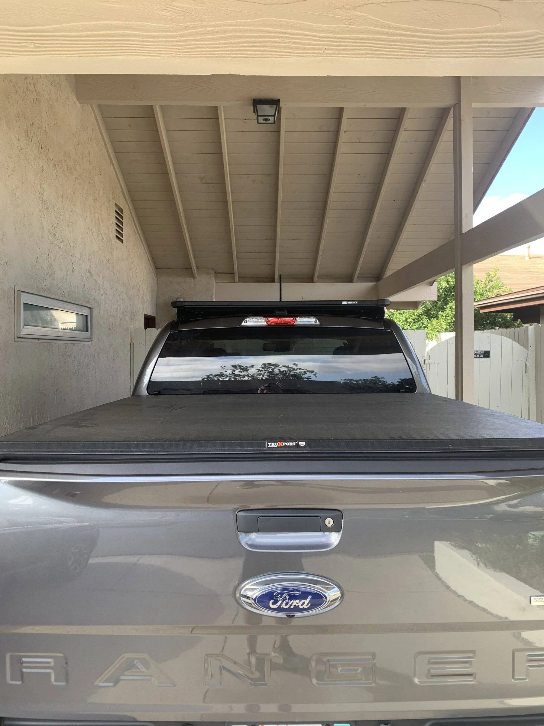

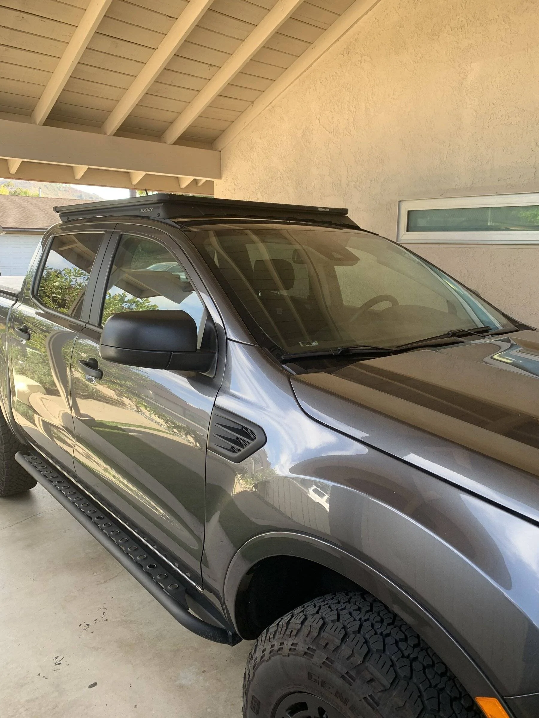

I did do it myself and gave myself a full day to do it as there’s definitely some tricky parts to installing it.
The biggest of which is drilling the holes into the roof (similar process to what Stage 3 show when they did the install video for the rhino rack I think) but you insert rivnuts which the feet of the base ultimately screw into. The other thing that’s more so for your own peace of mind is vacuuming the metal shavings out while you’re also drilling the holes. ARB recommend dropping the whole headliner but I just removed some stuff so I could stick my hands up into it and make sure I was clear of any airbags. Sounds scarier than it is and the vacuum nozzle is great for moving those out the way while you drill.
After that - it’s all pretty smooth sailing for the rest of the install and the build quality of anything ARB is top notch!

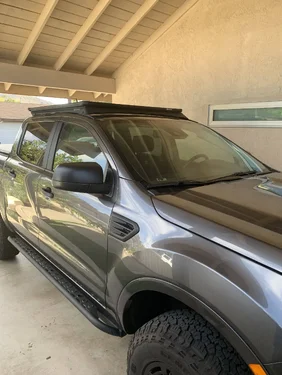

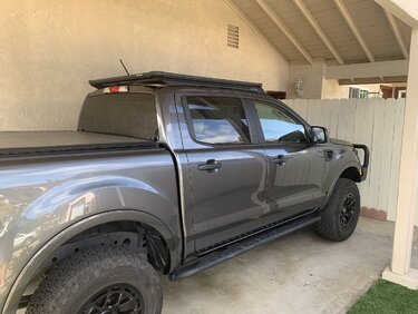

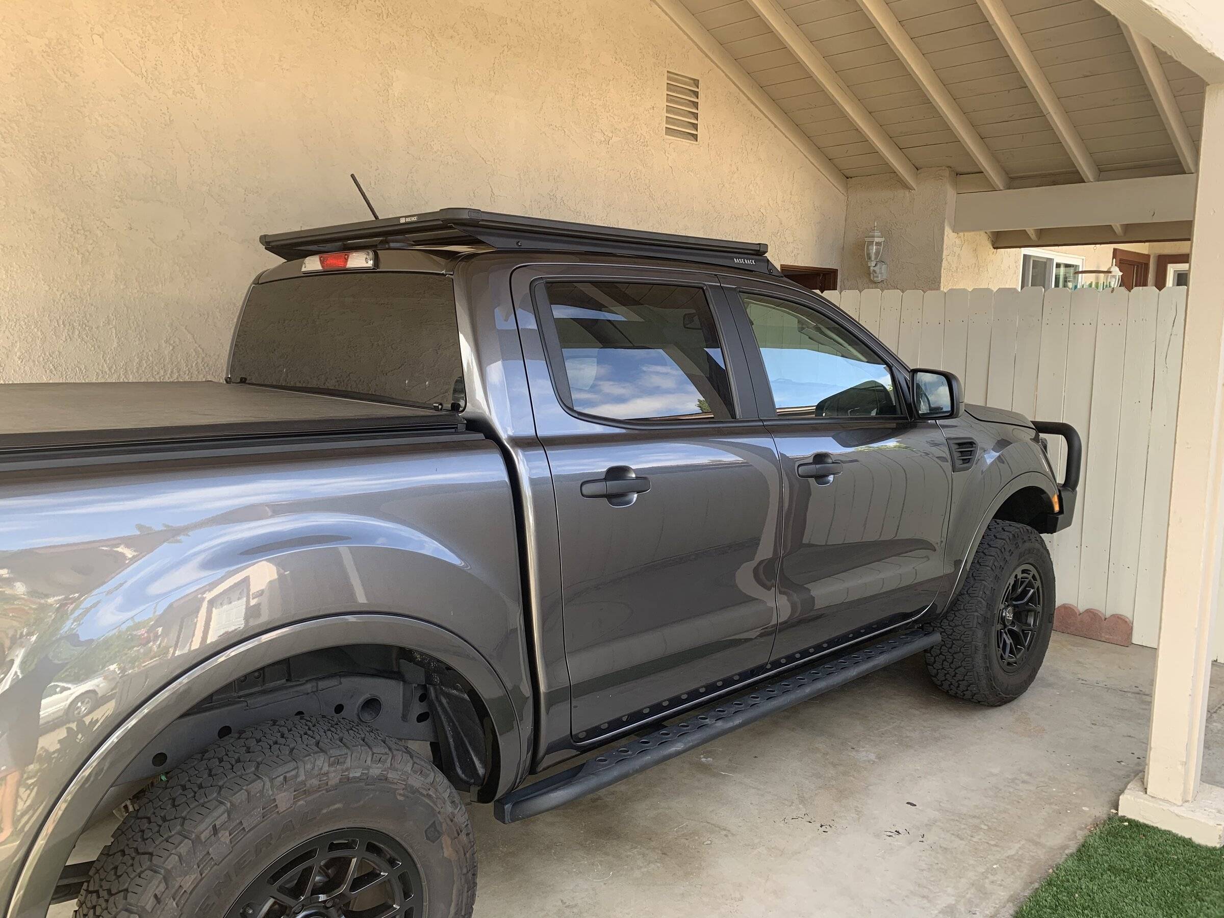

@CC_The_Aussie that looks great.
I have a feeling I probably won't do the install myself. I'm sure I have the skills to do it, but it makes me nervous as hell to drill holes in the roof.
There's a really good offroad shop near me who happens to be an ARB dealer, so that's probably the route I'll go. They occasionally offer coupons that are valid on ARB stuff.
That's pretty much the one I want for my Ranger. Didn't want all the extra rails - just the platform.

Thanks! I’m really pleased with how it turned out and can’t wait to put the awning on it once the quick release bracket arrives.
Not going to lie - having to drill holes in the roof was intense but ARB gave pretty good info in the instructions about a specific type of step drill to use to minimise any issues. That said if you’ve got a shop that is a dealer for them - that’s a great option!
