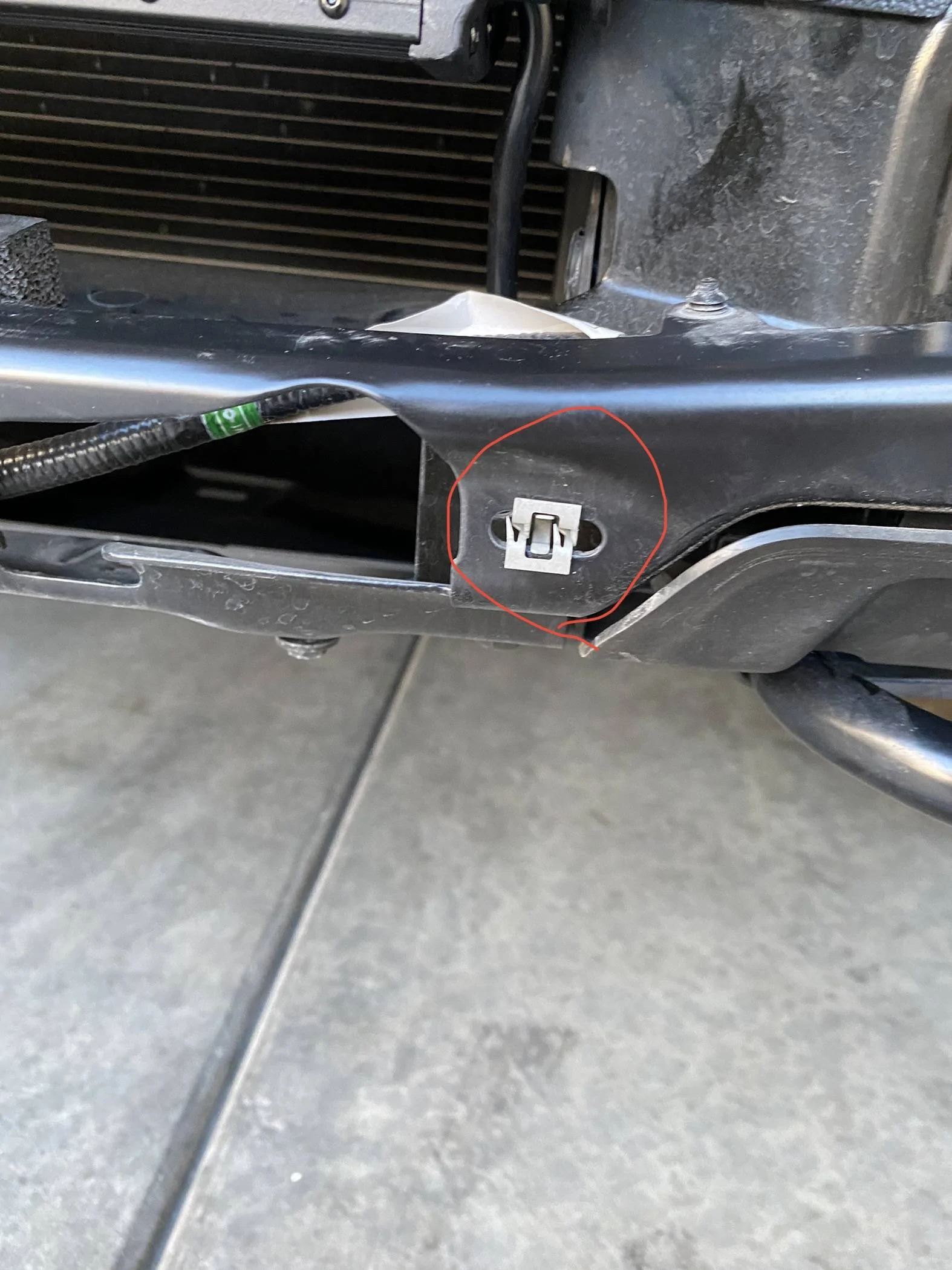

Was installing new light bar, removed the trim and the clips practically destroyed themselves. Want new clips to make sure it holds. Also, is it better to put the clips on the trim first then install or put the clips on the truck and install trim? Thank you.

I know I had to rework mine before I could put it back together. And yes, put the clips on the piece, then put the piece to the truck.

Mine were bent so bad. I tried reworking mine and most broke. I rather just buy new ones and do it right. Thank you

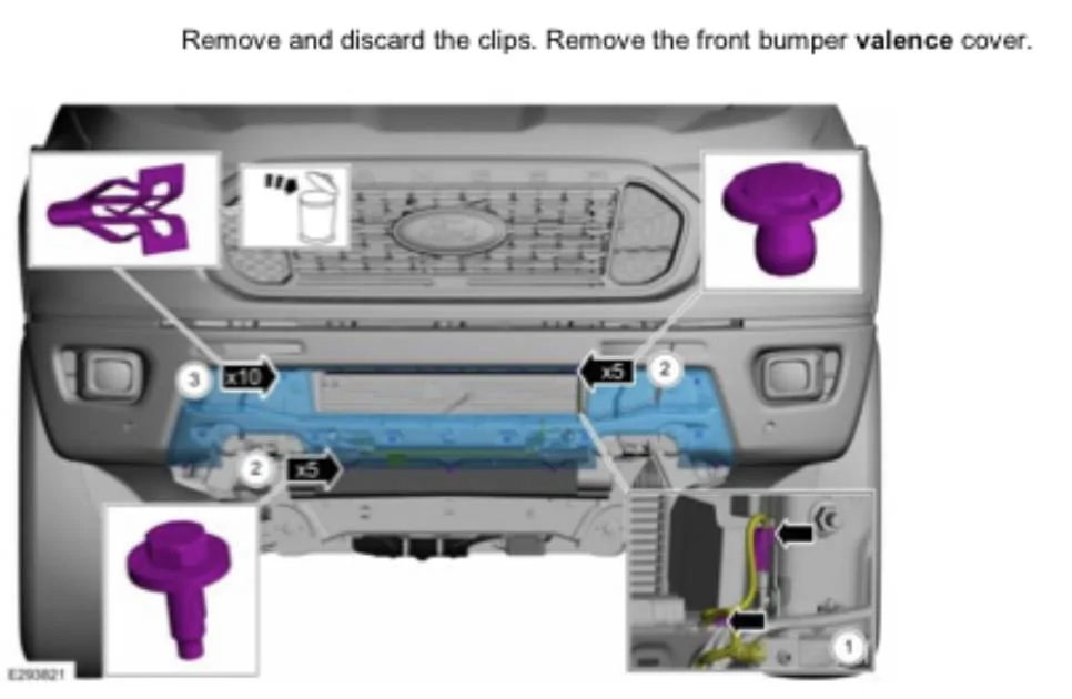

I don’t know the part number but these are typically one-time use parts - Ford says to toss them.
