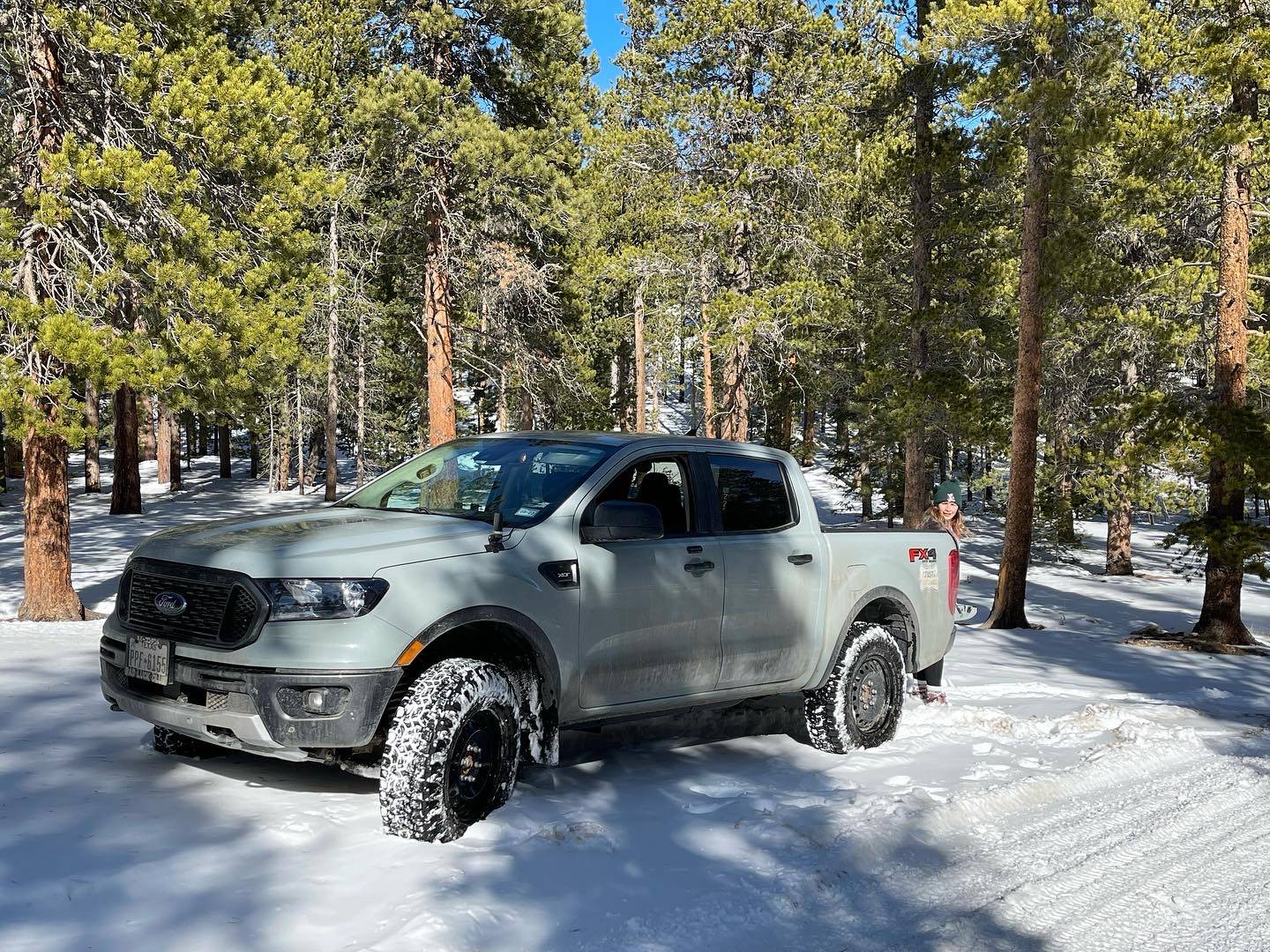

I believe @Nopalito has them on his Ranger, though they are 255/80r17 (quite a bit taller). I have 265/70r17 BRG KO2s in load range C.
I get 20 mpg, which was down from 23-24. Though I also lifted the front 2.5''.
Picture for reference on size.

Great looking truck!

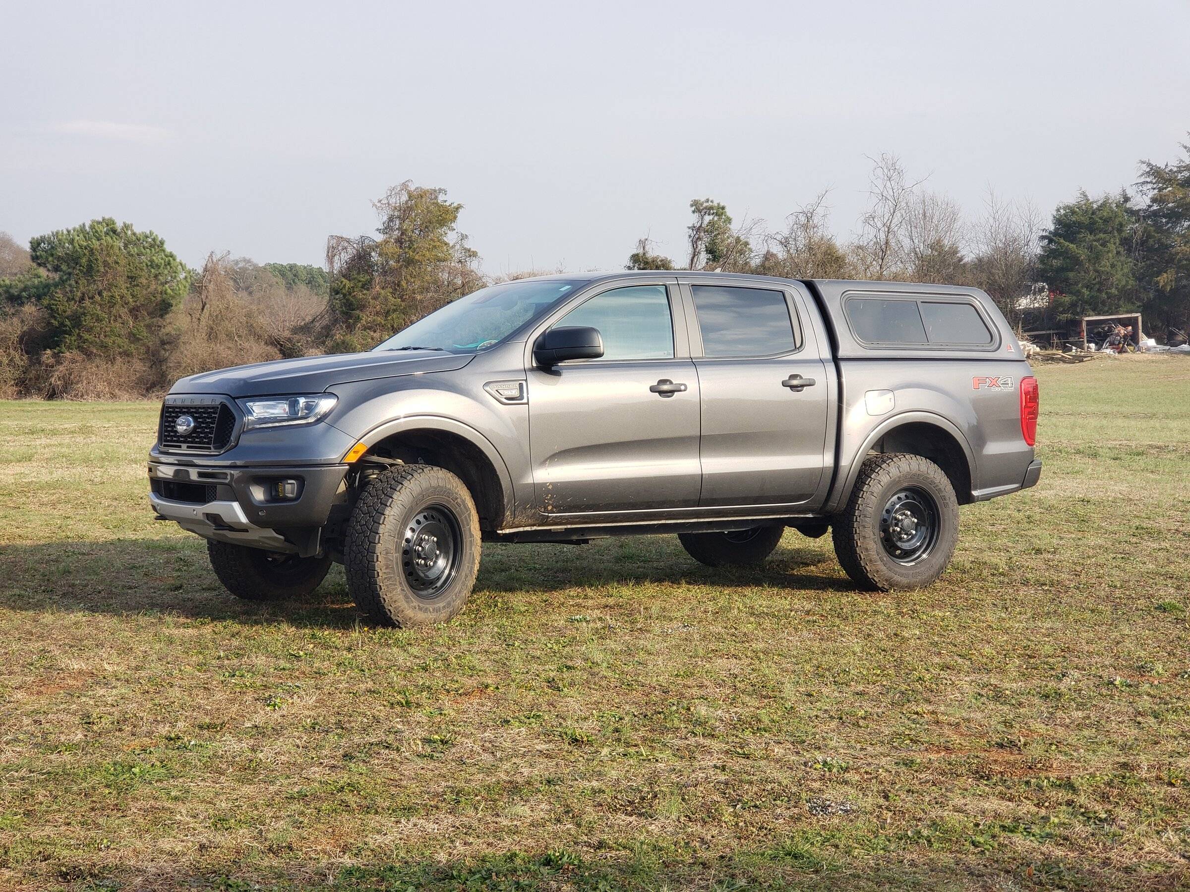

I have them - had them several months now and love them. Great in the mud and snow and pretty quiet on the highway. The only negative is it does give a hit to your MPG - I lost 1-2 MPG with them. Far superior to the Hankooks, IMO.

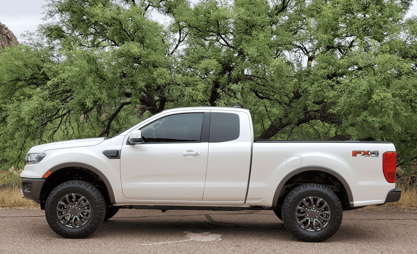

Had my dealer install prior to delivery in 7/2020, Toyo Open Country AT3 LT265/70R17 together with the Ford Performance Tuned Fox 2.0 Level kit.
Firm controlled ride. Great on and off road. After rugged rock roads, not a scratch on the sidewalls and very few stuck stones. Road trips average 22-25MPG. Yes, heavier... and a little more "clunk" with potholes. If I didn't drive rocky roads, I would not have bought LT's. After a few thousand miles, there is slightly more tread whine. Previous AT tires from other brands did the same.
I bought a fifth matching tire and OEM wheel to have a proper spare.
Couldn't be happier.

Yay SCab !!

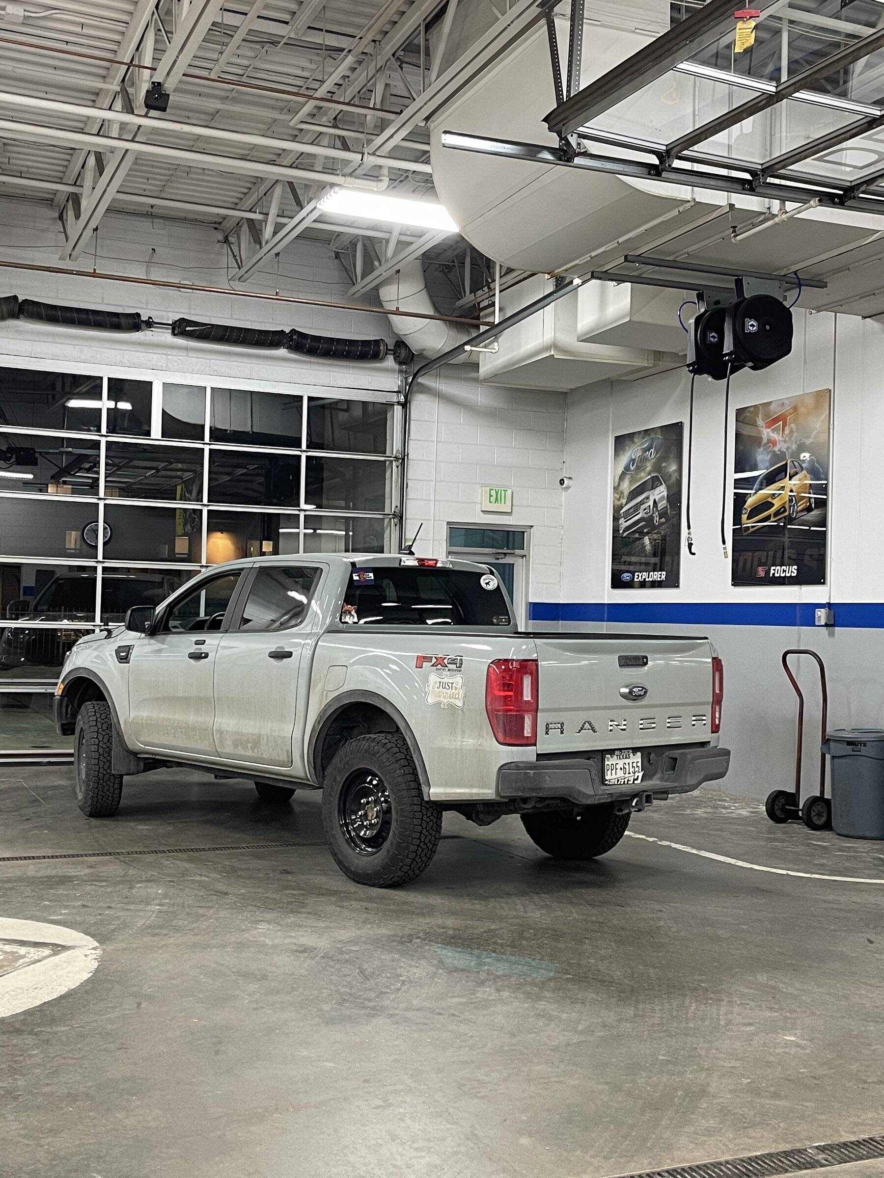

I have 255/80/17s Toyo AT3s E rated. Absolutely love them. Kick ass in snow & rocks and very comfy on the highway.
Sa.e size on factory Magneti. Wheels.
Love 'em.

Looks great, glad to here they are good tires!

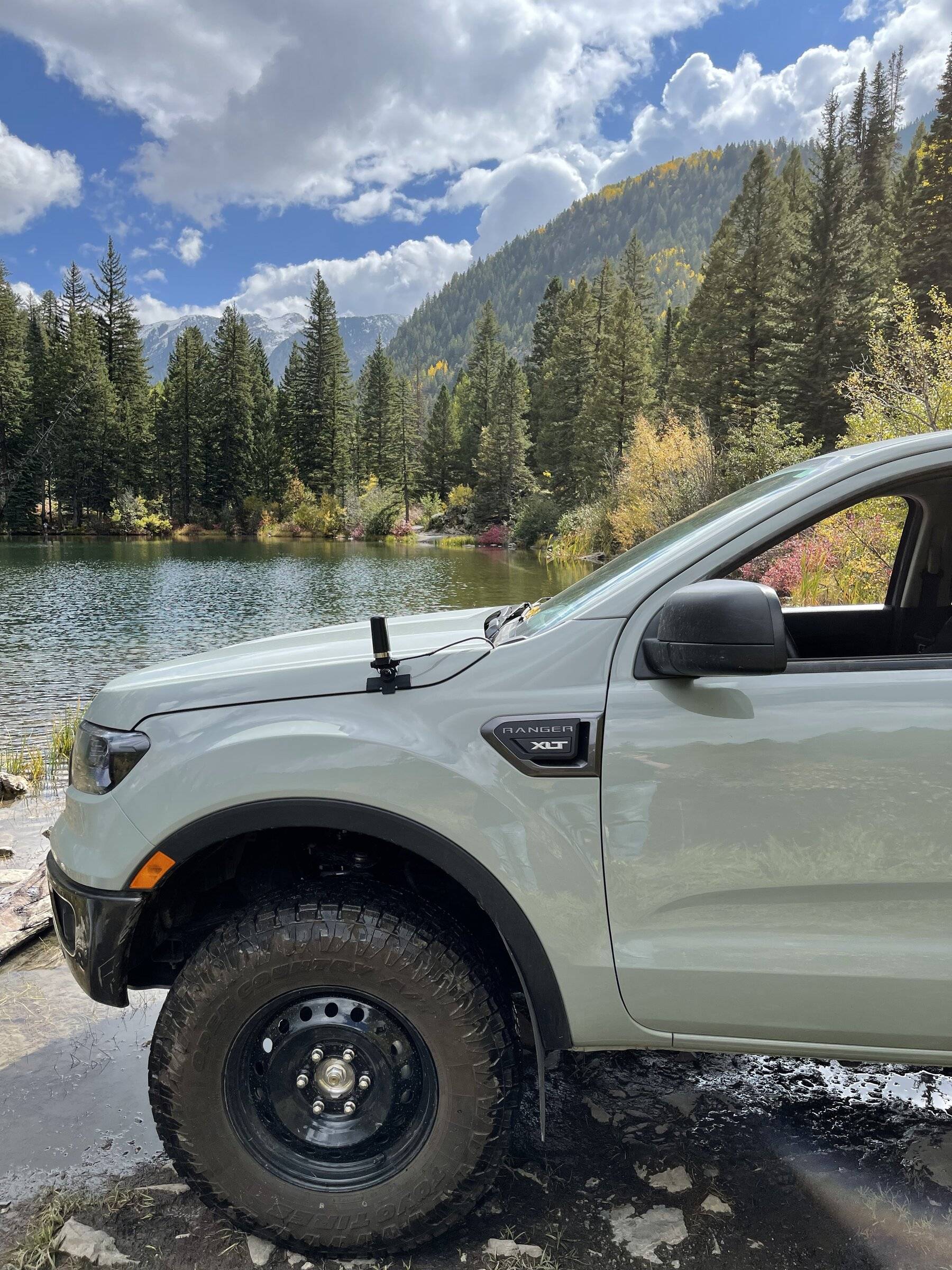

I've been running 255/80/17s on whats now commonly known as the bronco black diamond wheels. No issues other than a tendency for the rear to get light in very wet conditions while trying to corner fast. So no real issues haha!

Twins

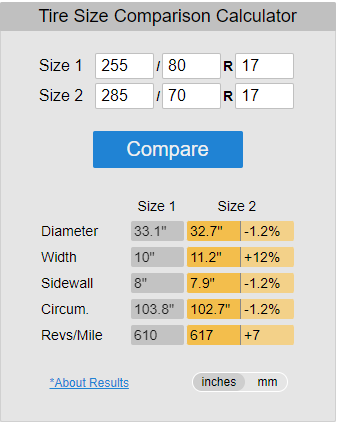

When my tremor grabbers get some age, I’ll do a change too. Debating between the 255/80 size or 285/70 size.

I had pizza cutters on my last two Jeeps to keep the tires under the fender flares. From what I can tell, the Tremor can get away with the 285/70 tire and still be under the tremor flare.
