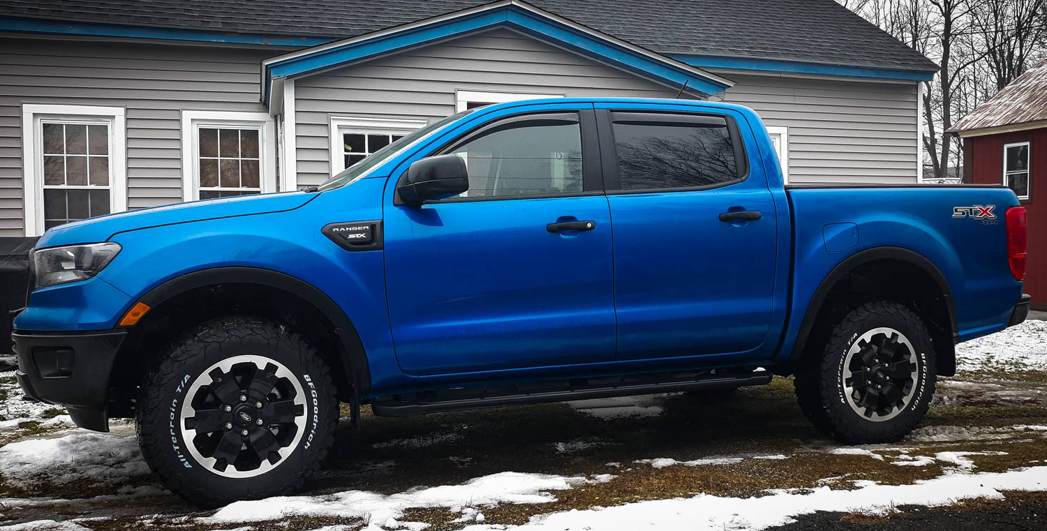

I've got 265/65R18 BFG KO2s on stock suspension, no problems.

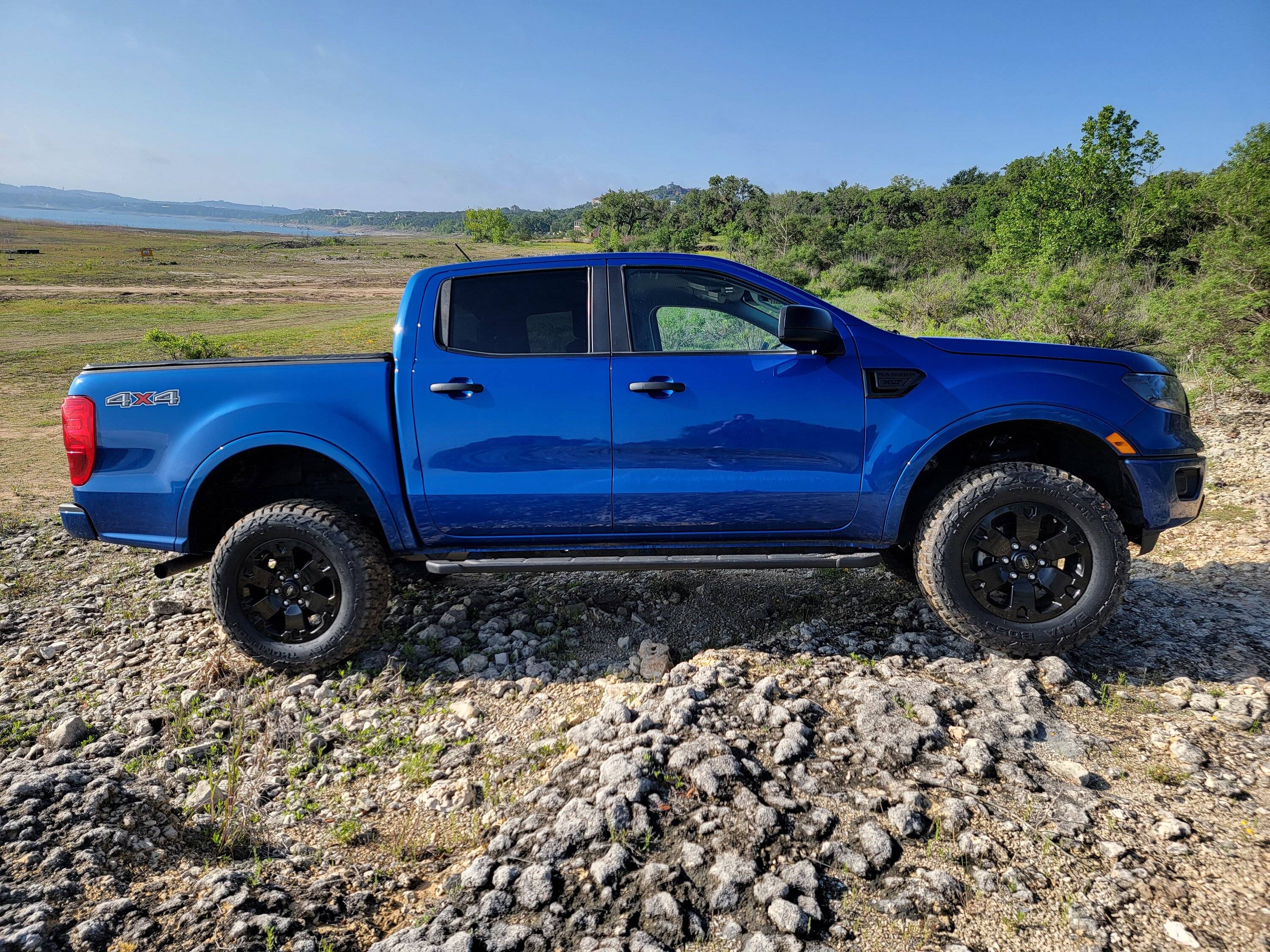

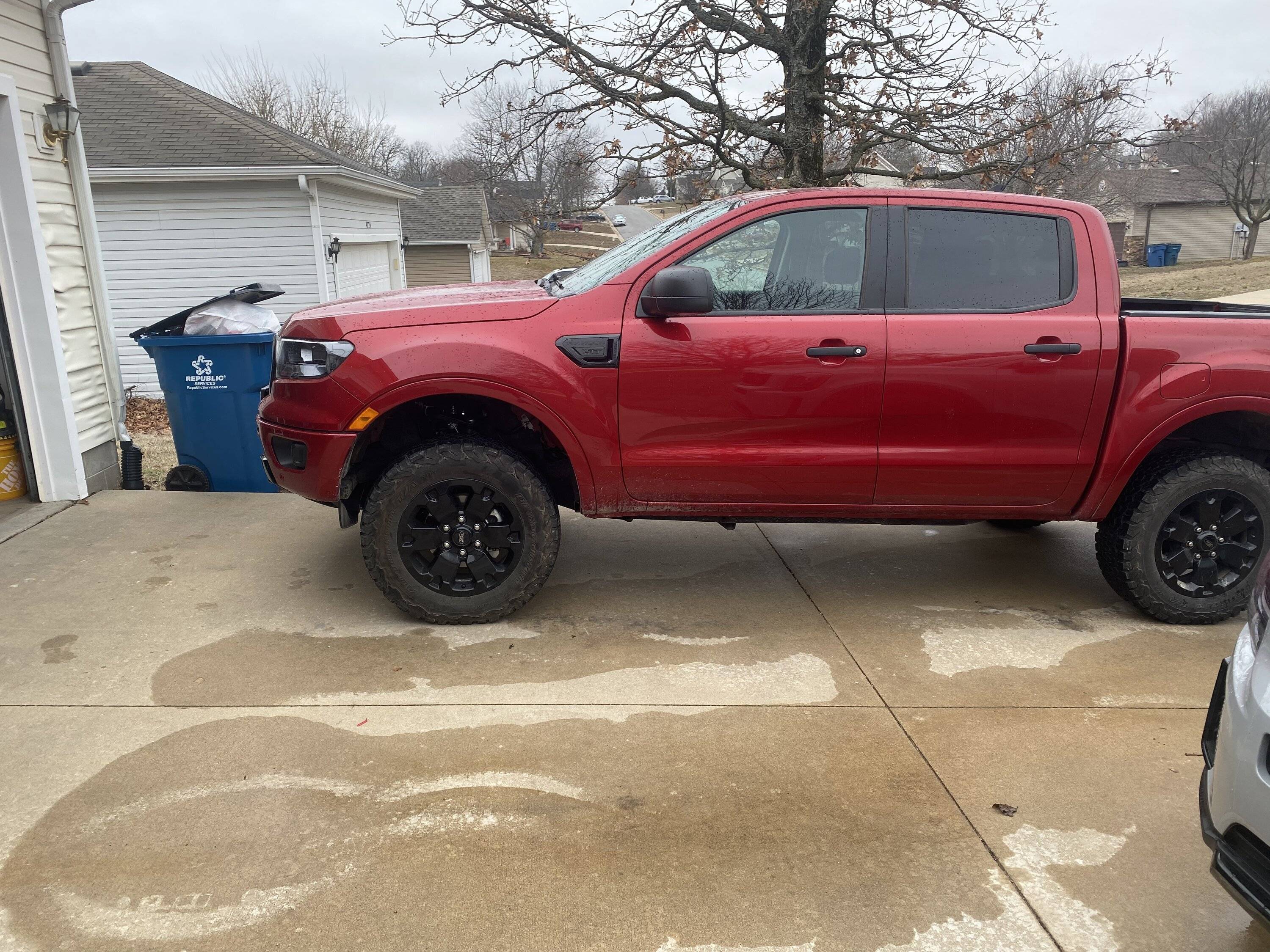

265 65 r18 on factory black appearance pkg wheels. Bfg ko2s
Pick at the pass is stock sus, garbage cans background is after fox 2.0 set at 2”.
Never rubbed on either set up.

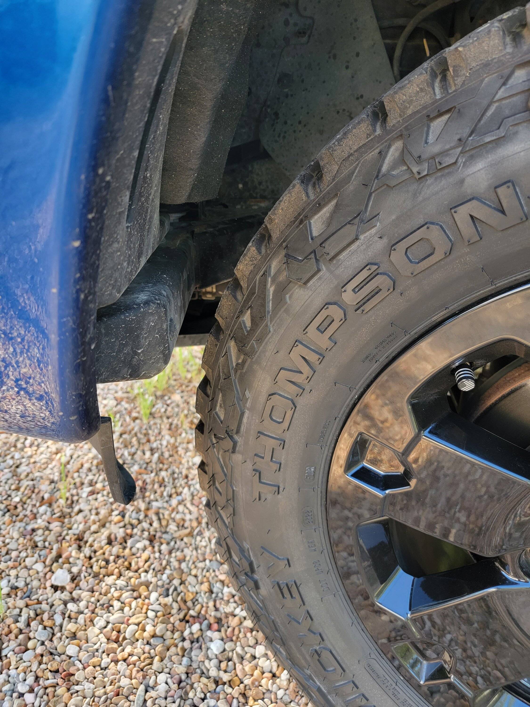

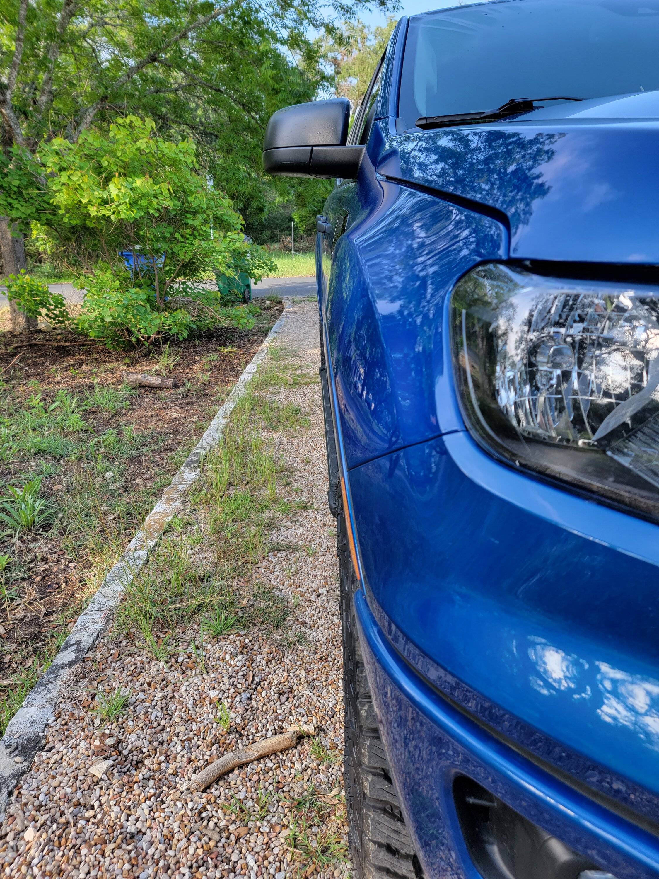

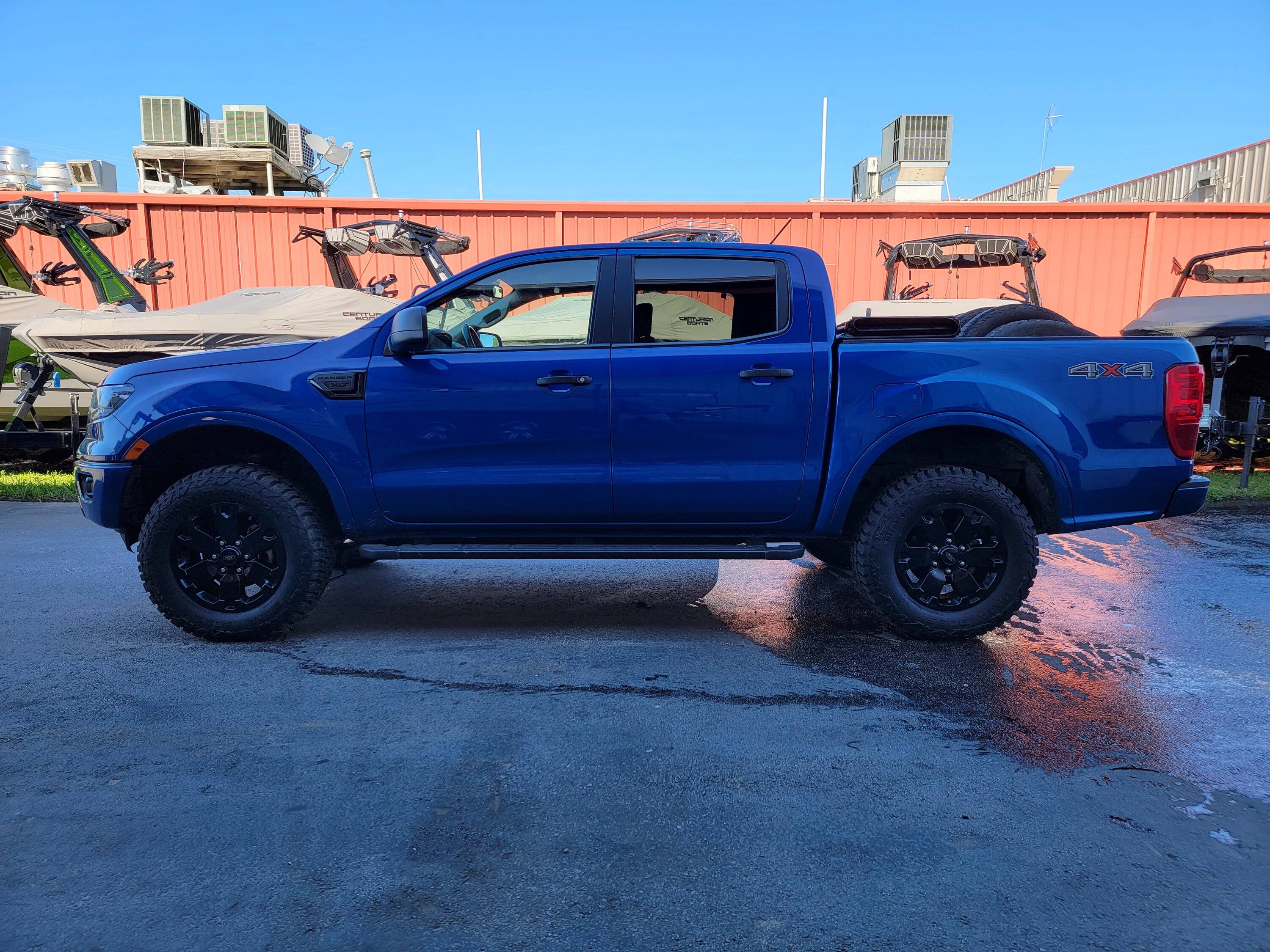

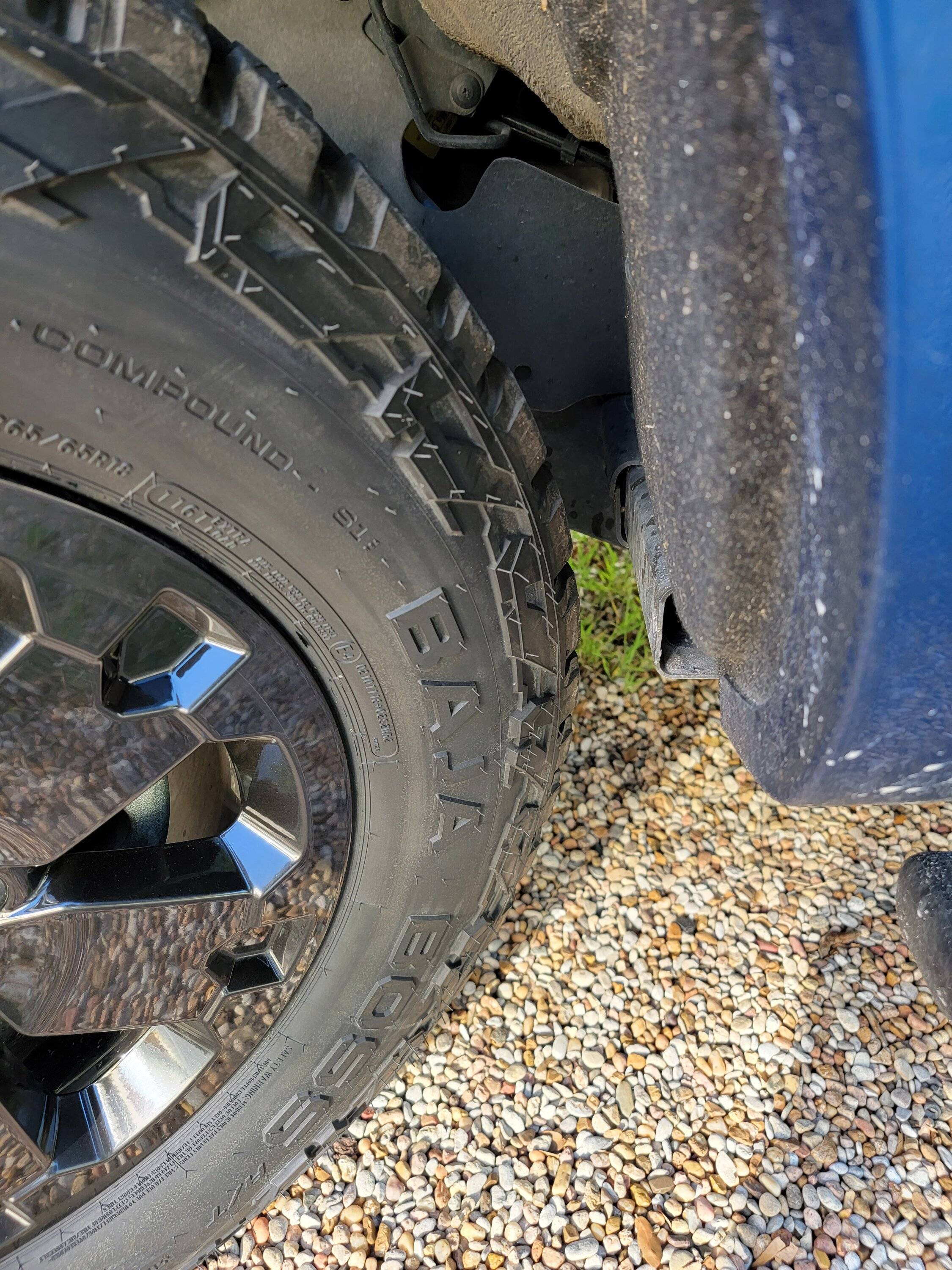

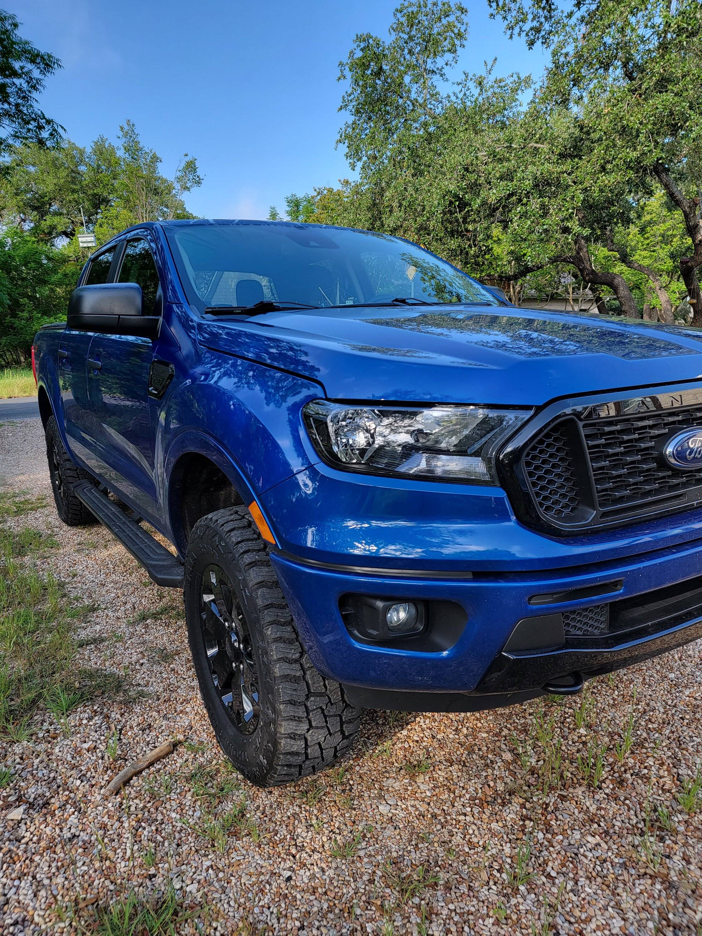

I'm running 265 65/r18 Mickey Thompson Baja Boss A/T's on a 2.5' Rough Country Level with 0 issues and plenty of space. I'd imagine the 2' lift would be more than enough as well. I've put it through the ringer trying to get it to rub and it has so far passed all my tests at full lock.
One thing I'll say, going up a tire size with heavier tires - you feel it. There's an ever so slight hit on acceleration and 1-2 MPG. The Ford Performance Tune is something I'm interested in now. These Mickey's weigh 46lbs each. The stock 265/60s weighed 39lbs each. The lightest weight 265 65/r18 tire I found was the Toyo AT3 at 41lbs - I almost went with those but really liked the aggressiveness of the Mickey's and have read great reviews on them. The KO2's were originally what I wanted until I saw those were 51lbs each.
The pictures don't do justice on how good and proportionate it looks. Going to 265 70/r18 may require some additional modifications if you're truly off-roading. I think the 265 65/r18 is the optimal size for the Ranger with a level only. I'm super happy with it.
Hope you find what you're looking for.
